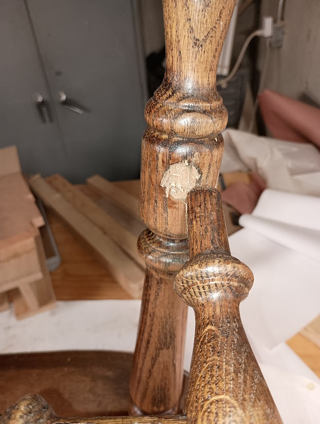

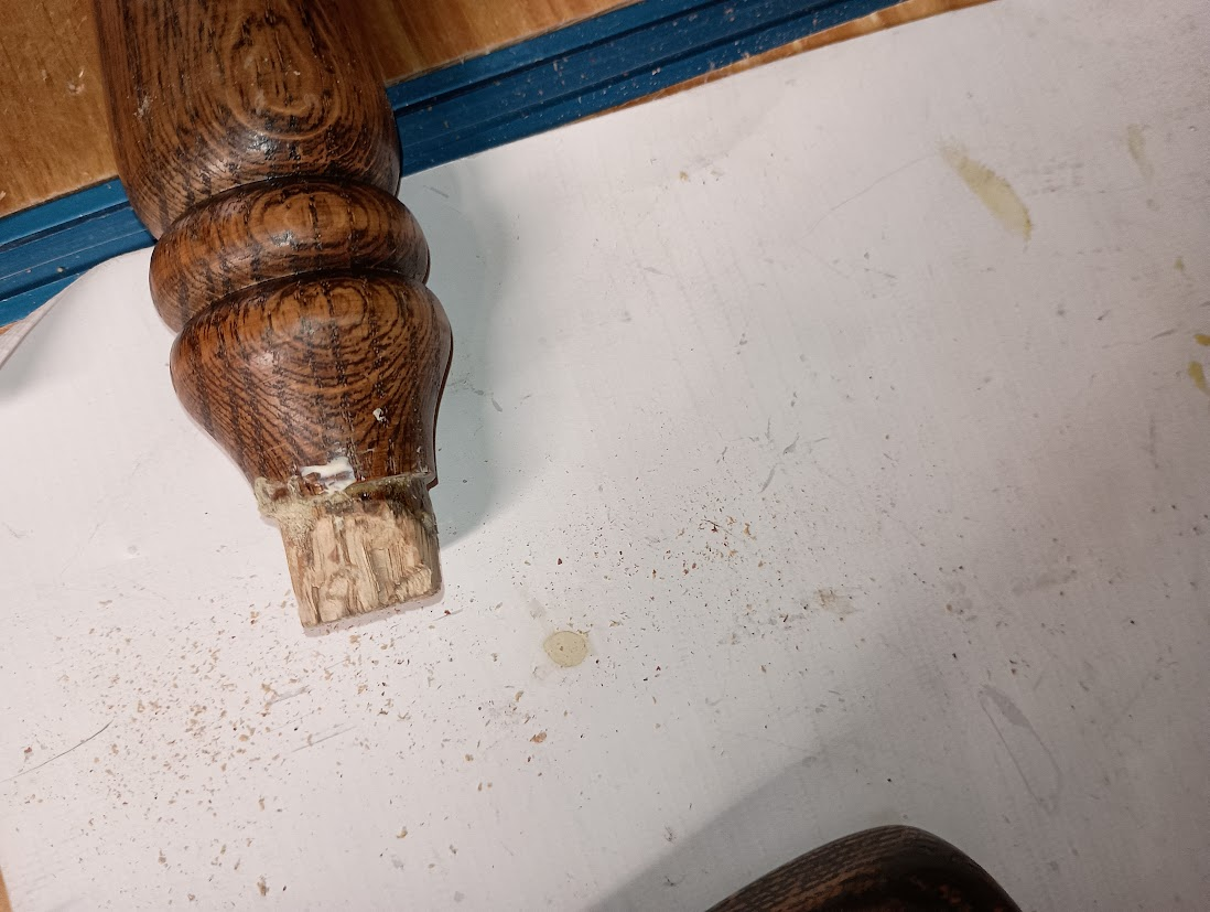

kmealy Posted January 27 Report Posted January 27 Today, I picked up a chair to repair from a friend of my wife. I won't get started on it today, but here are the before status photos. Two things you should never do in repairing a chair 1) Use screws or nails to secure a leg tenon. They hold the piece together but don't make the joints tight. And nails are terrible to remove, usually causing peripheral damage. And they can fracture the tenon, that it did. 2) Use polyurethane Gorilla Glue. It's terrible to clean up for future repairs, the foam can push the joint apart, and while it fills "gaps" that gap filling has all the strength of a piece of Styrofoam. There are some other loose joints and one tenon that is sheared and will need some structural repair. Obviously one of the stretcher tenons had been out for a while based on the rub marks. "A stich in time saves nine." When one joint is loose, it puts additional force on its neighbors causing them to loosen up too. On with the "My husband tried to repair this," DPR (dreaded prior repair). Grandpadave52, DuckSoup, Headhunter and 2 others 4 1 Quote

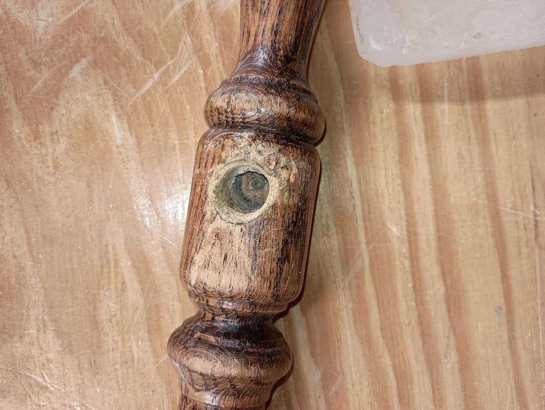

Popular Post kmealy Posted January 28 Author Popular Post Report Posted January 28 Not a lot of time for it today, but phase 1 is complete -- got the screws out and (most of) the joints apart and cleaned off the *(#)*# Gorilla Glue. Please, never use it for a chair repair. An additional problem noted, all the minor joints on the legs and stretchers are brad nailed and deep inset. You can see some of them in the photo. I managed to get one out, but hope I can avoid having to do the rest. Two stretcher tenons are fractured off and need to decide how to fix them. HandyDan, Gerald, Grandpadave52 and 4 others 5 1 1 Quote

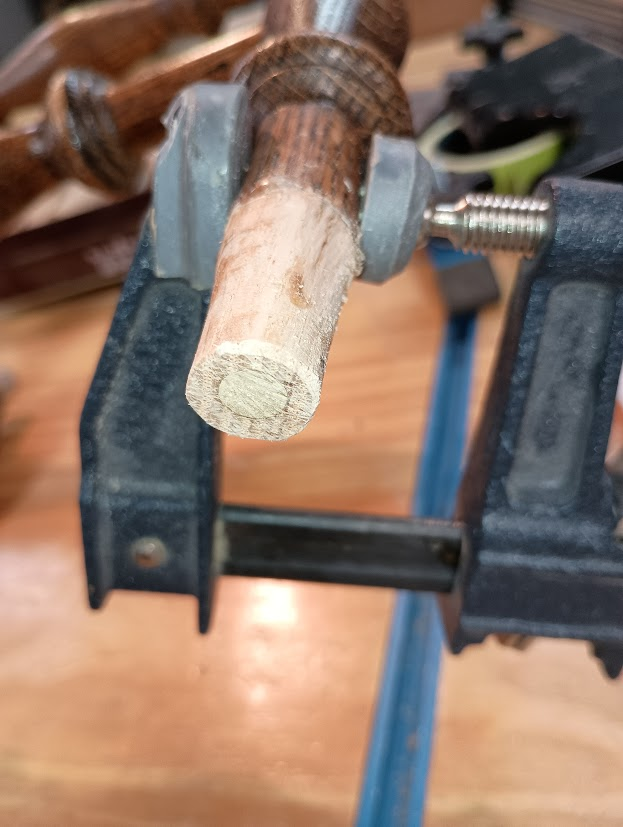

Popular Post kmealy Posted January 30 Author Popular Post Report Posted January 30 On with the repairs. The mid-stretcher was epoxied and a dowel inserted from the outside. The larger joint had all the crap cleaned out of the mortise, a new tenon added and glue is now sitting up. While I normally hate to do it, I might epoxy this joint back together. lew, HandyDan, Grandpadave52 and 2 others 5 Quote

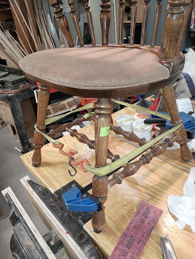

Popular Post kmealy Posted February 3 Author Popular Post Report Posted February 3 Got the touch-up coloring done and ready to go. HandyDan, Headhunter, lew and 4 others 7 Quote
