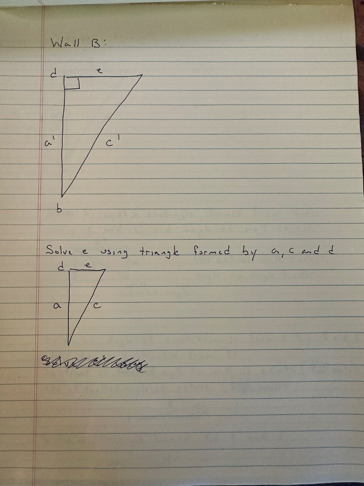

January 1, 20251 yr comment_349181 I’m currently doing a remodel and am redoing all the crown molding. My house has a vaulted ceiling and I couldn’t find a reference for cutting the angles with the crown flat on the saw. I searched the internet and you tube, got a crown molding app and even asked a guy at work that used to do interior trim for a living. Finally just figured it out for myself. Took me a while but I have a good formula. It’s kind of lengthy but If anyone here is trying to cut crown on an angled ceiling and needs a formula, let me know and I’ll post it. Report

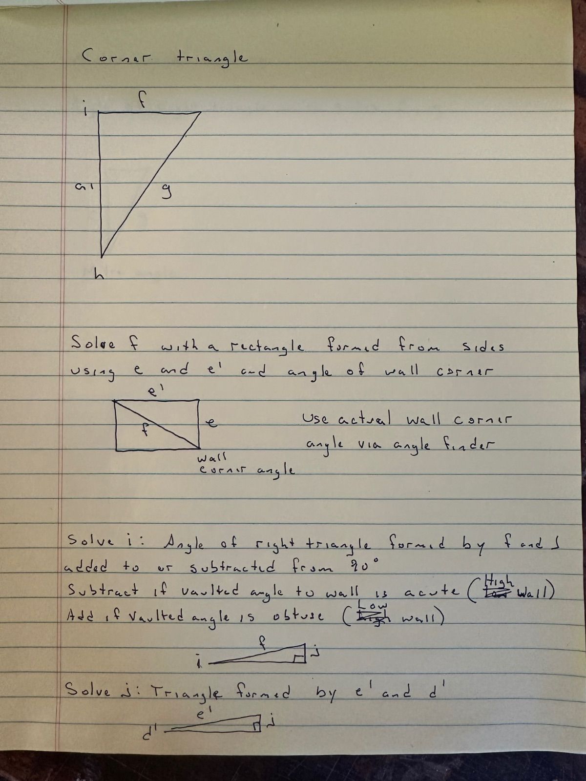

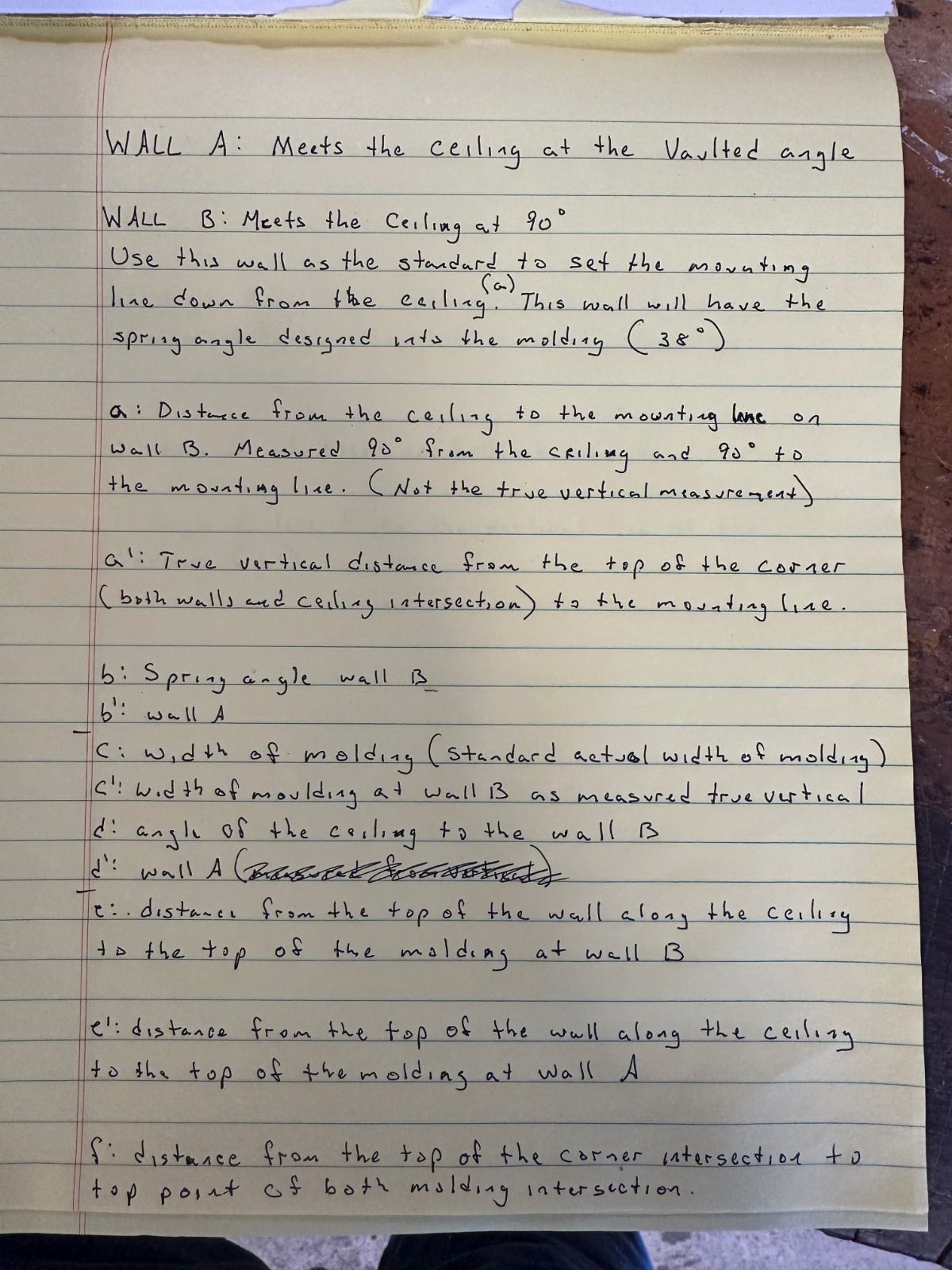

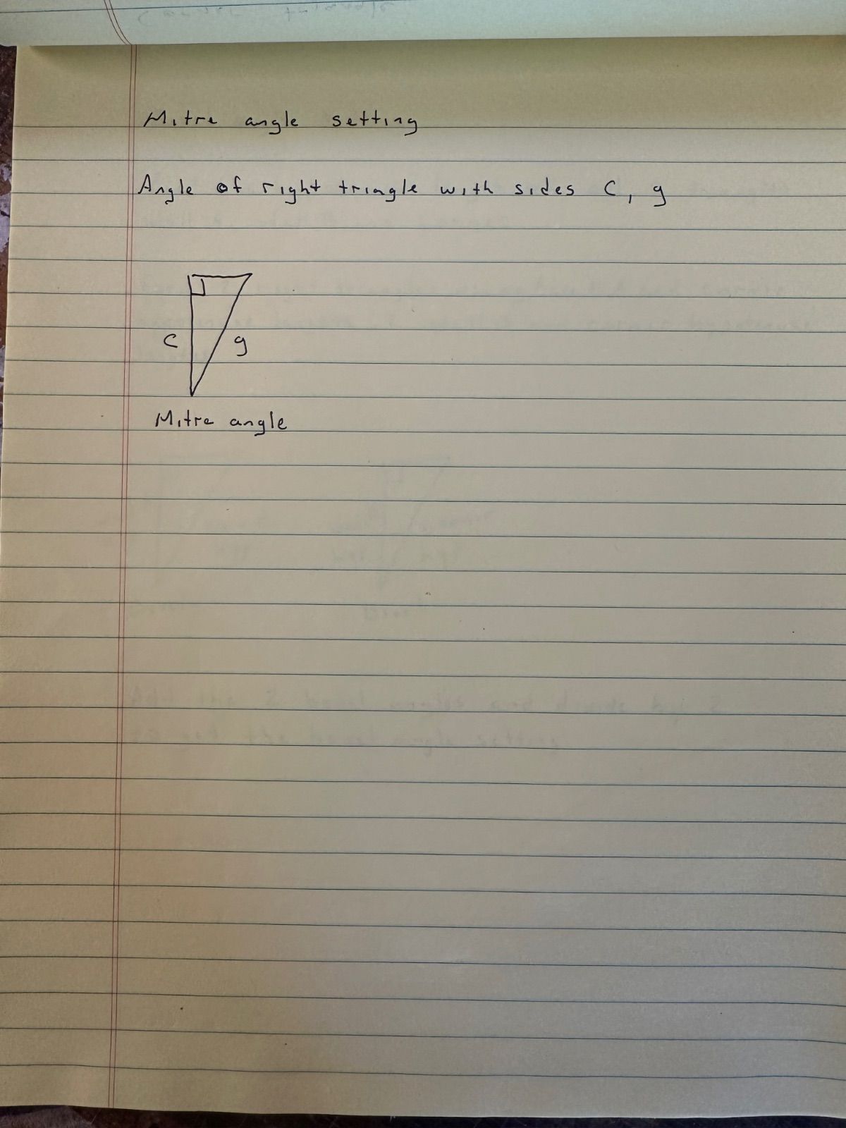

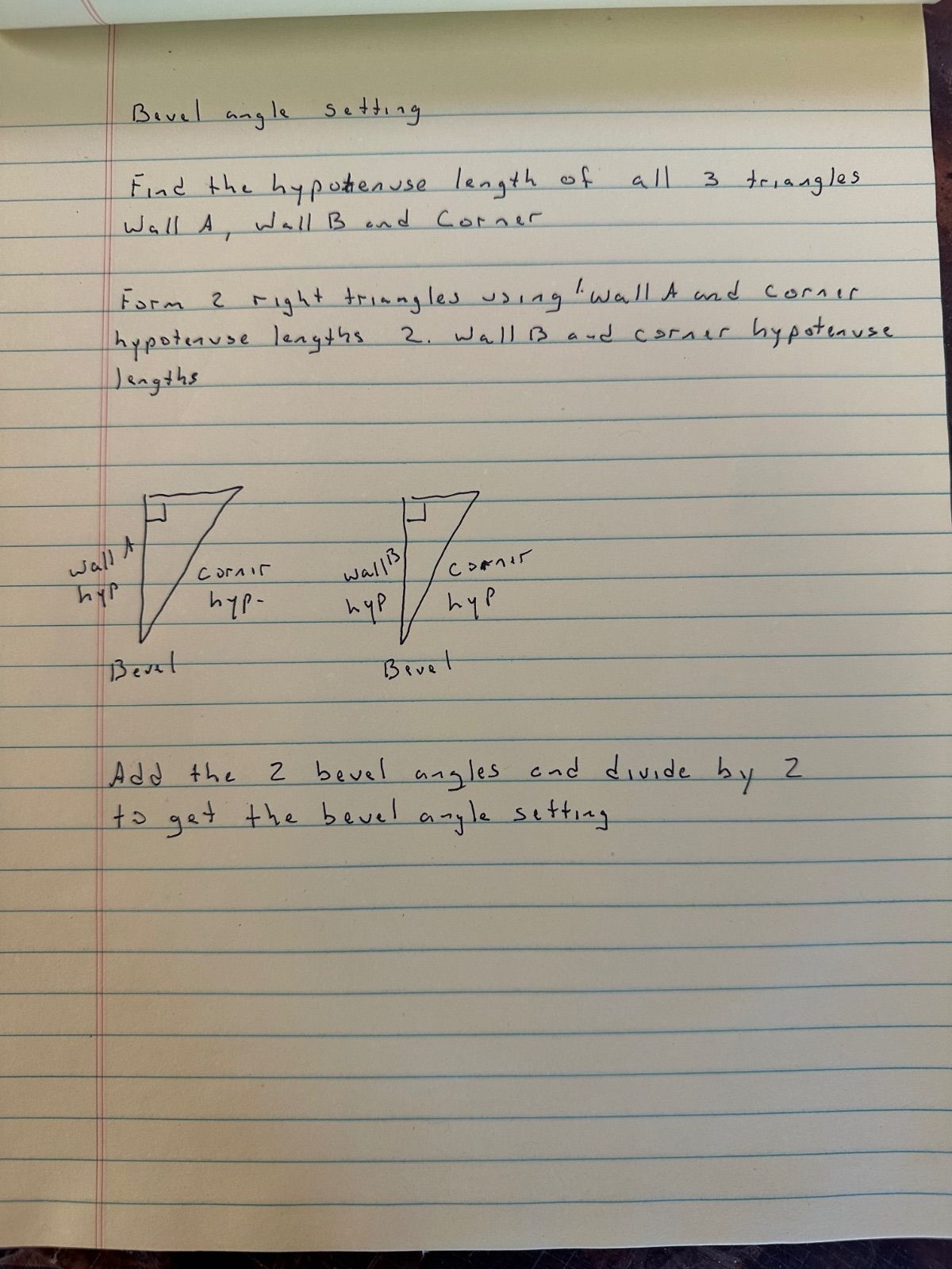

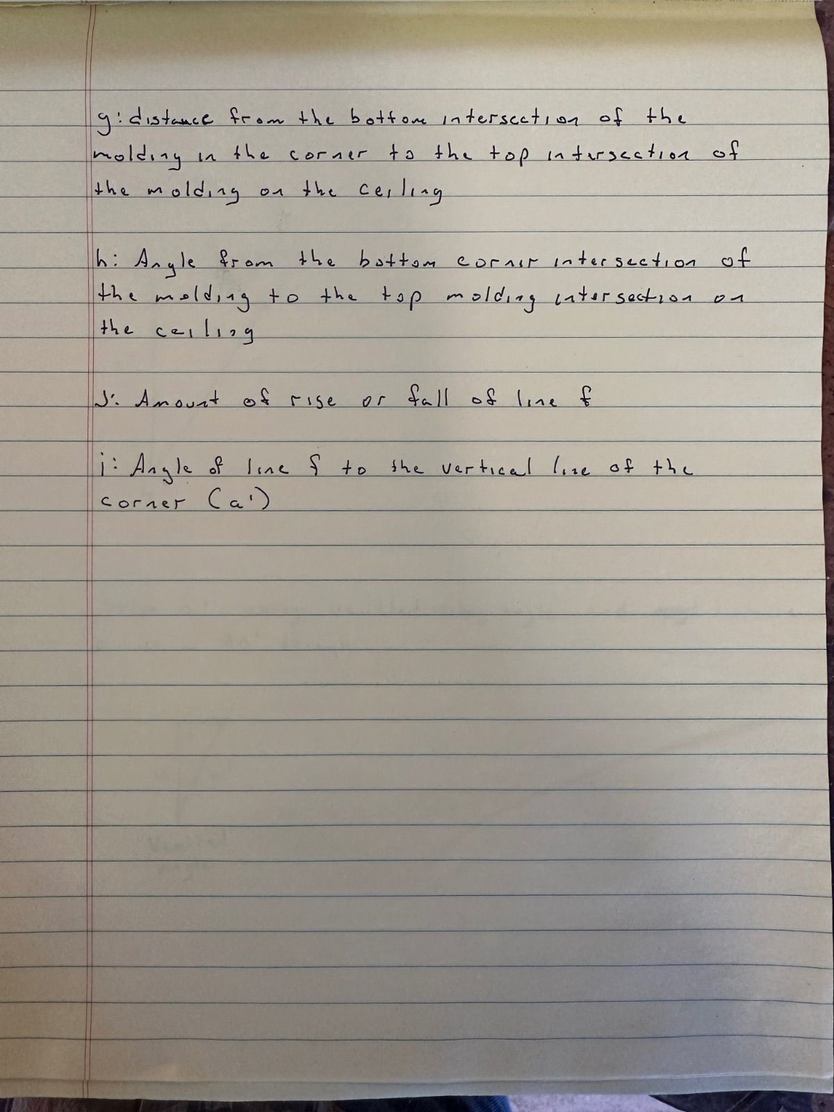

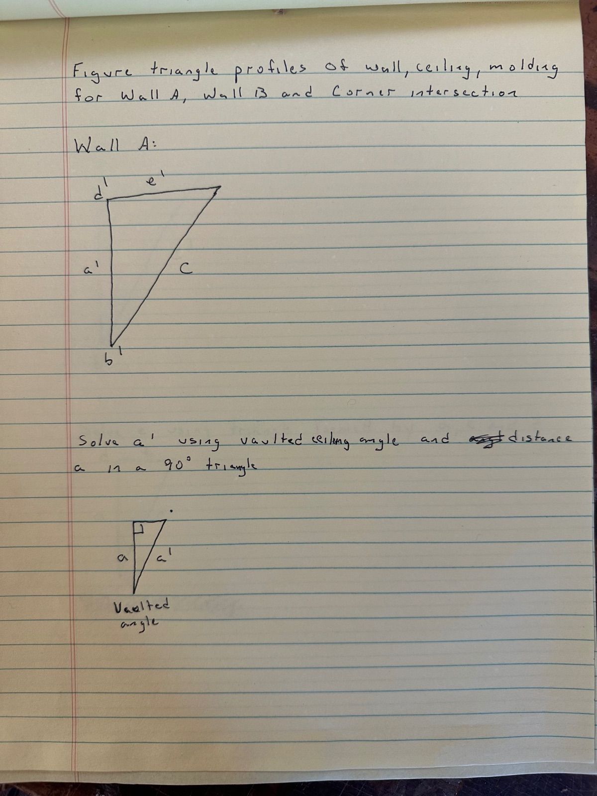

January 1, 20251 yr Author comment_349230 This works for getting the mitre and bevel settings to cut the crown molding laying flat on a compound mitre saw. Rather than try to type it all out, I just attached pics of my notebook. In practice I’d recommend getting actual angle measurements for each angle in the corner with an angle finder rather than assuming 90 degree corners are actually 90 or the vaulted angle is what it’s supposed to be. The beauty of this formula is that it can be used on the corners of the high wall or low wall and inside or outside corners without changing it. You can also use it for older homes that may not be in square anymore, you just plug in whatever your particular angles and molding widths are. It takes a little while to work through the first couple corners, but you can do it in about 5 minutes once you get rolling. I keep notes on each corner so if I have another corner with the exact same angles, I just use the settings I already figured. Report
