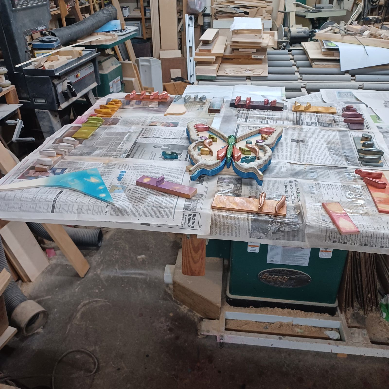

Found a stained glass pattern thats looks good on paper, so
Decided I would use American plywood for I wanted to see how the different plys will look making a butterfly.20240813_095106.jpg.69a424e25040dd6a4e6d268b524eebe4.jpg
 I have this picture scroll sawed in to 56 pieces.

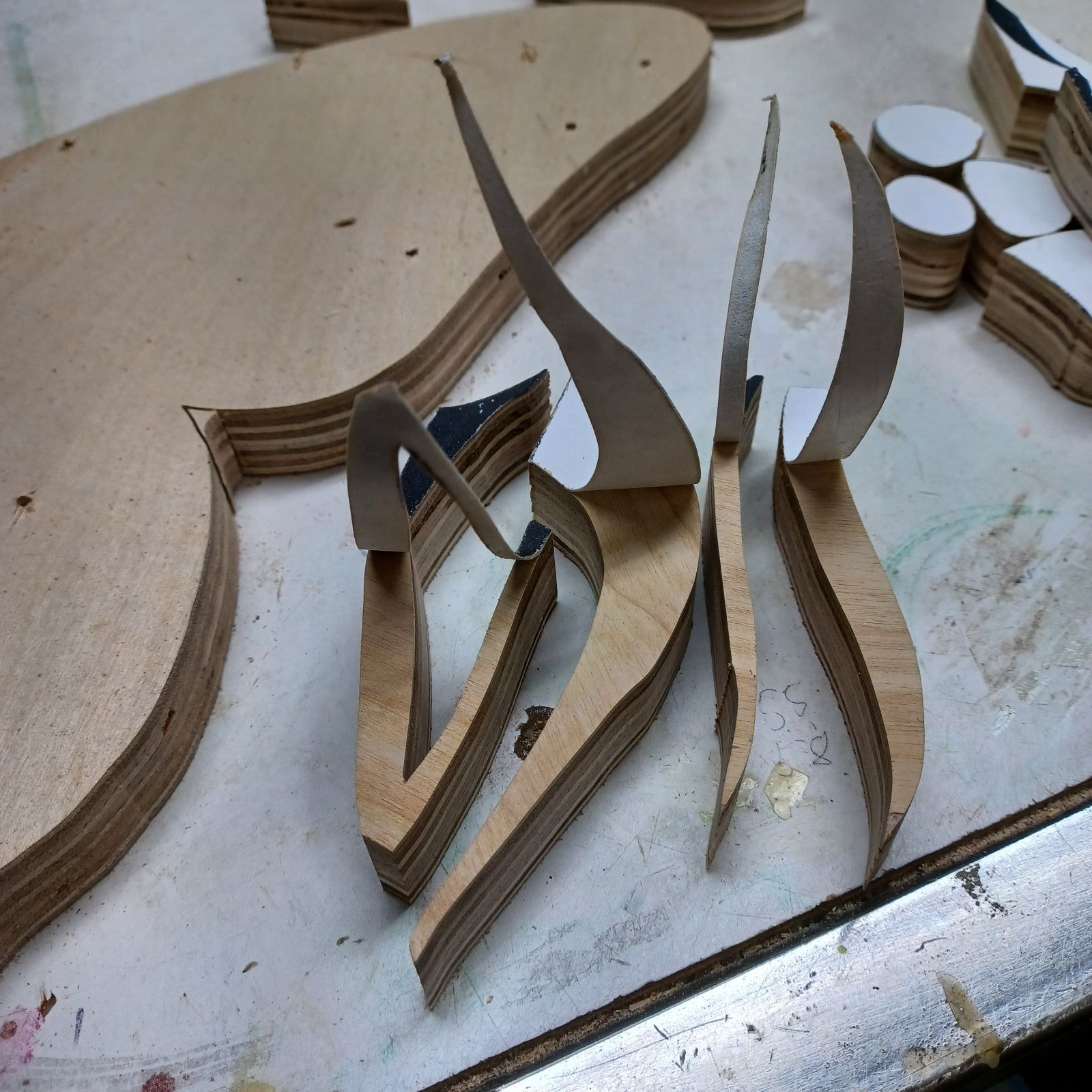

After I used the drum sander to take the bows out of the Ash I then run the edges across the joiner then glued them together. No glue line showing so I will cover all the wood with Scotch brand shipping tape then take the wood in to the next room and shoot a good coat of temporary glue then got wife to help me lay the pattern on to the glue. The reason I do it this way is because long ago I had a 20x30" pattern and shot the glue on to the back of the pattern then as I was trying to lay it on the wood, the pattern got turned wrong and folded back against each other and that was the end of that pattern...A lesson learned to hard way.
  Look at the pattern and even though it is a pattern made by a machine it was the person in charge who made a few mistakes so as I started sawing I caught one or two.
   After I cut out all the pieces I started pulling off the pieces of the pattern. and with using the Scotch brand shipping tape the wood is completely ready for the carving to begin as the next step, meaning I don't have to use any kind of thinner to loosen the glue and try to get it up off the wood so I can continue. Hoping to have the thing finished tomorrow with a picture to show!!20240814_102147.jpg.546b4584f516470ef6bbf19212e830e7.jpg20240816_093227.jpg.31ba96bb5ec5c5811db3116cdeacad10.jpg20240816_133918.jpg.82907c7bdde740bc855d253c69198570.jpg20240813_110510.jpg.a271e139b9940d16036cc58c63d3d883.jpg

I just now looked at the outside temp and it said 108.5 so I charged out to my shop and brought this butterfly inside for I was afraid he might catch fire20240817_150332.jpg.72600e20d1a1be606fee37818fd1495f.jpg
Did someone say unique?  That is stained glass in wood :TwoThumbsUp:
I hope you like these pics Jess, it was about a 10 step process to get them here!

Very cool Patch. Lot of pieces to remember where they go as least for me.
Did you like how it turned out?
No Dave,I do not like to use American plywood. Too many voids and the top ply is so thin and brittle I have to spend too much times correcting all the bad stuff..Once I started using Baltic Birch plywood  I don't want to use anything else..
 A 30 minute drive home from Home Depot with  4x8 sheet of American plywood laying flat in the sun ain't flat anymore and can't be made to be flat ever again...My drive home might be hotter than most guys have to do and I under stand that but I can't ever tell what I will need when its 20 degrees outside.
  I just wanted to see how this water base paint I use for most of my projects would look and if so should I use it again,NO. for the Baltic Birch gives me about the same looks with the different plys and besides the baltic birch has more plys should a person tapers the wood so all the ply's can be seen makes my projects look better, I think.
