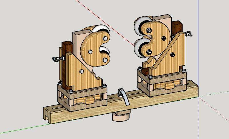

August 9, 20242 yr comment_340203 I received a question about how to take this apart to move it. Maybe this would help? Not technical drawings, but shows most of the pieces. I guess it could be made with pocket screws. Dan Report

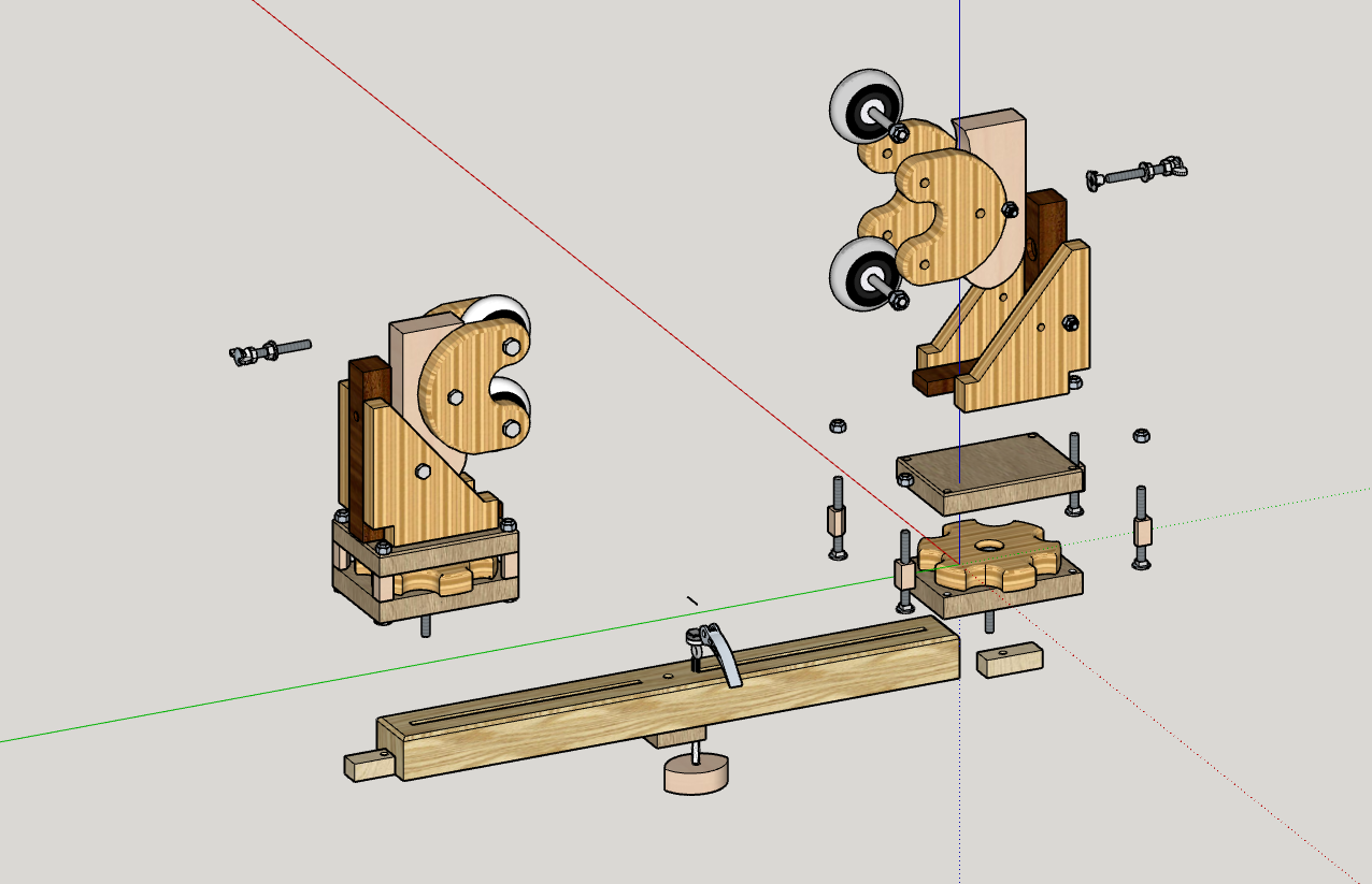

August 10, 20242 yr comment_340256 39 minutes ago, Dan Cooper said: No, I just took apart the Sketchup model. Dan This Sketchup extension- https://sketchucation.com/pluginstore?pln=Eclate_Deplace will do that for you in one step The Sketchup model before- The model after running the plugin- In my model, I created components of some of the sub-assemblies then made copies. That's why the wheel assembly on the left is not completely "disassembled". The plugin provides options on how to display the "exploded view". I'm using it on Sketchup Make Free 2017 Report
August 12, 20242 yr Author comment_340373 Thanks Lew, I'll check it out. I love your model. Dan Report
