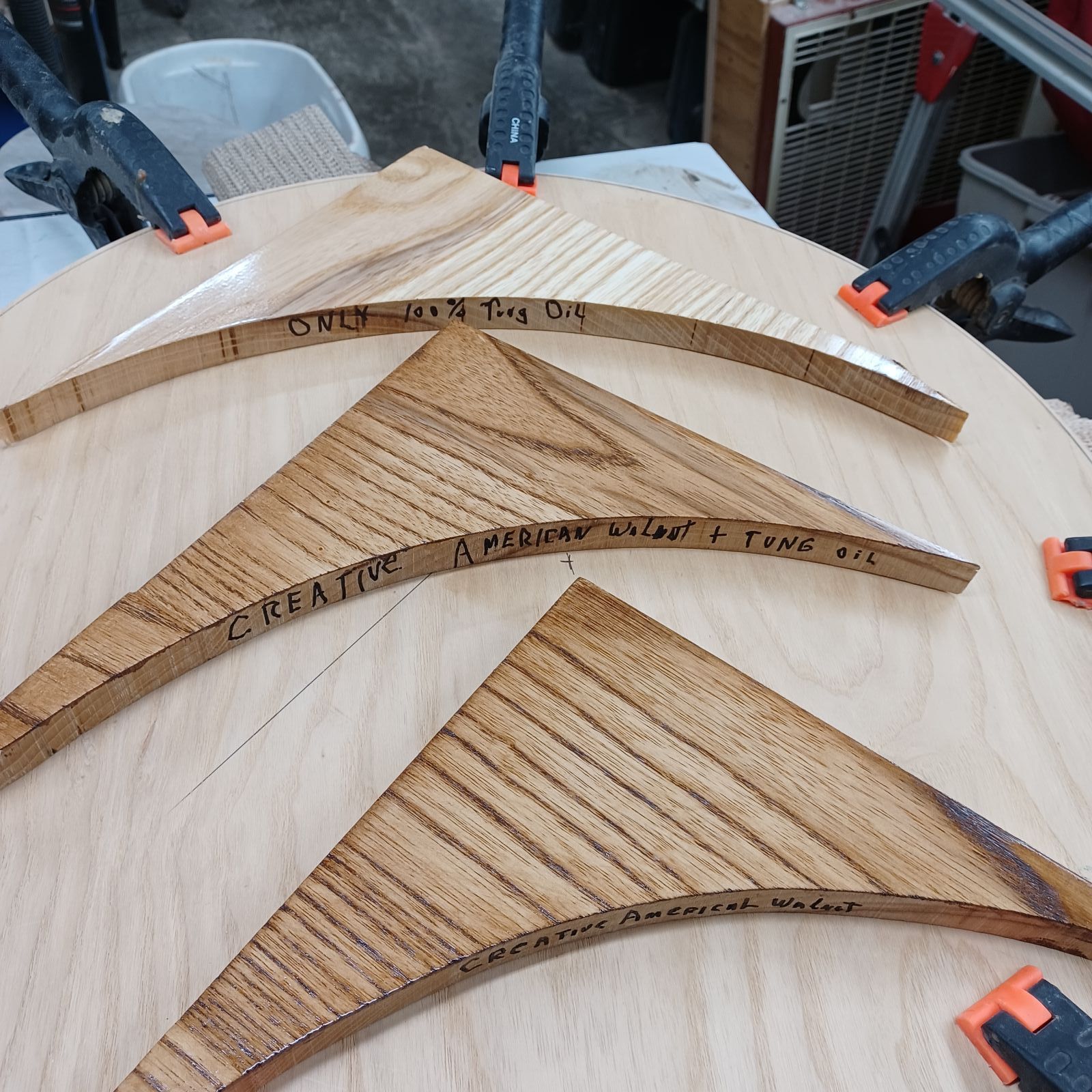

     I am in the process of making him some samples for the top of that table and I sure don't want to have him feeling

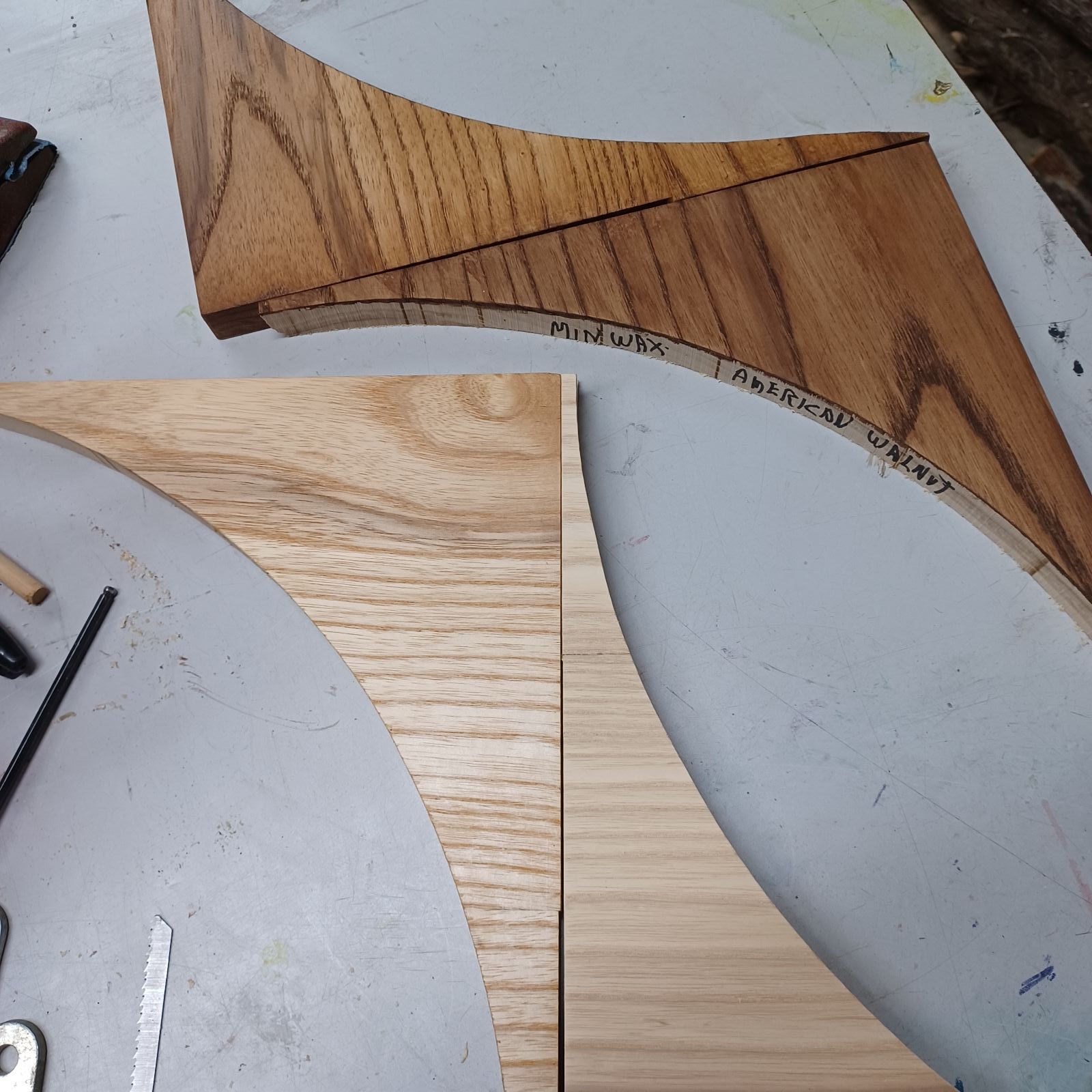

any worse than he already does.  I am thinking the minwax  looks worse than the other samples. Never liked that brand anyway.  I will try to talk him into the one above it. I also like the 100% tung oil that is next to the just plain wood with nothing on it20240806_152724.jpg.aea85afceaa2cf1acb064791f72cb7ce.jpg20240806_152956.jpg.2f0941f99b33ddd267d9004949eff85a.jpg20240806_200440.jpg.2ce1aec1502f8cdfc863e0850290e8f7.jpg

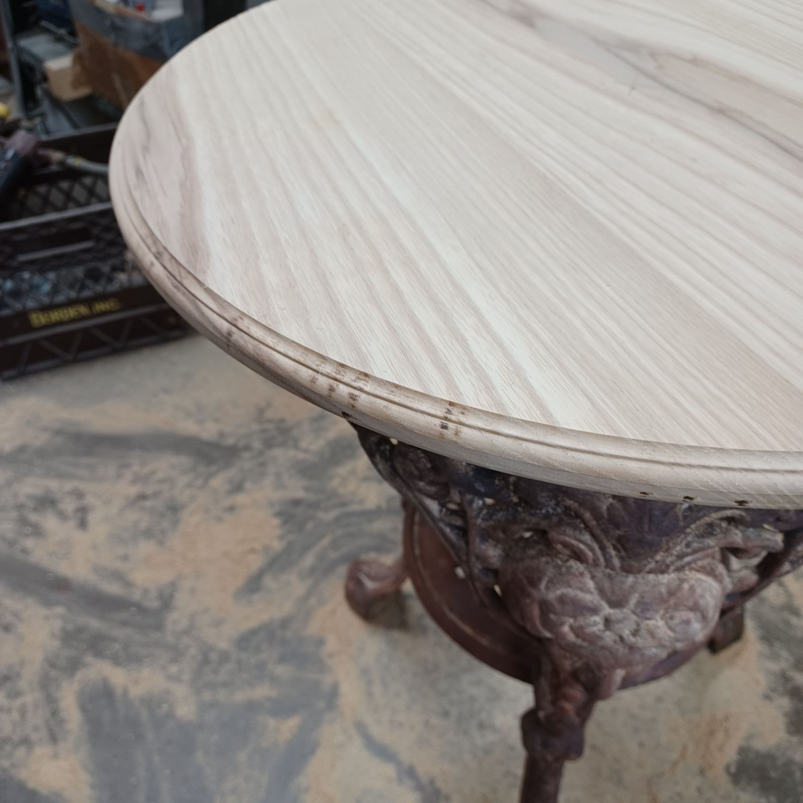

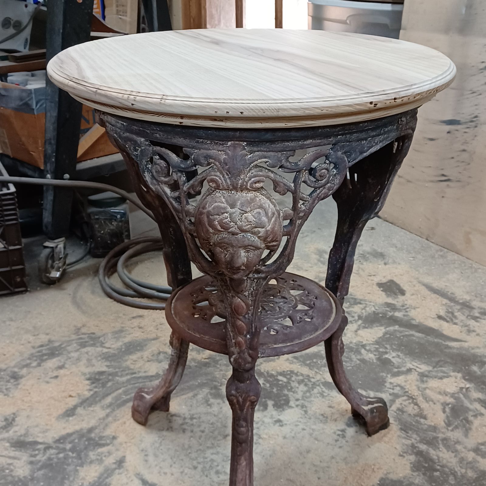

That table base is pretty awesome, what are your plans for that?
And what type of finish is the one pictured above the Minwax?  I like it the best also.

Cal the two bottom samples in the first picture are just the ash wood with nothing on it. The other piece has 100% tung oil which I dried it off after about 10 minutes with a dry towel.
   This next picture has whats on each one if you can read them plus they have clear gloss 2X on top . gloss rustoleum 2 X
I think he wants the base put back to white. I thought maybe it had an off white be he said no, only bright gloss white.
I think I will only show him the two top pieces in the last picture. Actually when I move the boards in my hands I think the tung oil with a clear gloss coat looks the brightest. The more I use 100% tung oil the better I like it and it is the easiest thing to do for the wood and is mostly water proof and probably the cheapest for quart last forever.
The best reason I like it, your finished project never has no blotching or things a person has to redo a time or to to please a customer.
The bad thing about the product is most people use tung oil finish and it don't ever have any tungg oil in any of the brands

Also sorry to hear of you friends loss.  As for a finish on red oak I've been a fan of cherry stain.  Then tung oil on top followed by some wax.  I found that on oak it would look better/closer in hue to the colors in air dried walnut which much of my other furniture is. Might me worth taking a sample strip of stain colors to compare to the colors of the base.

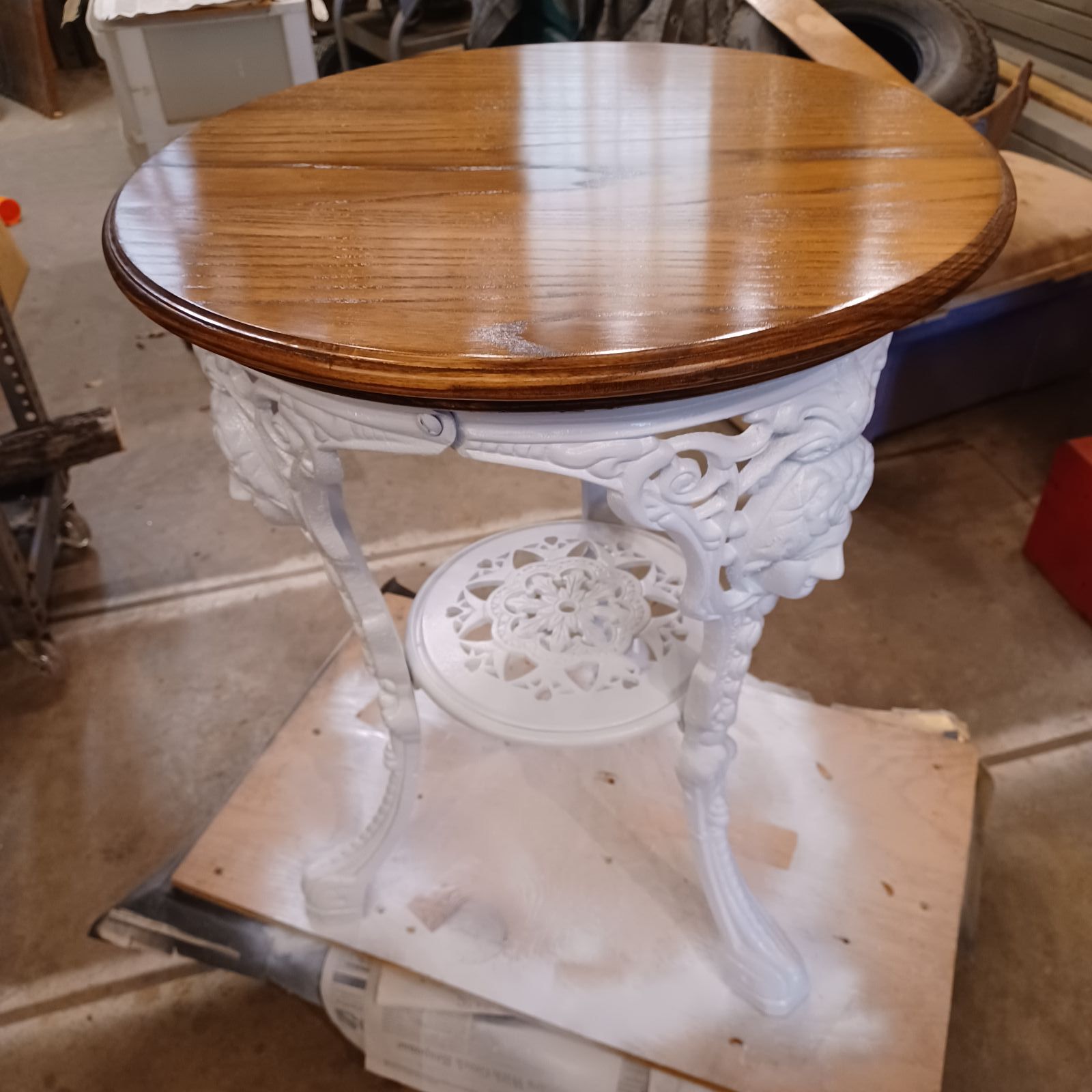

Here is the results and ready for that trip back to his burned down museum!20240824_122802.jpg.79e762e685968d43ff06f554613f8977.jpg
I know it's not the same as what he lost, but you did him good Patch. Well done on all fronts sir!!:Praise:
