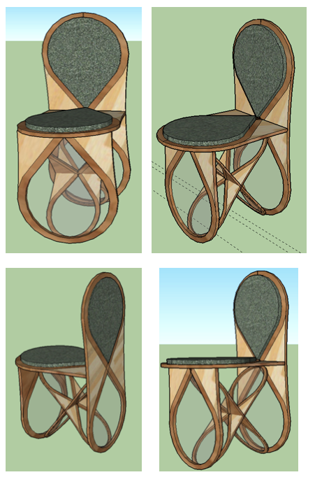

July 17, 20242 yr comment_339081 Another "out there" Sketchup model. I know, as it is would not stand up, but I couldn't figure out the best approach to support it without wrecking the design. Maybe you have an idea? Dan Report
July 17, 20242 yr comment_339082 Cool! How about a large "infinity" figure horizontal across the back Report
July 19, 20242 yr comment_339138 You've got two points touching the ground/floor. Change it so three points touch the floor such as two on the sides and one on the back center. Then of course you'll need to build one to see how tippy it might be. 4D Report
