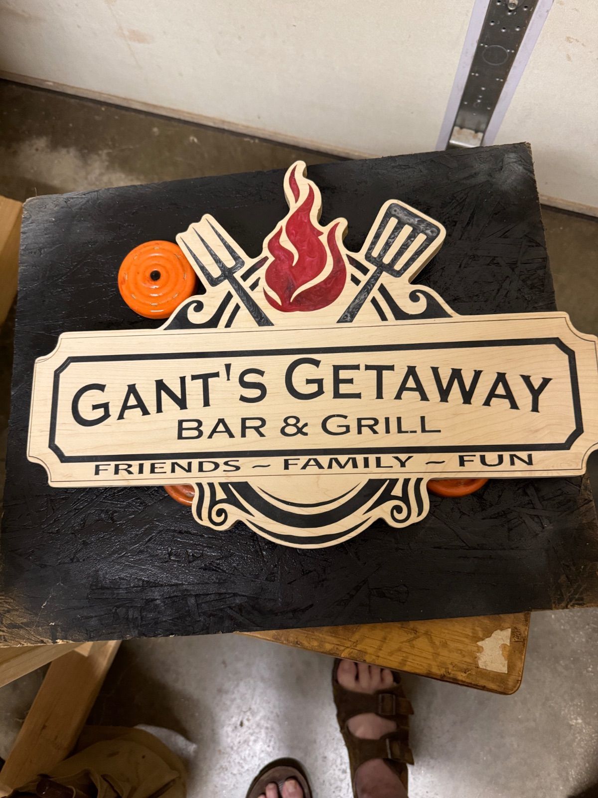

Popular Post KevTN Posted July 8, 2024 Popular Post Report Posted July 8, 2024 (edited) Just finished this project. Kind of fell into my lap. I am looking at getting into a makers market. I took several example pieces and one was a small sign that said Pops Back Porch Grill. She said she wanted the sign. I said you can have it as it was a practice piece. She said, “No, I want you to make me one just like this.” We came to an agreement for the project. Made of hard maple. Edited July 8, 2024 by KevTN Grandpadave52, Fred W. Hargis Jr, lew and 2 others 3 2 Quote
honesttjohn Posted July 8, 2024 Report Posted July 8, 2024 (edited) Love the way maple carves. Here it's more expensive than oak - which I use a lot of. Did you just flood the epoxy and then recarve it? Haven't opened my epoxy cans yet. Edited July 8, 2024 by honesttjohn lew and Grandpadave52 2 Quote
KevTN Posted July 12, 2024 Author Report Posted July 12, 2024 On 7/7/2024 at 11:25 PM, honesttjohn said: Love the way maple carves. Here it's more expensive than oak - which I use a lot of. Did you just flood the epoxy and then recarve it? Haven't opened my epoxy cans yet. Thanks John..I actually got it at a local mill. My wife found it a said how much. 10 bucks. LOL A bit of milling and I was surprised how well it cleaned up. For this one. I did the carving 0.12. Sealed it with Shellac. Over filled the Epoxy. I should have poured the black and then the next day pour the red and grays but.... Then surfaced it. Grandpadave52 and lew 2 Quote
KevTN Posted July 12, 2024 Author Report Posted July 12, 2024 On 7/8/2024 at 4:29 PM, lew said: Wow! Love that sign!! Thanks Lew....I appreciate it. Grandpadave52 and lew 2 Quote
4DThinker Posted July 13, 2024 Report Posted July 13, 2024 Love how such projects look. Very curious how well they last. My experience with epoxies is that over time (a couple decades) they break down/crystalize as the chemical reaction persists even though it is slowed down as the resin hardens. I'm also curious about expansion/contraction of the wood which might make the inlayed resin pop out or crack. Just a thought inspired from having lived long enough to see everything I used some 2-part epoxy on eventually fail. 4D Grandpadave52 and lew 2 Quote
