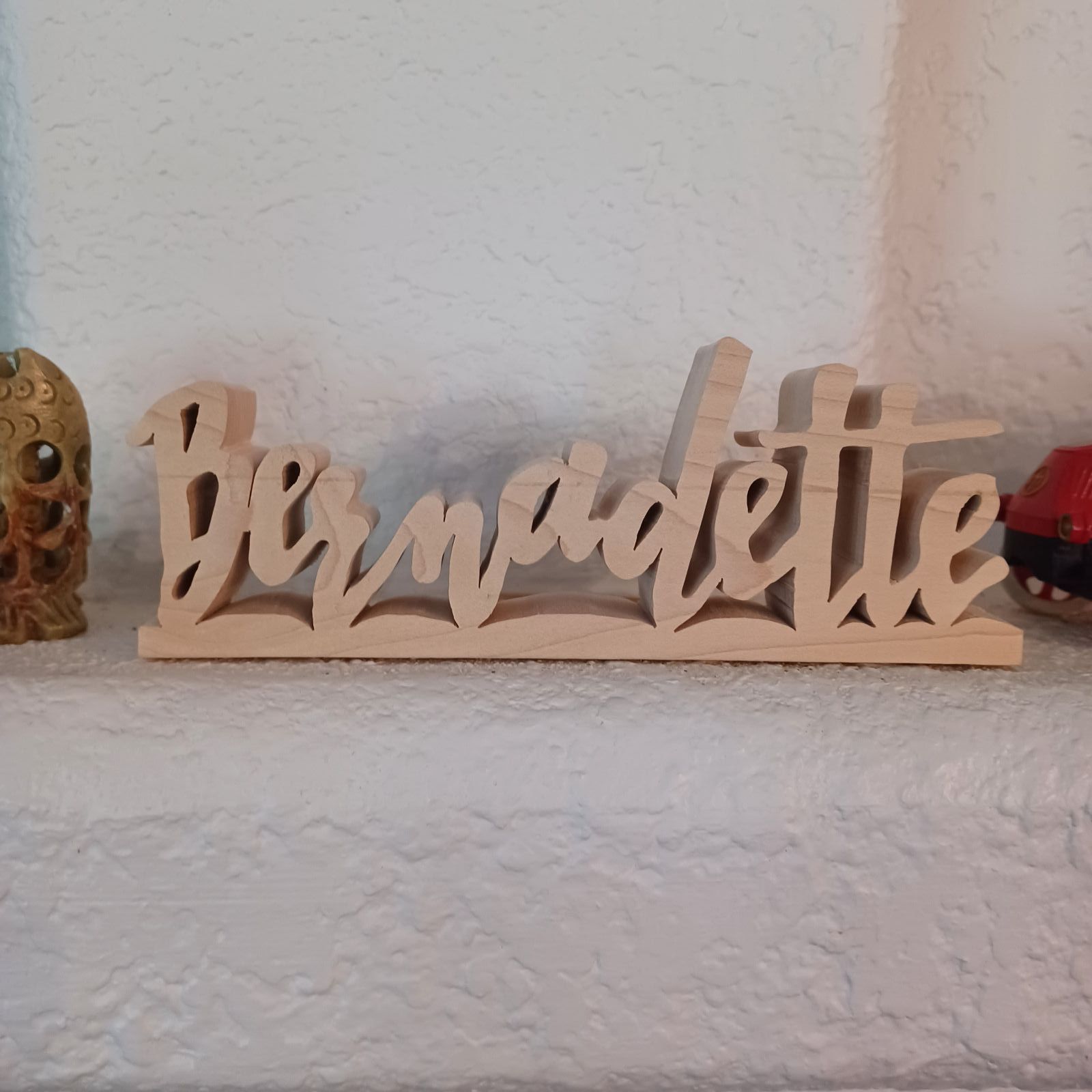

July 7, 20242 yr Popular Post comment_338459 Sitting here this morning and decided to crank up the scroll saw. Just another Bernadette for I think of her all the time. Report

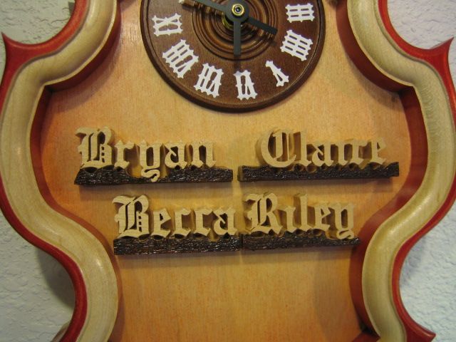

August 7, 20242 yr Author Popular Post comment_340087 Rapid Resizer has about 70 to 100 different fonts.. You can get free fonts but all that you will get is letters where Rapid Resizer will make the size you need, the kind of fonts and if needed, put the names into an arc then it tell my printer to make the copies needed.. You will notice all the names I use are attached together with a log! under the letters which I draw under the letters before I scroll them out. Or just print out the letters with the right spacing between each letter. Then I can glue the pattern on the wood Report
