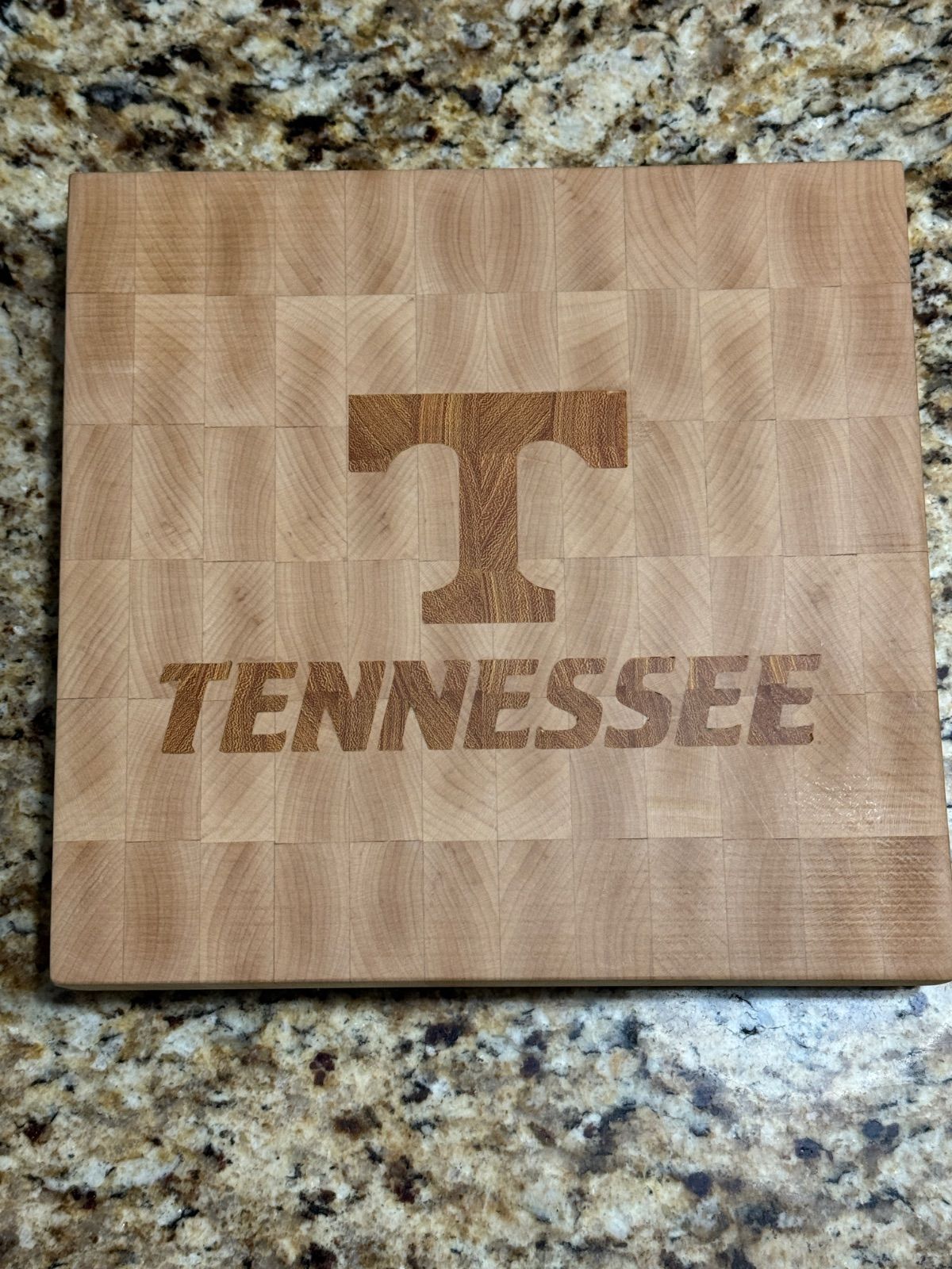

Long story short. My mother in law is chair bound due to a stroke. She has pvt sitters that help. Well both she and my father in law got pneumonia at the same time. One sitter went above and beyond. She also had asked if I could make her a TN cutting board. I told her yes if she would pay for the materials. (Before the pneumonia occurred). So made up a hard maple and Osage Orange inlay. (I really like Osage to work with). After the illness my wife and I agreed to just give it to her as she went way above and beyond to help my in Laws in a lot of ways.

And you even spelled Tennessee right .................  I think.   Nice job!!!!  How bad was getting the boards square for the glue up?
Do you just bandsaw the letters off the block? (I love it, BTW)
Pretty sweet Kevin, all around :TwoThumbsUp:

Haha... I hope I spelled it right   Not hard at all. I jointed the edges then used my sled to keep square.

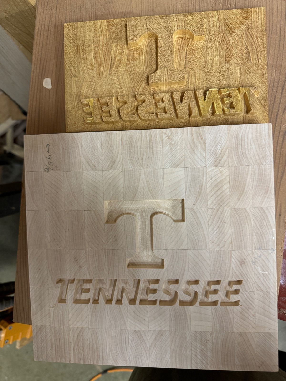

I wish my bandsaw was big enough. I used the CNC with a 1/4 inch End Mill with a start depth of 0 and Flat depth of 0.001. I zero the Z axis directly off the top of the board.

Yep.  At the university I taught at we had a big bandsaw that could usually deal with the glued in inlay board.  Then a drum sander to feed the board through to take care of what was left.   Whenever I helped a student with a VCarve inlay their eyes would open wide when finally the surface was smooth and their inlaid image appeared.
