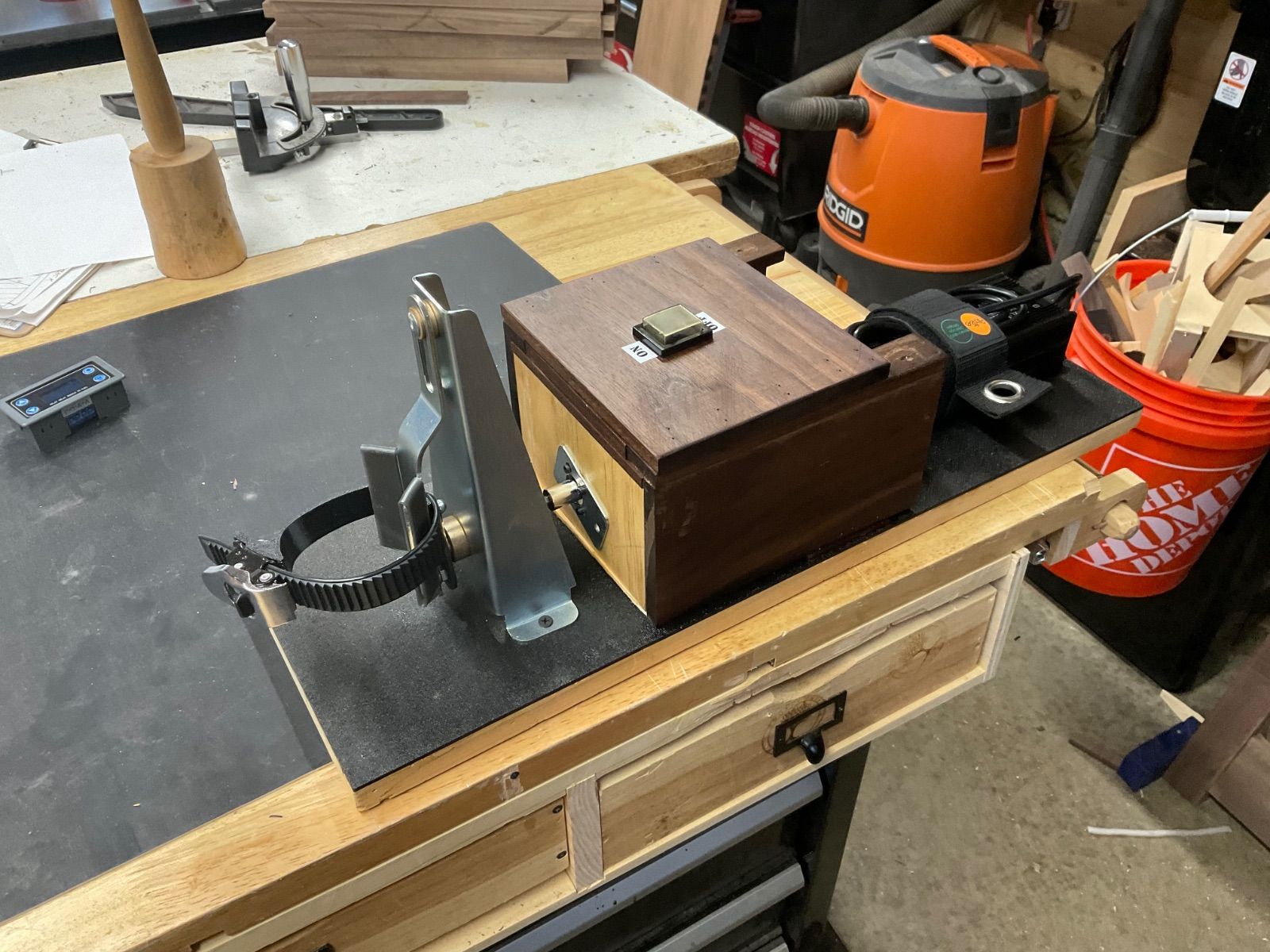

March 26, 20242 yr Popular Post comment_332511 Well, I made a spray can shaker. I have atheritis in both hands and hand tremors. Sometimes I drop the can I’m trying to shake. So I seen a YouTube video and decided to make one. Not much to look at, I used some scrap walnut and a piece of plywood. I covered the plywood with some plastic my daughter got from her work that were to be thrown out. It has a 12v motor, a (forgot the technical name) a converter that goes from 110v to 12v. I wanted to wire in a timer, but I just can not figure out how that is done. So I got frustrated and wired in an off and on switch until I can figure out what I’m doing wrong. I just wiped the walnut down with some walnut oil and made a little video. Seems to work well.you can see the timer (a gray box with 4 buttons on it). IMG_0701.mov Report
March 26, 20242 yr Author Popular Post comment_332515 1 minute ago, lew said: Now that is just plain cool! Thanks!! Thanks Lew. Report
March 26, 20242 yr comment_332516 Something like this might work for the timer- https://www.amazon.com/Countdown-NEARPOW-Customize-Function-Eectrical/dp/B0CF183NH9/ref=sr_1_56?crid=3LNZDJXYIFMRK&dib=eyJ2IjoiMSJ9.pc8gHBOtiT_JjOTac2wmG254rW-92UoG_SNImYUQWDJIZ7LaooIoibynWzSBKZ78ndFNQi3UzjyngkyKMK51NjPdTn1995eIYsImxsEU8AoYKNsod9YHv0-gWh7ZlECiXcVia8BjfrkcrSK7ruh-g5YQFNXgMN2AcKja8o2YXVa37XnC57AYOl68TOjAhPsZC-pHz1vRXFBPej3Aj4mJ4VP6fZJXcGpx3fX4ZDEcvXb2R5tw3_P6-_NeXQpYgKTmGIqRDA0QeKUSYeM4ubpHgVGGL6MpkhllgdDjJ4n4RBc.mINduiQpwik7Lah-HFBE6Nr8WLPSuekvEjsWe3Jb7kg&dib_tag=se&keywords=programmable+countdown+timer+with+switch&qid=1711465301&sprefix=programmable+countdown+timer+with+switch%2Caps%2C87&sr=8-56 Report

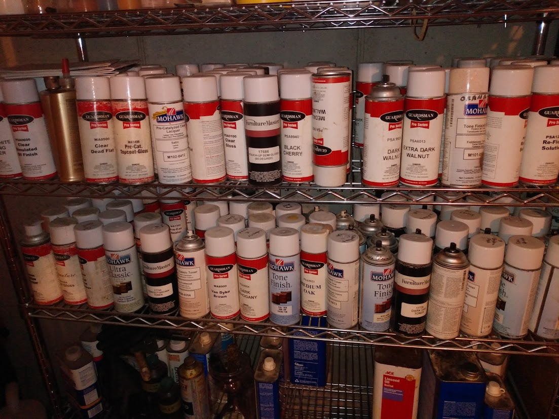

March 26, 20242 yr comment_332535 I might be able to use one of those. The other half are in lidded totes Report

March 27, 20242 yr Author comment_332567 20 hours ago, lew said: Something like this might work for the timer- https://www.amazon.com/Countdown-NEARPOW-Customize-Function-Eectrical/dp/B0CF183NH9/ref=sr_1_56?crid=3LNZDJXYIFMRK&dib=eyJ2IjoiMSJ9.pc8gHBOtiT_JjOTac2wmG254rW-92UoG_SNImYUQWDJIZ7LaooIoibynWzSBKZ78ndFNQi3UzjyngkyKMK51NjPdTn1995eIYsImxsEU8AoYKNsod9YHv0-gWh7ZlECiXcVia8BjfrkcrSK7ruh-g5YQFNXgMN2AcKja8o2YXVa37XnC57AYOl68TOjAhPsZC-pHz1vRXFBPej3Aj4mJ4VP6fZJXcGpx3fX4ZDEcvXb2R5tw3_P6-_NeXQpYgKTmGIqRDA0QeKUSYeM4ubpHgVGGL6MpkhllgdDjJ4n4RBc.mINduiQpwik7Lah-HFBE6Nr8WLPSuekvEjsWe3Jb7kg&dib_tag=se&keywords=programmable+countdown+timer+with+switch&qid=1711465301&sprefix=programmable+countdown+timer+with+switch%2Caps%2C87&sr=8-56 WOW! Now that would make it easy. Thanks Lew. Report

March 27, 20242 yr Author comment_332569 13 hours ago, kmealy said: I might be able to use one of those. The other half are in lidded totes Wow…you could probably use two or three of the shakers. Report
March 27, 20242 yr Author comment_332570 11 hours ago, Grandpadave52 said: Very cool Paul. Much fancier looking and functioning than mine. It too was a creation out of need for shoulder issues and my back surgery. Actually, this is my third attempt at it. I had some old electric motors and made my own shaker parts. The first one the motor was quite strong enough to maintain the torque it need and burned out. So I used another old motor and that one was just to powerful. It broke a link and hit me in the stomach. Still have the mark. So this is my final attempt. The part that holds the can was purchased from Amazon as well as the 12 volt motor. Seems like it’s going to work (hopefully) well. Report
