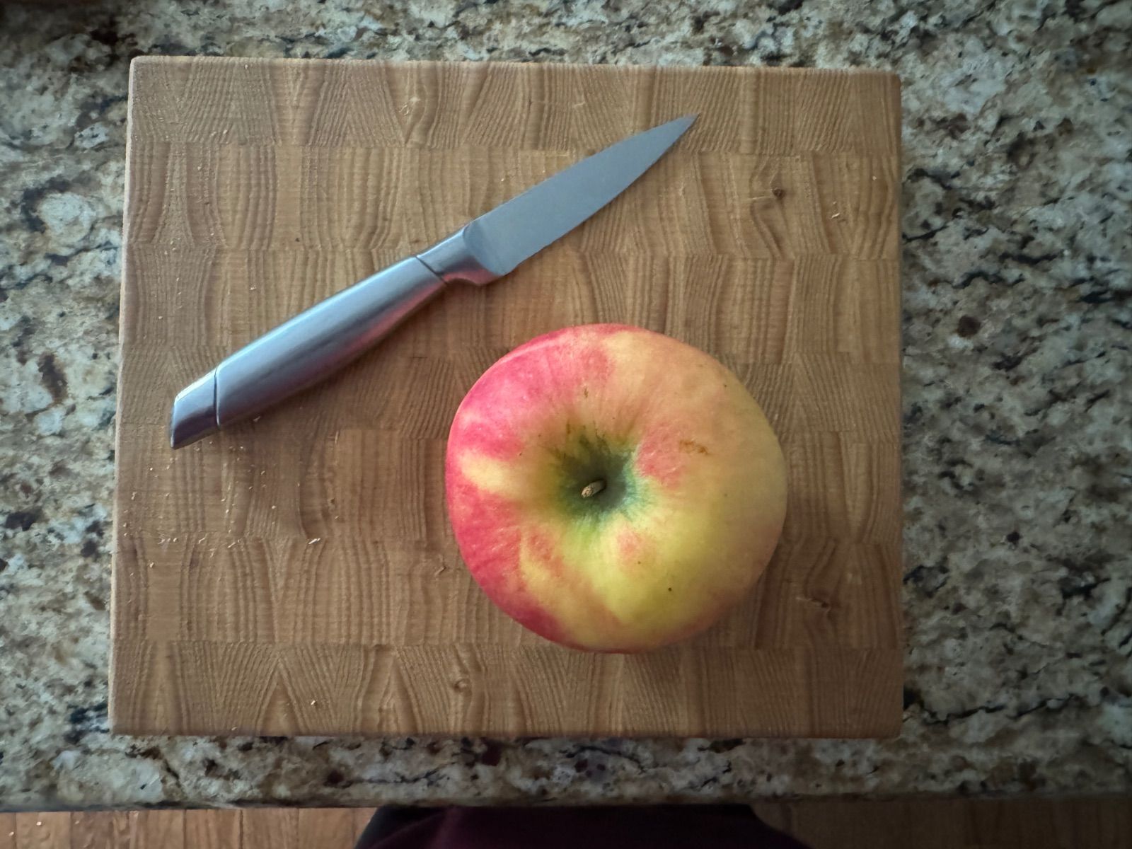

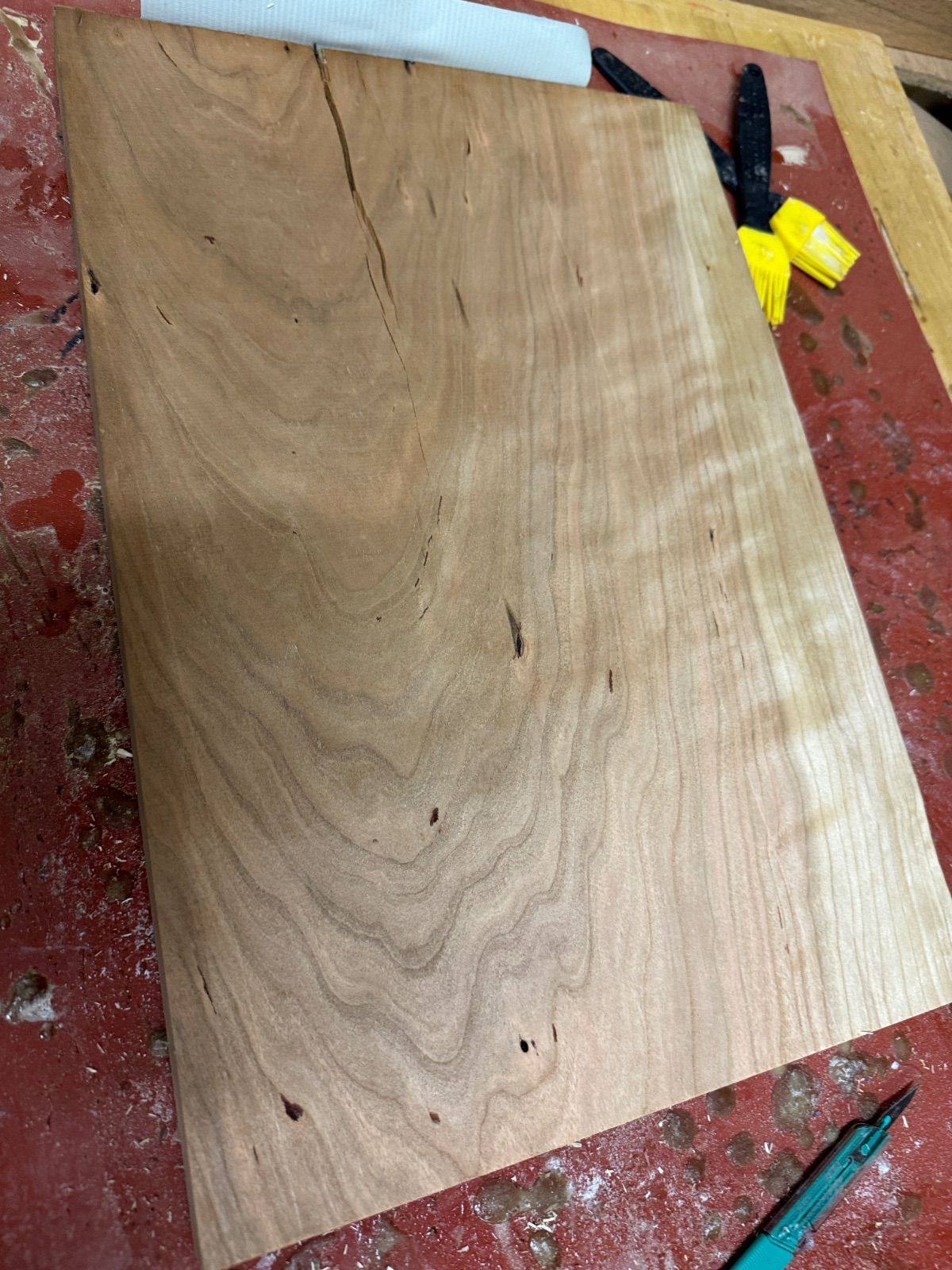

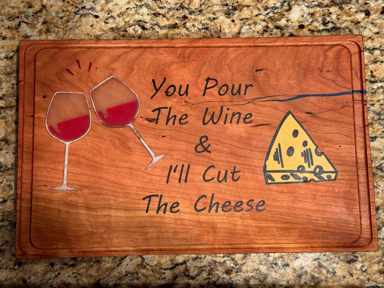

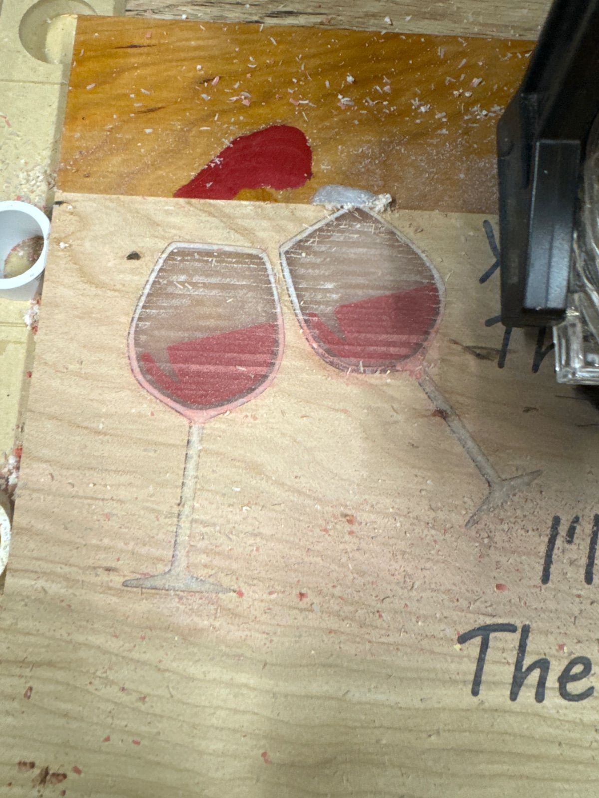

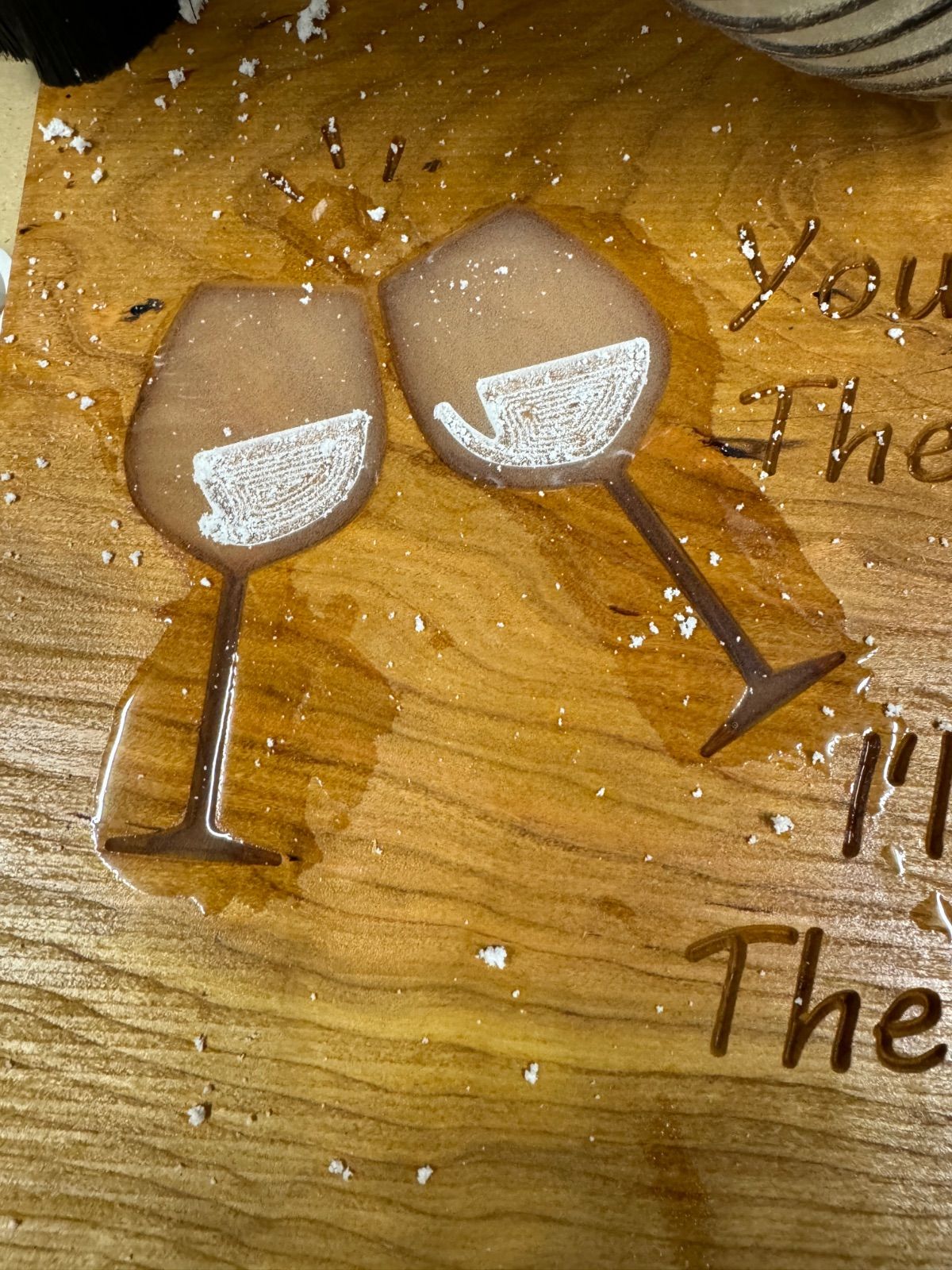

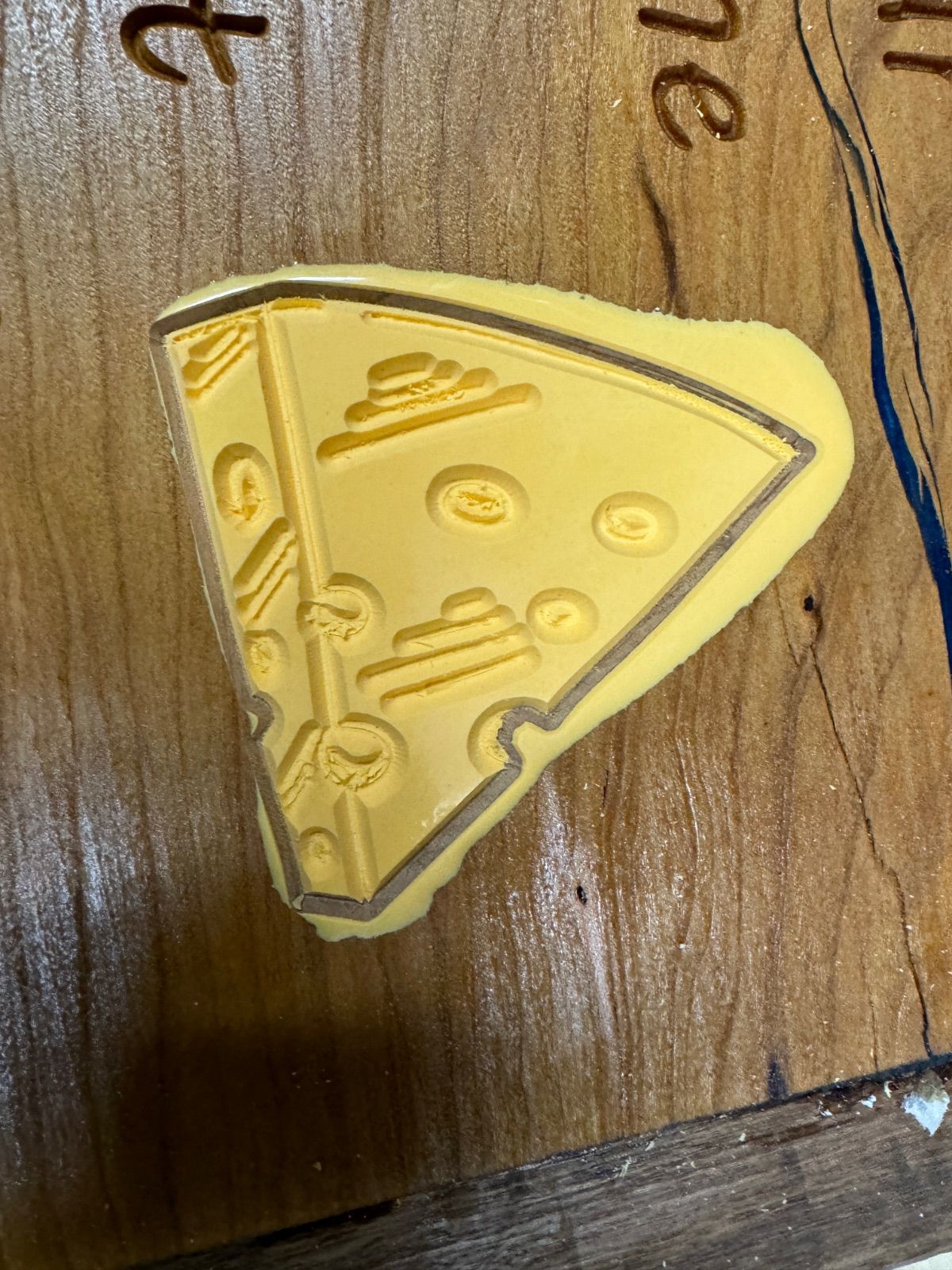

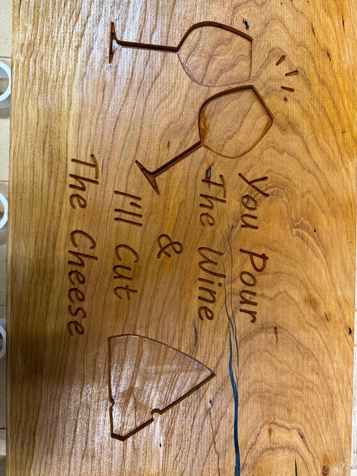

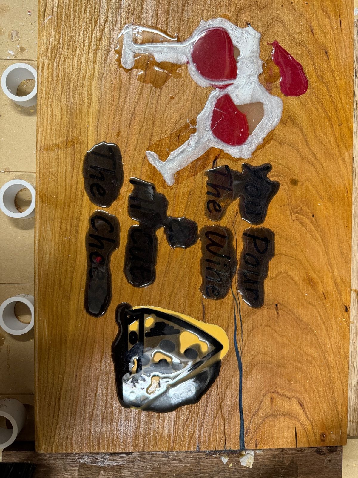

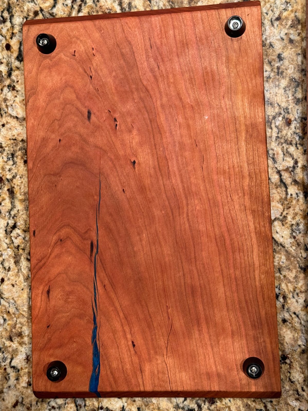

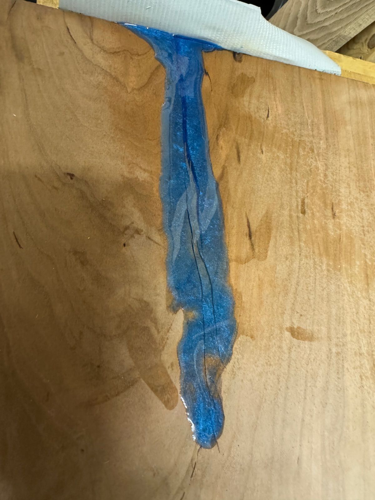

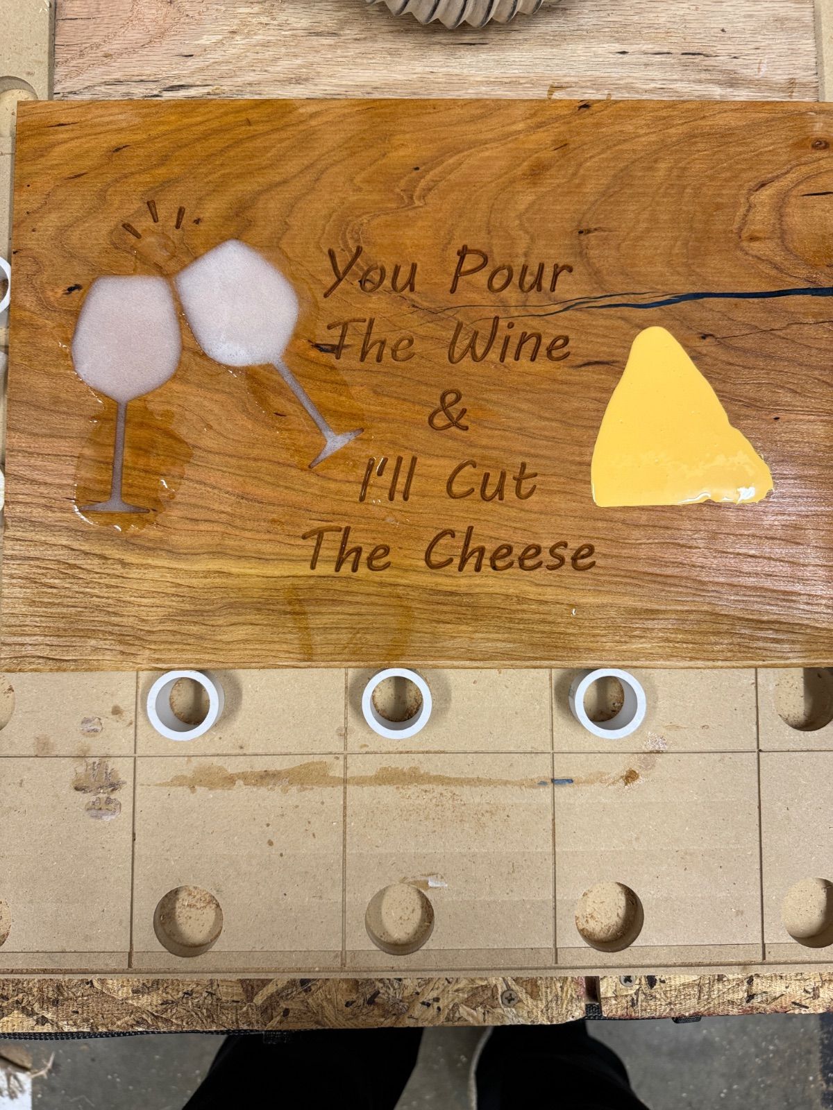

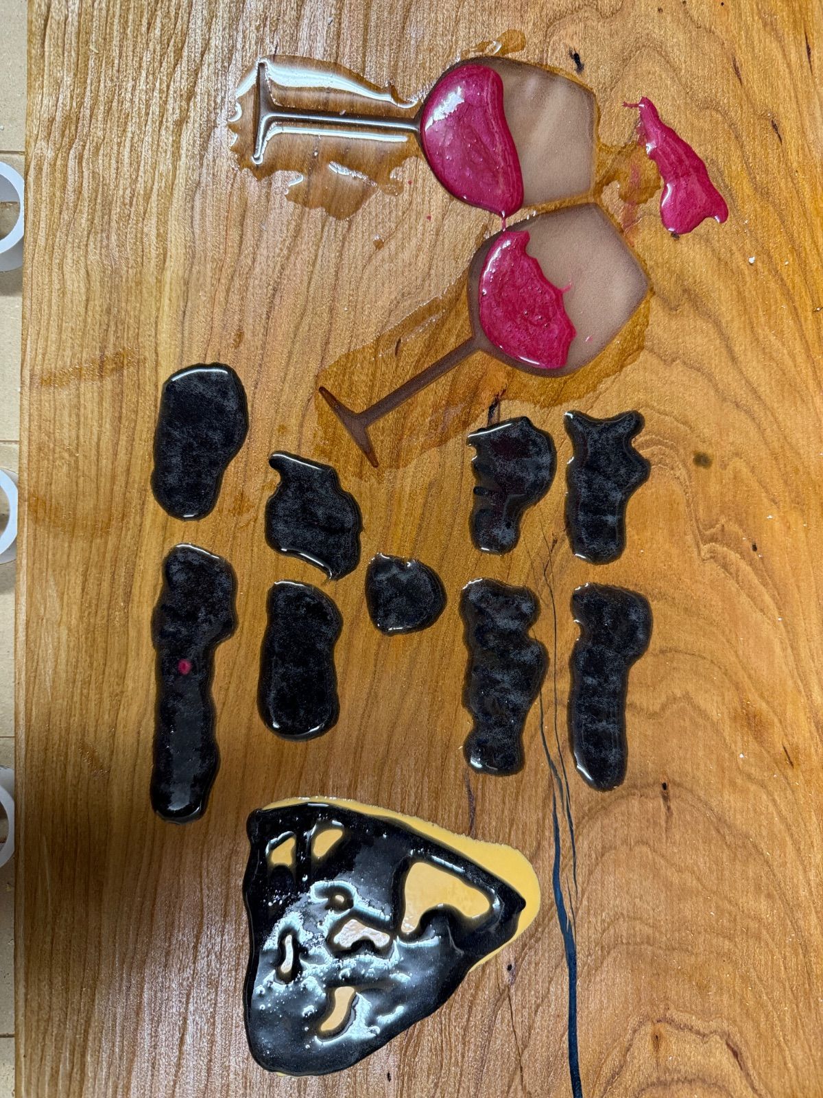

March 16, 20242 yr Popular Post comment_331829 My sister in law enjoys doing charcuterie boards. If you remember the family shaming incident she asked me if I could build her one. I found a nice cherry board I can maker her two out of. One large ‘formal’ one and then a ‘fun’ one. The fun one she just said ‘Have fun” They do weekly wine and cheese parties with a group of friend who I know so…Fun it shall be: Due to a crack I had to fill it in with epoxy. The I machined out the wine glasses, cheese and saying. I poured the yellow part of cheese and clear in wine glasses. This will help when I machine and do the red part of the wine. The next day I machined the wine and part two of the cheese and poured those two and the letters. Then following day the wine “glasses.” Surfaced and finished with Rubio with Mahogany coloring to finish off. also did an Ash end grain cutting board finished with Odies Report

March 17, 20242 yr Author comment_331879 3 hours ago, 4DThinker said: I believe you may be having too much fun now KevTN. Excellent work and I'll bet the client was delighted. 4D Thank you. It was fun that is for sure. I just made the noobie bone head mistake on the second one with a 3/4 bowl bit where I zeroed off the wrong thing and plugged 0.2 too deep. I think I recovered but I’ll have to talk to them. Oh well. Report
