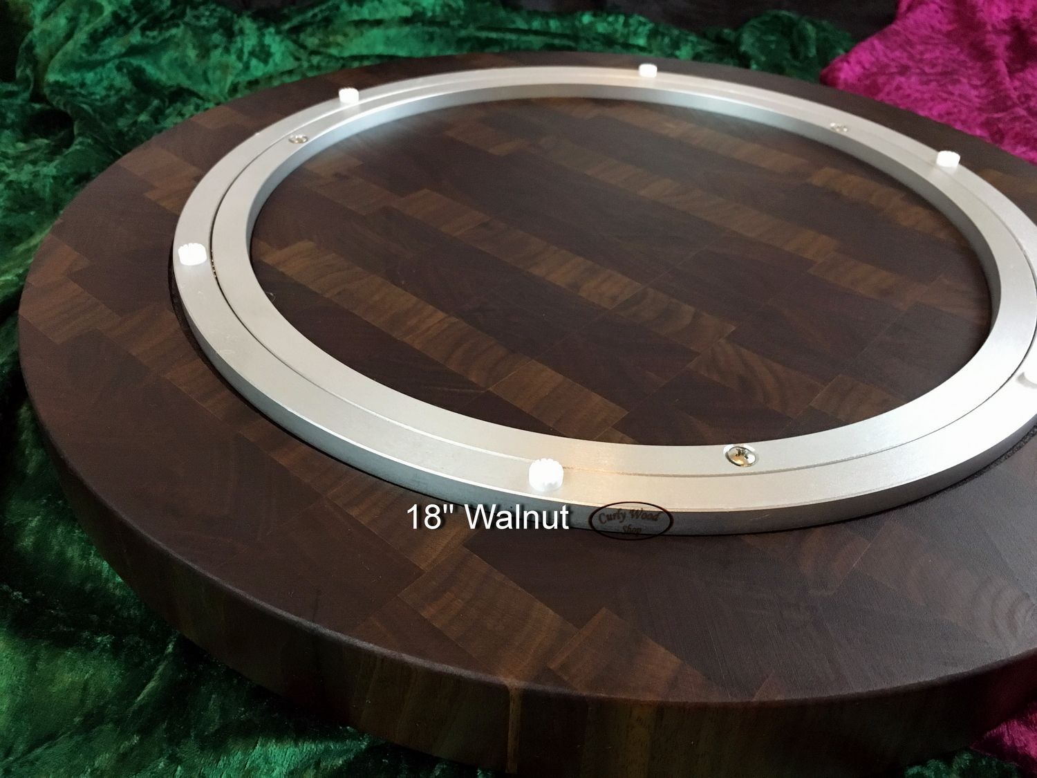

I use these very quiet, machined aluminum bearings and go as large as possible without the bearing showing so readily - https://www.amazon.com/gp/product/B071FL5QR3/.  For an 18" Lazy Susan I used a 14" bearing, if that helps (I've built several of these at 18").  I also route a channel for the bearing such that it isn't its full height and that helps it to be a bit more concealed.

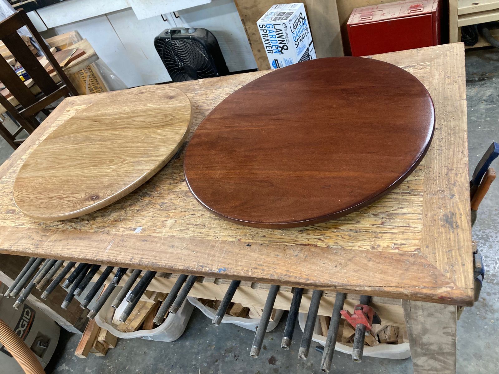

These are a couple I made that were 24" and I made the base 20". Sorry I don't have a picture showing the base and the mechanism I used.
Pretty sweet John Moody :TwoThumbsUp:
Very nice John!
