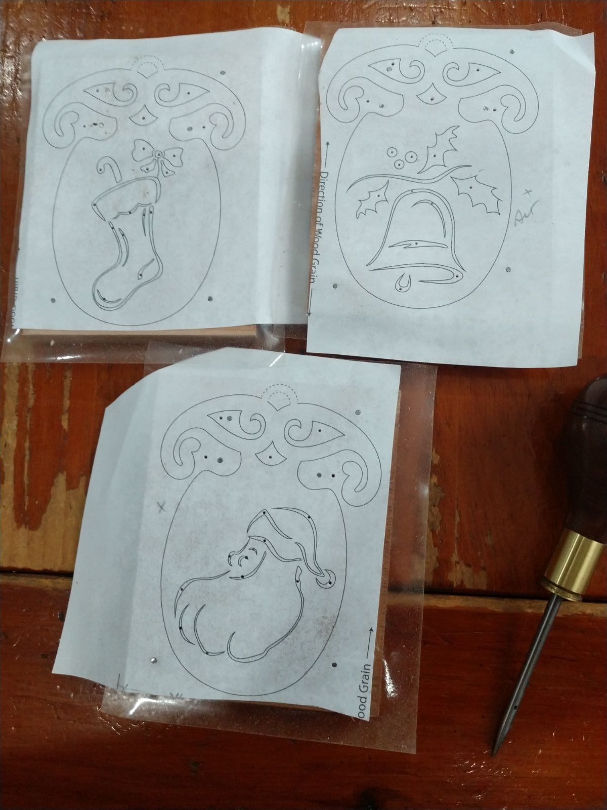

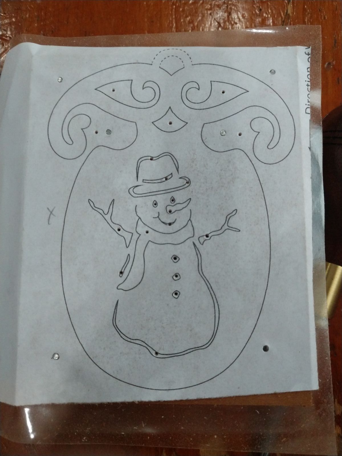

 Patterns applied and marked, ready for drilling & cutting.

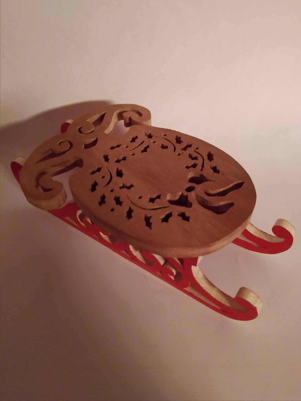

 Put the eyes to the test with the holly wreath. Leaves measure 1/4" x 1/8" wide.

Love it Bob. That is awesome. Your patience is amazing with that many blade placement moves.

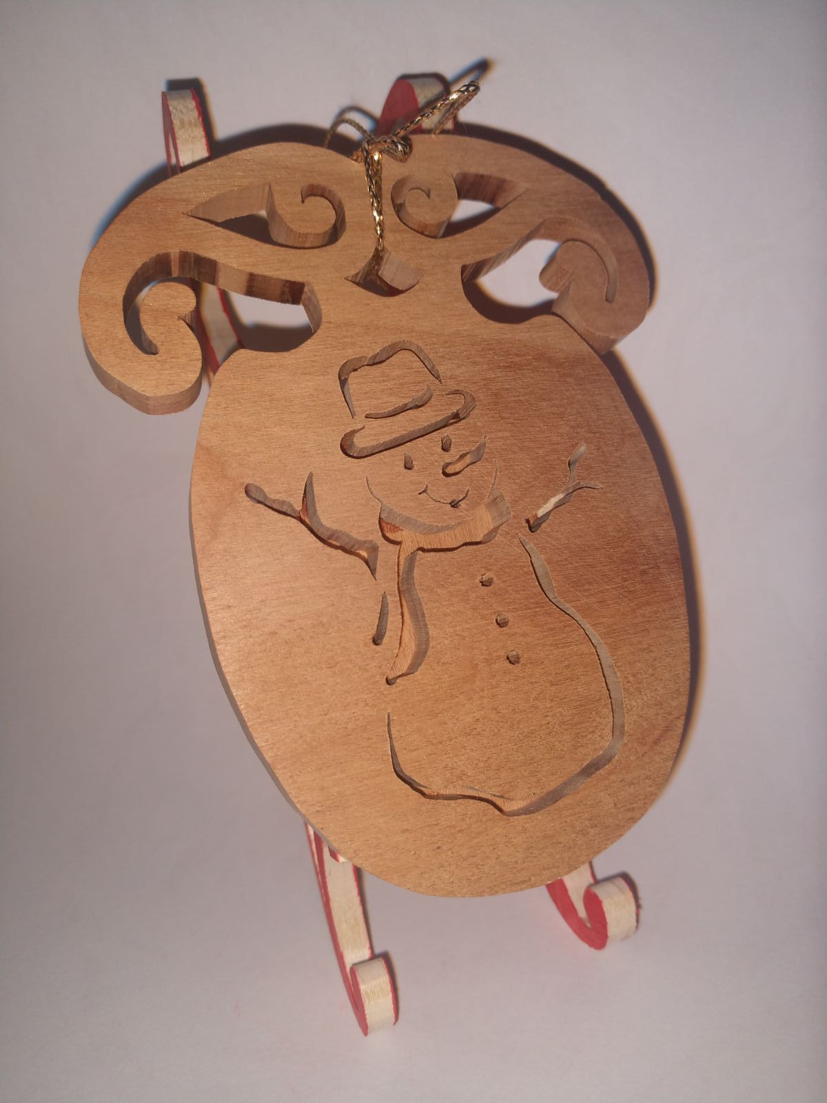

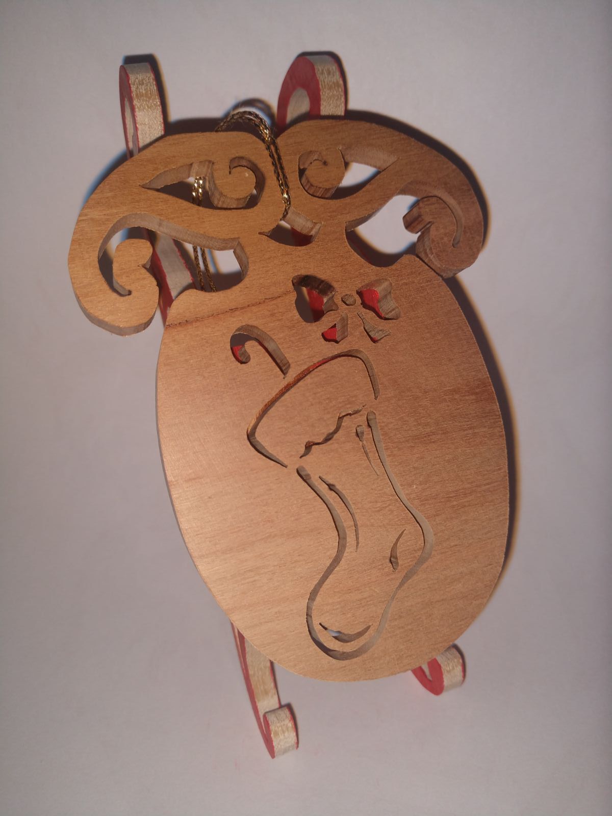

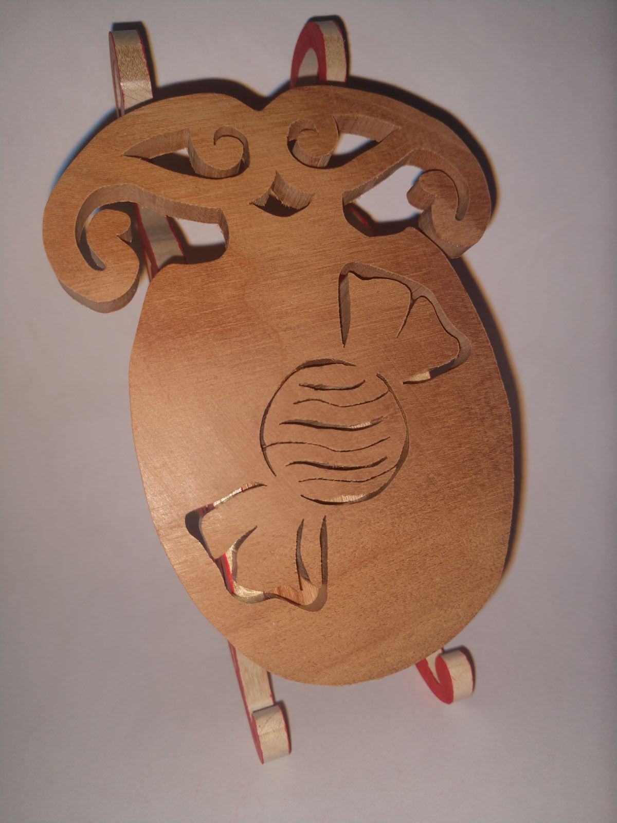

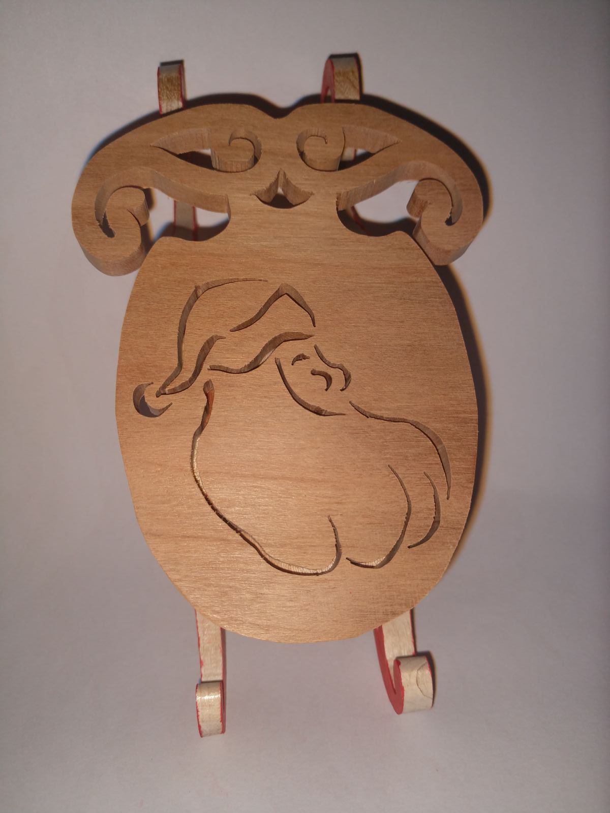

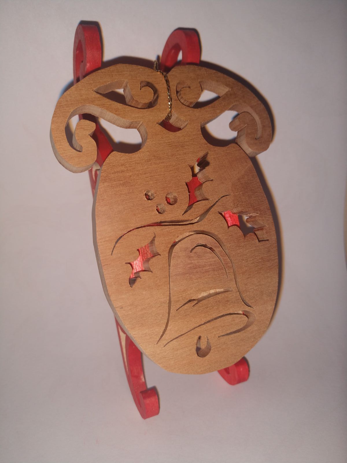

Very nice, Bob!

Ditto. Great cutting, Bob. Really like them. What are the sizes? How thick are they? What blade(s) did you use?

  I used 3/16 maple for the runners & 3/16 cherry for the bodies. Bodies are just under 4" long by 2 1/2" wide. #2 reverse tooth blade for the most part. Some of the finer cuts I used a 3/0 blade, the candy & wreath......

Thanks. A #2 blade exceeds this old man's visual acuity. The smallest in my stash is a #3. :OldManSmiley:
