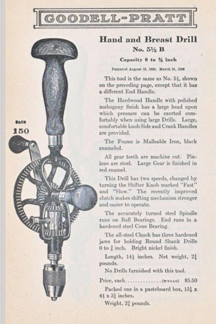

Looks like the side handle isn’t original, which would explain the square bolt head.  From the 1926 catalog.
Earlier version DID have that LONG handle...BTW..Chef's Hat came latter..
1907.  I still think the shape of the side handle calls it out as a replacement.
