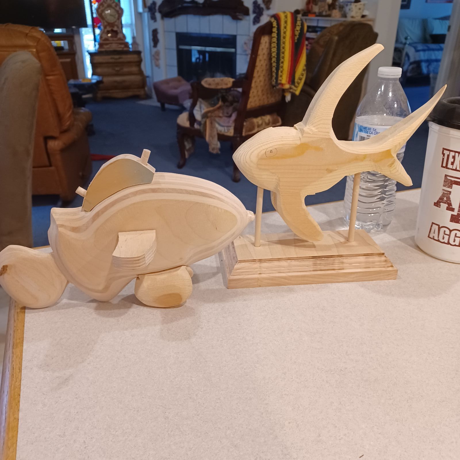

Found something different to get my little brain working on what a fish would look like.
Never done any thing like this so!
 I think I started with the easiest of the two. I"m using plywood for that will give me some extra lines to tell if I am removing the same amount of wood from each side. And yes it does work.

   And I kept thinking, please don't be the motor that has worn out or the box that has 4 capacitors for either could cost me a years salary or more but I first tried swapping the pressure switch with the other compressor sitting collecting dust and that fixed my compressor, hurray. So this morning I thought I would celebrate and make some fish.20231021_170925fish.jpg.c670c25d8840ab336efe3900cbd46d73.jpg

As for your latest projects...I don't know. Looks a little fishy to me.:rolleyes:

Great start on the fish neighbor, looking for more PIP's...
Really cute, Jesse.
Cool project Jess.  At the beginning you said you hadn't done anything like this... so, what did you learn from this project?
Cal good thought, I like the question..
 I like to take things apart so the  1 x 42" belt- disk sander can get most of the sanding. The thing I should have done was pre drill holes for dowels through the fins and into the body before I sawed the fins off.... . .
  I like to use plywood for the finished look on fish as it gives me lines to go by so I can remove the same amount of wood from each side. The other fish the only wood I had laying round about the right size was two  pieces of pine glued together.20231018_144358.jpg.b89fc9f44ef4adb88609432c486db5e3.jpgAnd sawing this guy out let me know pine was the wrong thing to use. Not strong enough and one can't get the wood sanded smooth enough for an accepted finish and I realized I went back on my word of not using pine wood for these types of things. The only thing I have used pine on was those flying ducks but they are glued on to a backer board so are not apt to be busted to pieces like a fish with no safety net around them . But still no more pine, ever.
