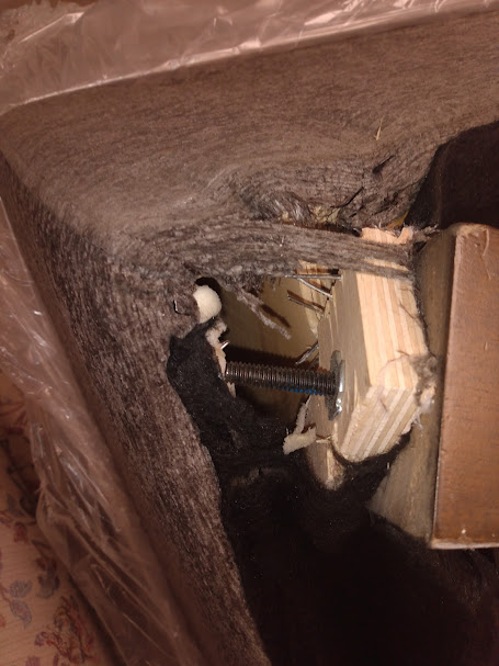

October 26, 20233 yr Author comment_323096 Another piece today, a heavy motorized recliner. A small block of 1/2" plywood pneumatically brad nailed into the corner to hold the front leg. No glue, no additional blocking, nothing. And wonder why it failed. FWIW, the motor also burned out and was removed. And a new method of attaching legs--a long hole into which a machine screw is inserted. So you need an extra long phillips head screwdriver to tighten it, after you have removed the cushion foot (assuming you know the hidden secret.) Another piece was a small end table with the blocks the leg screwed into came off. Again, no glue and the screw was only about 1/4" into the top. A hole drilled, then the screw inserted, then a threaded insert with no way to get it out. But there were a few pneumatic brads holding the apron to the posts. I think I'm glad I retired from the repair business, I'd hate to have to try to repair some of these under warranty. Report
