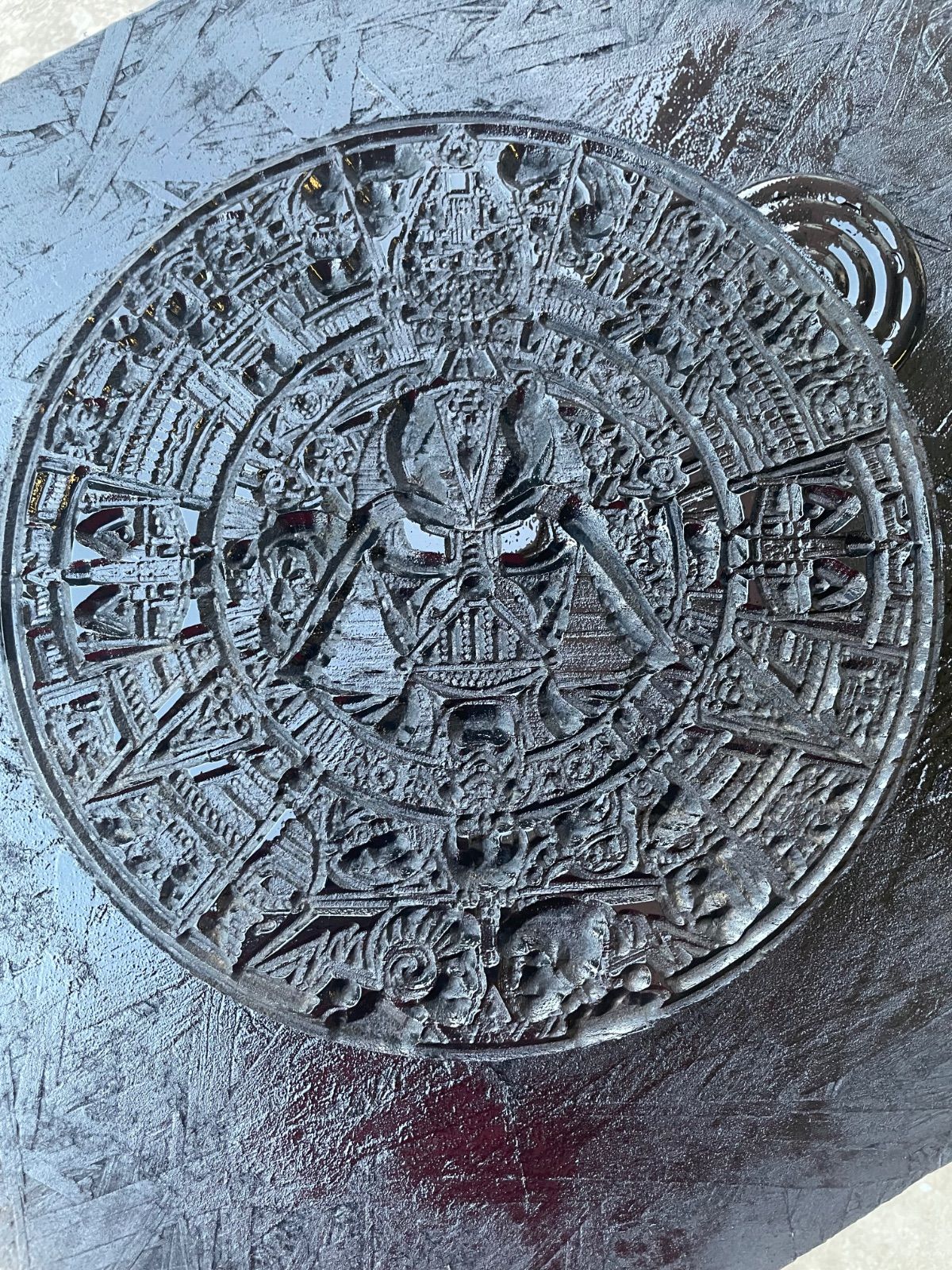

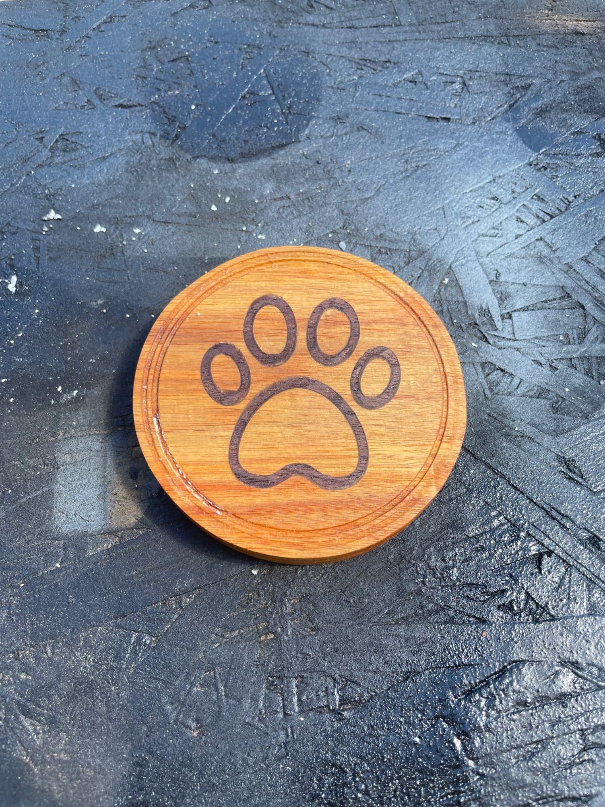

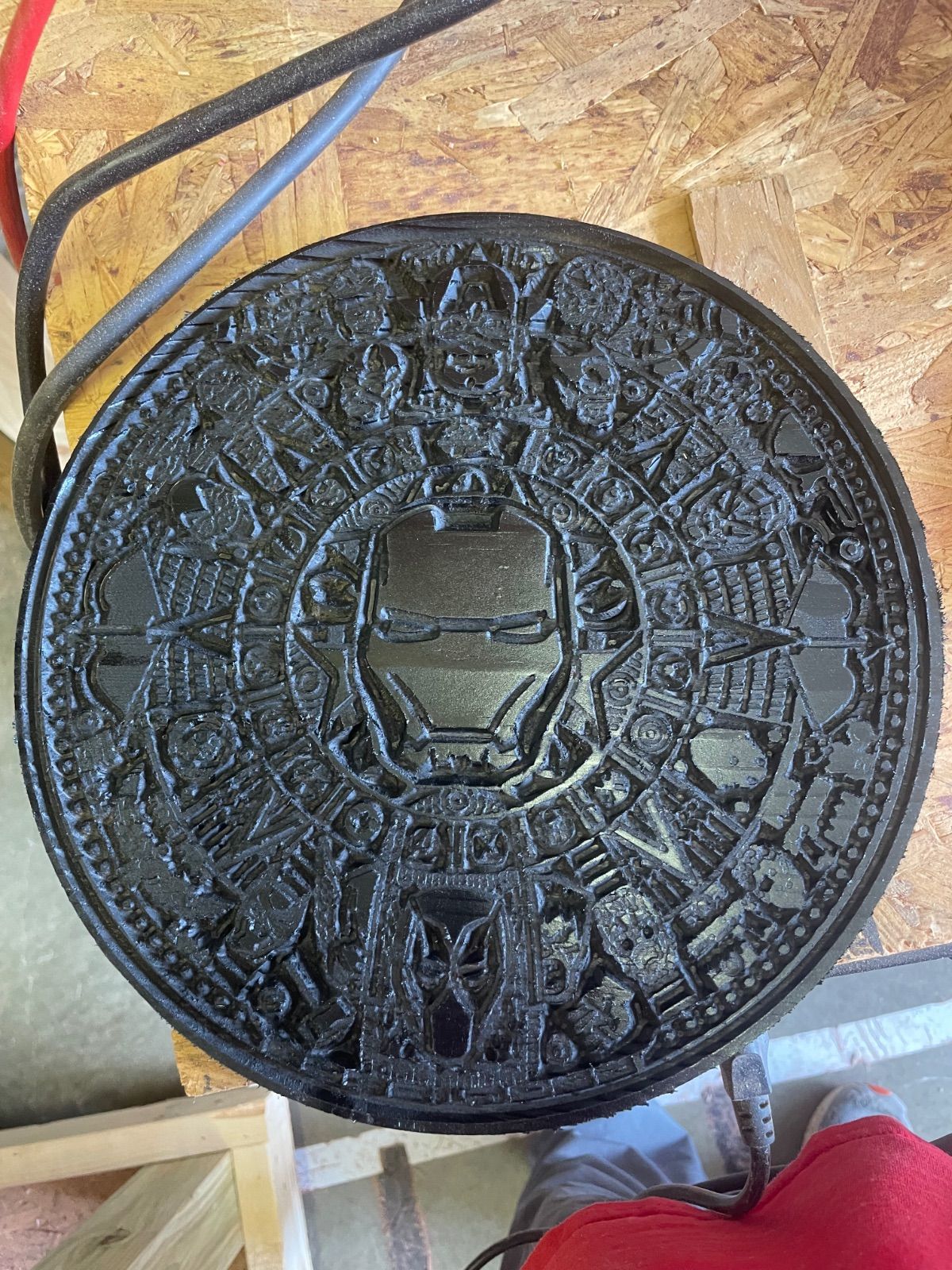

September 23, 20233 yr comment_321572 Things have been silly crazy. The three craft shows I was going to do cancelled. So I thought why now play around with what little time I had… I did a couple of Aztec calendars one with a 60 degree the other with a 90 degree using an old piece of pine. Tried to finish the Star Wars one with Rub and buff but I need a lot of work on that and repainted it. Also did a Millineal fight on a Melamine shelf piece I had. then last night I just bit the bullet and did my first wood inlay. I think it turned out pretty decent. Report
September 24, 20233 yr comment_321591 Wow! How long did it take that Aztec calendar to run? Awesome job on your inlay. Report
September 24, 20233 yr Author comment_321596 Grandpa the calendars took an hour 14 and 23 mins. The soft pine chipped out a bit too much with both 60 and 90 degree bits. ‘’Thank you for the inlay. Report
November 1, 20233 yr comment_323380 Never have found any pine that carved well. When I had a student project to carve (in walnut) I knew the V bits I had were well used, and so I bought a new high speed steel v bit to use for that project. Nicest cuts I'd seen in awhile. Determined that for any critical V-carving project a new bit was worth buying to ensure best results. If I was selling such projects I would just work the bit cost into the cost of the project. Report
