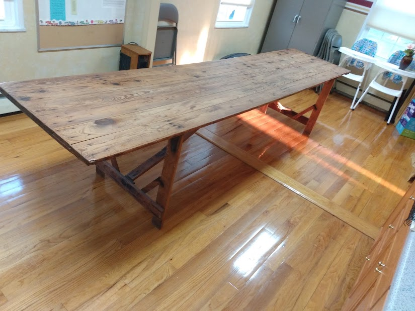

Here is one similar that is very old from my church made from who knows what.
Got a plug cutter?
The larger ones I've seen that seem to work best have double pedestal legs underneath...the 2-10' tables is a really good idea. Much more versatile.

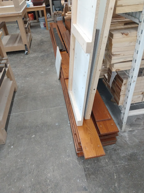

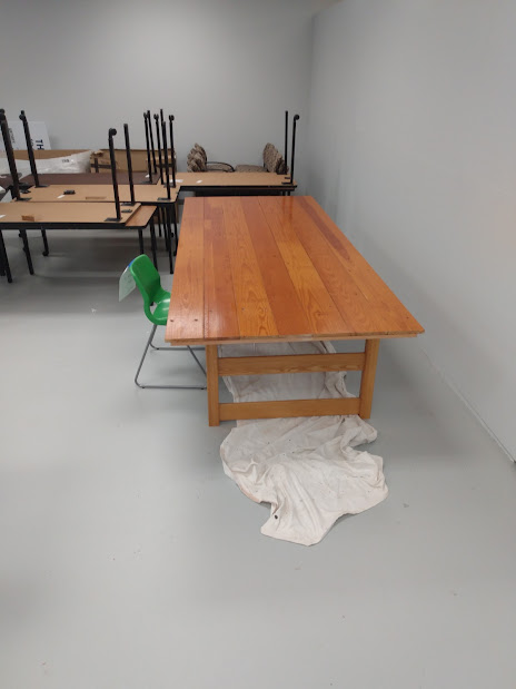

Got started today.  The goal was 48" wide.  Bunch of 7" wide boards 14' long,  a few 9" but they were pretty scuffed from feet, and some odds and ends in between.   We got the plan down.  Got one top put together.  We are repurposing some bunk bed ends for legs, and got the aprons cut.  The two of us will get together in a few days and work on the next one.
The stock pile prior to digging in

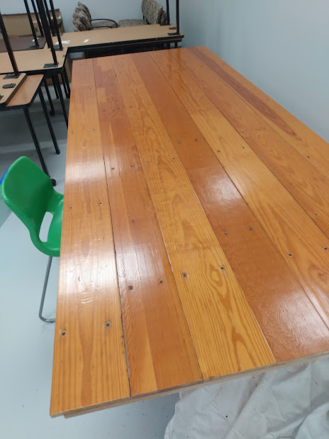

Got it together last week and scraped off the gum and did a cleaning.  Today filled the (65) bolt holes with walnut dowel plugs, did a scuff sanding, and put on a refresher coat of varnish.   Will need for the remodel to be done upstairs then  haul it up and screw the top onto the base.   The legs were made from dorm room bed head/footboards (salvaged), cut down to make a 30" high table.

I call it great Keith, nice looking table top.
What ever you call it, it's a great piece of work.
