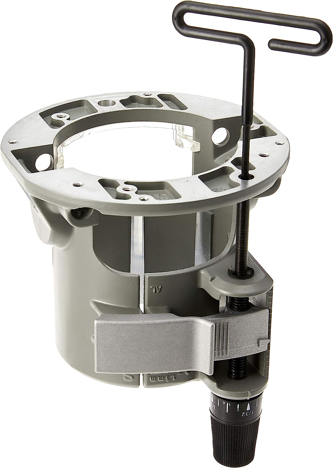

I got one of these last year and the newer models come with a hex drive that you can adust the depth thru a router table.  Well, I've been doing a number of things and on the next cut needed to change the depth a bit.   There must have been a lot of sawdust in the drive because when I tried changing it, it was not working right.  Took it out and found out the little retaining clip (External-E E-Clip) must have been stressed and popped off, so word to the wise, keep that thing clean and don't go beyond the stop.
