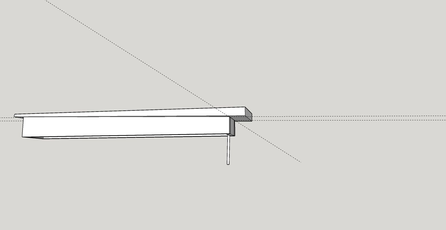

You could make an apron that compensated for the variations in thickness, then mount the legs onto the inside corners of the apron.
Edited by lew
Not as artistic as Lew's answer but mount 2x stock at corners on underside with hole drilled for dowels to fit . Just pull dowels to dissamble.
