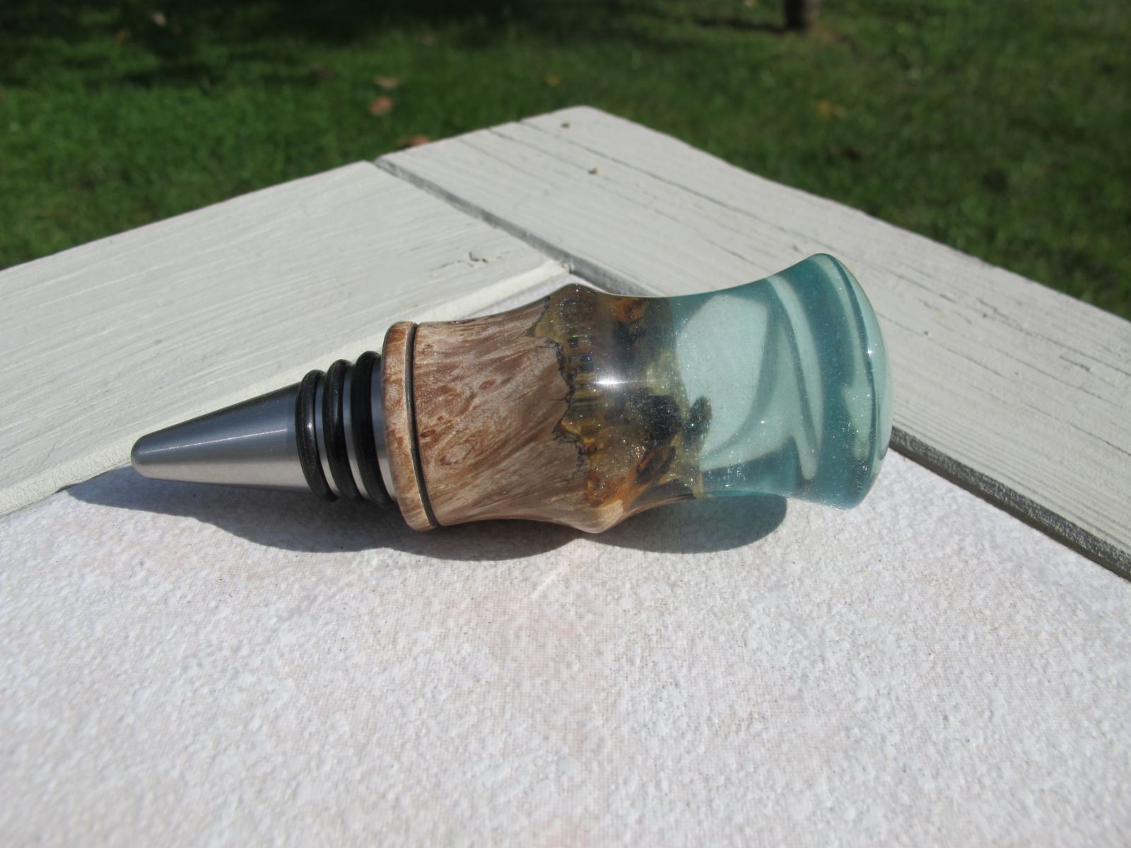

June 22, 20233 yr comment_316481 I made a couple of hybrid bottle stoppers out of acrylic/wood blanks. I sanded them (wood and acrylic) up thru all the MicroMesh Pads- mine went to 12000. Then used automotive scratch removal cream. That combination left a very nice finish. Edited June 22, 20233 yr by lew Report
