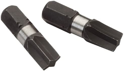

FWIW, most of the screws I have bought in the last 20 years (except for Kreg Pocket Hole screws) have come from wwhardware.com, Deerwood screws.  Unfortunately, they don't carry much but size #8, but that's 90% of what I use.  https://www.wwhardware.com/ultimate-square-drive-flat-head-screws-8-scus8
Forgot to mention, that I also hate the ones that are combo square and phillips, sometimes called Squipps.  They don't work well for either, but better for square.  I actually had a customer once that tried his phillips driver to remove a fastener and couldn't get it.  I used my square drive and amazed him.  My thought is that if you don't have the right screwdriver, you shouldnt be messing with it.   Electrical outlets sometimes have square+phillips+slot all in one.  Egad!   I found out recently that Milwaukee makes a driver and bits just for this mess of a screw head.  Sort of defeats the purpose, no?  Works on any, but you need a new bit to use it.
