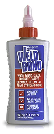

April 14, 20233 yr comment_312406 You may want to look into this too. I bought a bottle and it works well. Has a quick tack time and works on other materials too. Same consistency as the PVA wood glues. Edited April 14, 20233 yr by HandyDan Report

April 14, 20233 yr Author comment_312426 4 hours ago, HandyDan said: You may want to look into this too. I bought a bottle and it works well. Has a quick tack time and works on other materials too. Same consistency as the PVA wood glues. I will sometimes use Eclectic E6000 in a tube to glue non-wood and dissimilar materials. Wonder if Weldbond is similar. Report
