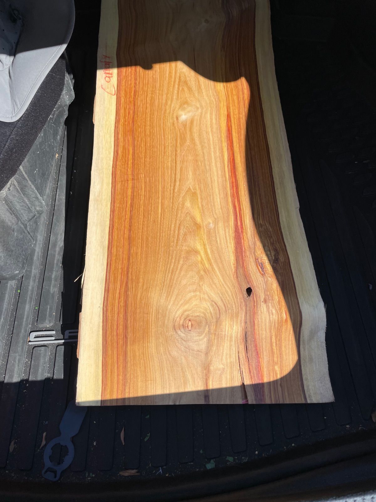

April 11, 20233 yr Popular Post comment_312279 Hey everyone… I hope everyone is doing well. not much softball season left (which is good in one way and sad to know it will be done forever) then I will get my weekends back…but I digress I am working on a concept for a friend of mine…. Can something be applied to MDF to keep it water proof? I am in near Hickory NC and swung by Klingspor’s Woodworking Shop and found this canary wood slab….I could not pass it up…lol Report

April 12, 20233 yr comment_312288 MDO is quite a bit lighter than MDF....and you'll never make MDF waterproof. But according to this website, 3/4" MDO is 2.2#/sq. ft., versus 3.16" sq. ft. for MDF. As for that slab of canary wood: YOU SUCK! Report

April 12, 20233 yr Author comment_312295 2 hours ago, Fred W. Hargis Jr said: MDO is quite a bit lighter than MDF....and you'll never make MDF waterproof. But according to this website, 3/4" MDO is 2.2#/sq. ft., versus 3.16" sq. ft. for MDF. As for that slab of canary wood: YOU SUCK! Yeah well you have made some really good deals that I didn't have a chance at so back atchya!! Thank you for website and information! I am hoping to start mocking some stuff up to be able to show what's going through this minimal grey matter of mine. If I would to route the MDO into a sign does that take away any of the water proofing? Edited April 12, 20233 yr by KevTN Report
