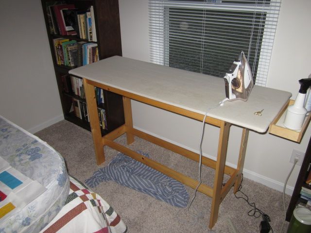

February 2, 20233 yr comment_307778 After spending about 8 hours over the period of a few days, my attempt to refresh my wife's roughly 24"x60" ironing board for quilting didn't go as planned. After removing the old coverings and tons of staples, then flipping over the 1/2" baltic birch sheet, I added the following layers: Formica aluminum foil to repel the heat fiberfill padding silver glossy fabric meant for ironing boards fiberfill with some reflective stuff inside a quilted padded back silver layer of fabric It already bubbled up somewhere inside. I'm thinking the heat got to the Formica contact cement. I don't know what to use that would be impervious to heat and steam. Any thoughts? I don't know if I could cobble something together from steel studs or if that is a crazy idea. Solid wood might work, but the edge glue would probably undo under the steam and heat. Report
