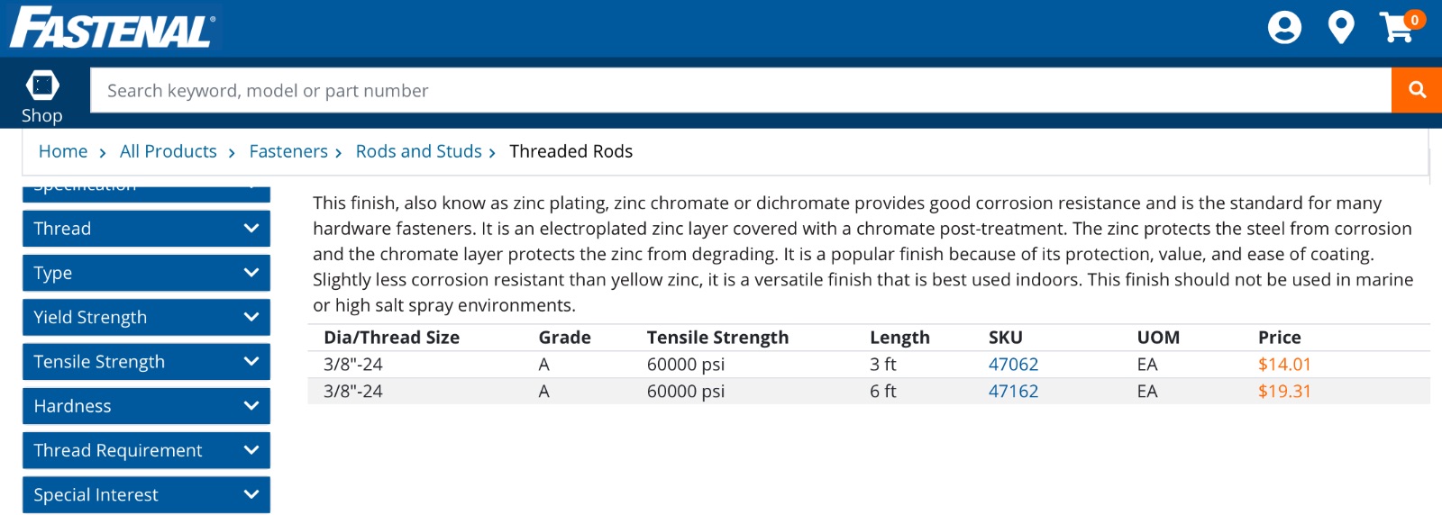

January 24, 20233 yr comment_307133 Anyone make a hand held drill chuck holder? Instead of putting the drill chuck in the tail stock to bore a hole, you mount the drill chuck on a handle and use it free hand. Well I'm trying to find an inexpensive source for the threaded rod to hold the chuck. 1/2 x 20 tpi and 3/8 x 24 tpi. Do these convert to a # instead of a diameter? the rods that I've searched for on line want a fortune for a pack---I need one rod each. Ace has the correct BOLTS but I was hoping to get more of the stock into the handle for a better margin of safety. Also did you use Lock thread on the threads? (red or blue) ?? Report
January 24, 20233 yr Popular Post comment_307137 Fastenal has this. Maybe another fastener store closer to you ? Report

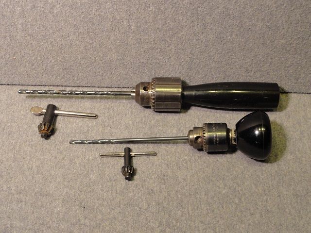

January 24, 20233 yr Popular Post comment_307151 3 hours ago, smitty10101 said: Well I'm trying to find an inexpensive source for the threaded rod to hold the chuck. 1/2 x 20 tpi and 3/8 x 24 tpi. Use a bolt and cut the head off with a hacksaw. Box stores should have them individually for pretty cheap. Mine are plastic. One is a knob from an old tractor and the other is the auxiliary handle from a drill or right angle grinder. Used bolts for both. Report

January 24, 20233 yr Author comment_307153 5 minutes ago, HandyDan said: Mine are plastic. I am hesitant to use a plastic thread. In my mind it just didn't seem strong enough. 5 minutes ago, HandyDan said: Used bolts for both. I felt that the bolt wouldn't be long enough to offer a safety factor. Edited January 24, 20233 yr by smitty10101 Report
January 24, 20233 yr Popular Post comment_307156 23 minutes ago, smitty10101 said: I am hesitant to use a plastic thread. In my mind it just didn't seem strong enough. The handles are plastic. The bolts that hold them to the chucks are steel. Bolts come in long lengths. A 3" bolt can be epoxied 2 1/2" deep in the handle. File some grooves in the bolt to help the epoxy lock it into the handle. No matter how you look at it if you get a catch you will let go before the wood does. If you let go the bit will break before the wood lets go. Edited January 24, 20233 yr by HandyDan Report
January 24, 20233 yr Popular Post comment_307157 26 minutes ago, smitty10101 said: I felt that the bolt wouldn't be long enough to offer a safety factor. Add a ferule to it. Most turning tools only have the steel 2" to 3" deep in the handle. Report
