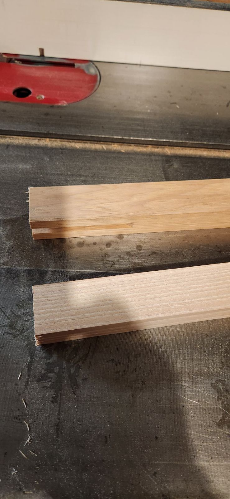

I made a jig for the table saw for the slot  for the 1/8 aluminum. I had to catch myself as I was running the wood in the wrong direction. So I had to fix a few.
