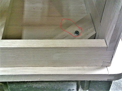

December 15, 20223 yr Popular Post comment_304294 A trick I learned long ago, from Norm Abram... Involved a series of blocks.. Imagine this at the tops of the leg aprons.....not only does this hold things square, but By using the drill to mill a slot, you can screw a top down. The slots allow for the top to expand and contract as it sees fit. Be sure to add a thin washer under the head of the screw, to help allow the screw to slide. To drill a slot with a drill: Drill a hole first..then rock the drill front to back a few times until a slot appears....I usually mark a line to follow, front to back, with a square.. Report
