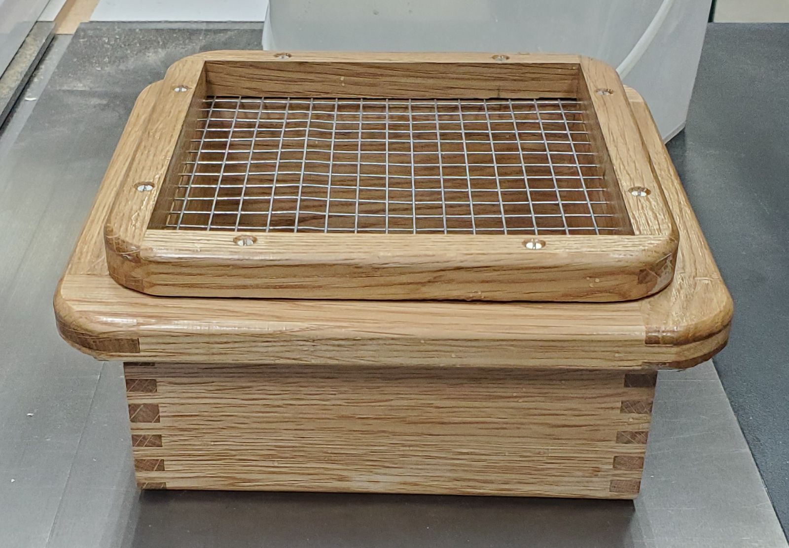

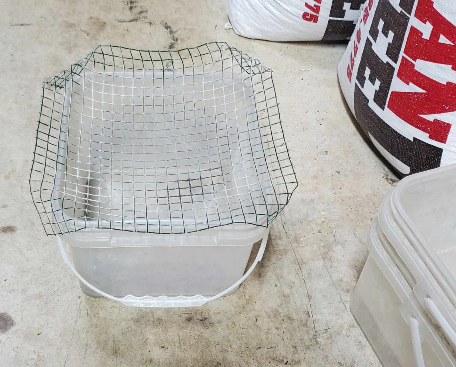

I feed the deer year round and have to sift the corn to get the stray cob out otherwise they will jam up the feeder. My first sifter left a bit to be desired, spilled corn, corn bouncing out on the floor and well it's pretty ugly.
I wanted to practice bridal joints so I used them to make the bottom two parts of the Cob Sifter Mk2. The upper part was made using a center pin box joint. I didn't have any molding the right shape so I made some. I tried brass screws to hold the bottom and the screen on but after two breaking off I gave up and tapped the holes for machine screws. I finished with shellac. The buckets I use I call Charlie Buckets because Charlie used to work at a local lumber yard and he would bring the empty nail buckets home.
And yes there is a few spots that I missed with the shellac but I've touched them up... and yes I clocked the screws!

Custom fit to the Charlie Bucket too.  Perfect!

Hind sight being 20-20 I should have rounded the ends of the molding to match the part below I think...
JT

I did round the corners of the molding with my carving tools and I like the softer look of the corners.

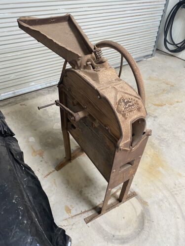

Growing up on a third+ generation farm, we had a hand-crank machine for that.  Something like this one
Not this one

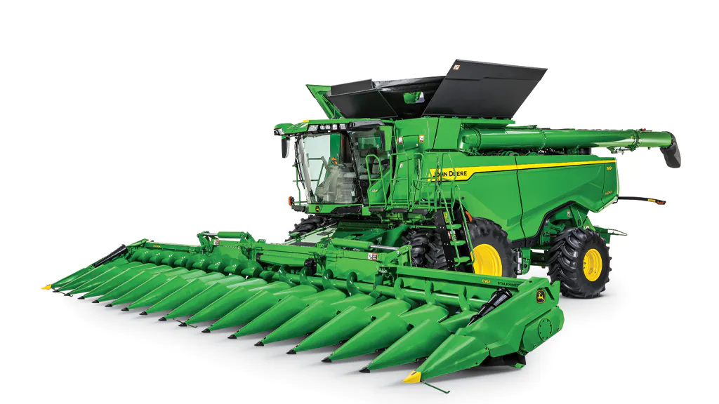

Wow, did I count 16 rows on that corn head?????????????
Around the corner from me is a large field normally planted in soybeans, I would guess about 200 acres that's farmed by a seed company.  It gets planted in one day.  A while later, they spray herbicide.  Then in the fall, they harvest in one day.   The machines are huge.
Yep. There's a few around here with them but most still use 8 or 12 rows. Pretty common to see 24 row planters now though. Common to see 24' and 30' grain platforms too. I remember when the "big" farmers had 6 row corn heads and 12 row planters. I thought we were something when we got a combine that had a cab and heater. Dad wouldn't let me put a radio in it though. All the gravity wagons, flatbed wagons with hoists and grain truck with side extensions we owned wouldn't hold the corn the grain hopper on that one holds.
