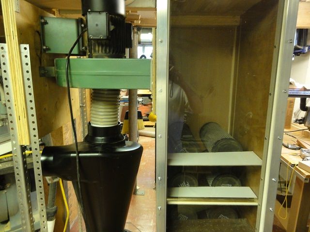

November 24, 20224 yr comment_302826 I'm a poor one to comment on proper dust collection as my system is woefully inadequate. I have a Delta upright collector- filter bag on top and plastic collection bag on the bottom. I hate to empty the plastic bag. I found plans for a Thien separator using a metal garbage can and the plastic lid from Woodcraft. All but the finest dust goes into the garbage can. Probably only empty the bag once or twice a year Report

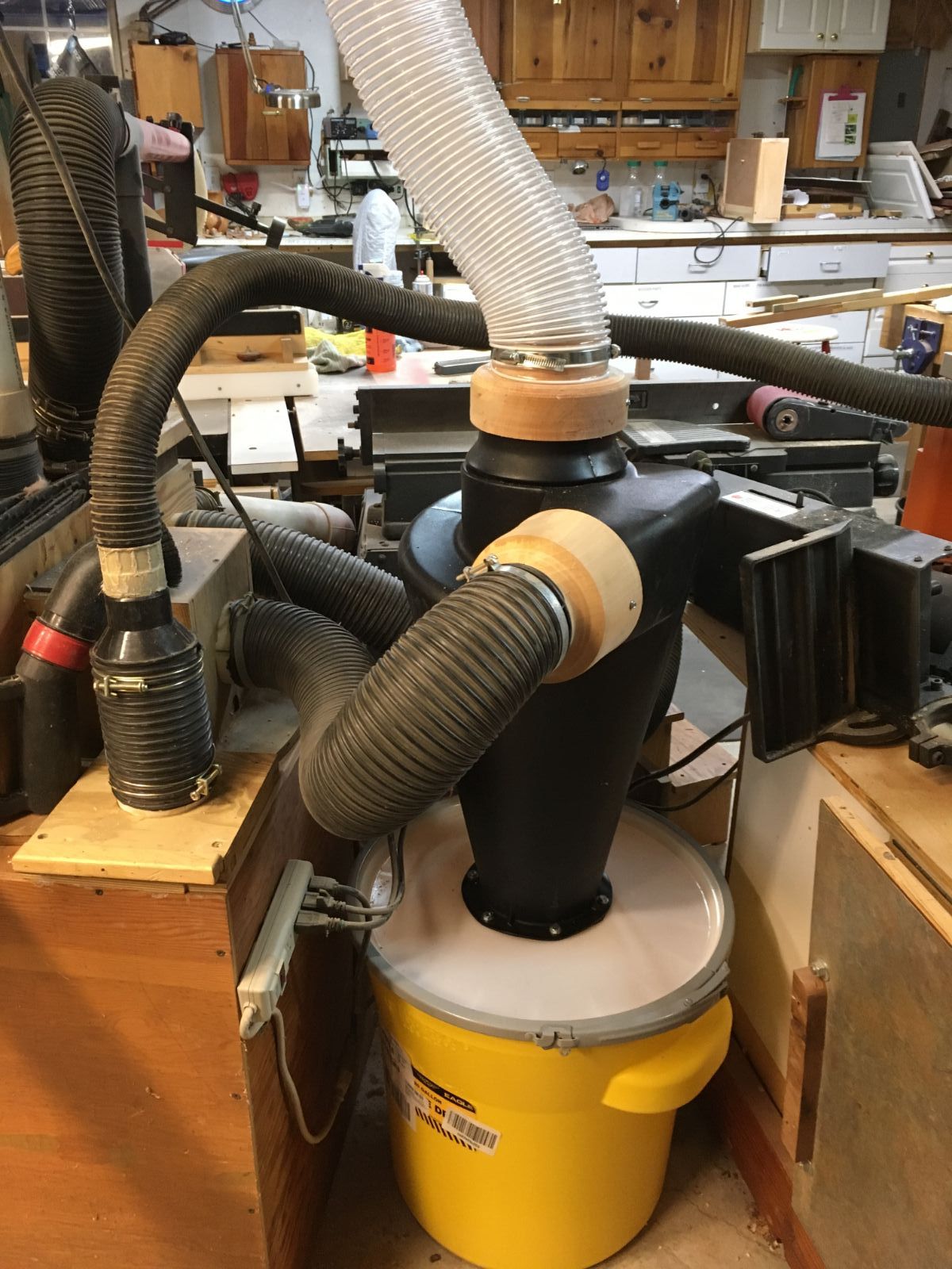

November 24, 20224 yr comment_302845 I did a system like Danl described in his post. Mine is mostly the same, except not as pretty. The cyclone takes care of most of the dust with very little in the final bucket. I used the original HF base and built up from there. The 10 mil pvc tape worked well on the joints. Big improvement over the out-of-the-box setup. Report
November 24, 20224 yr comment_302848 Mine is roll around unit. Has the large Dust Deputy which is well worth the money. Report

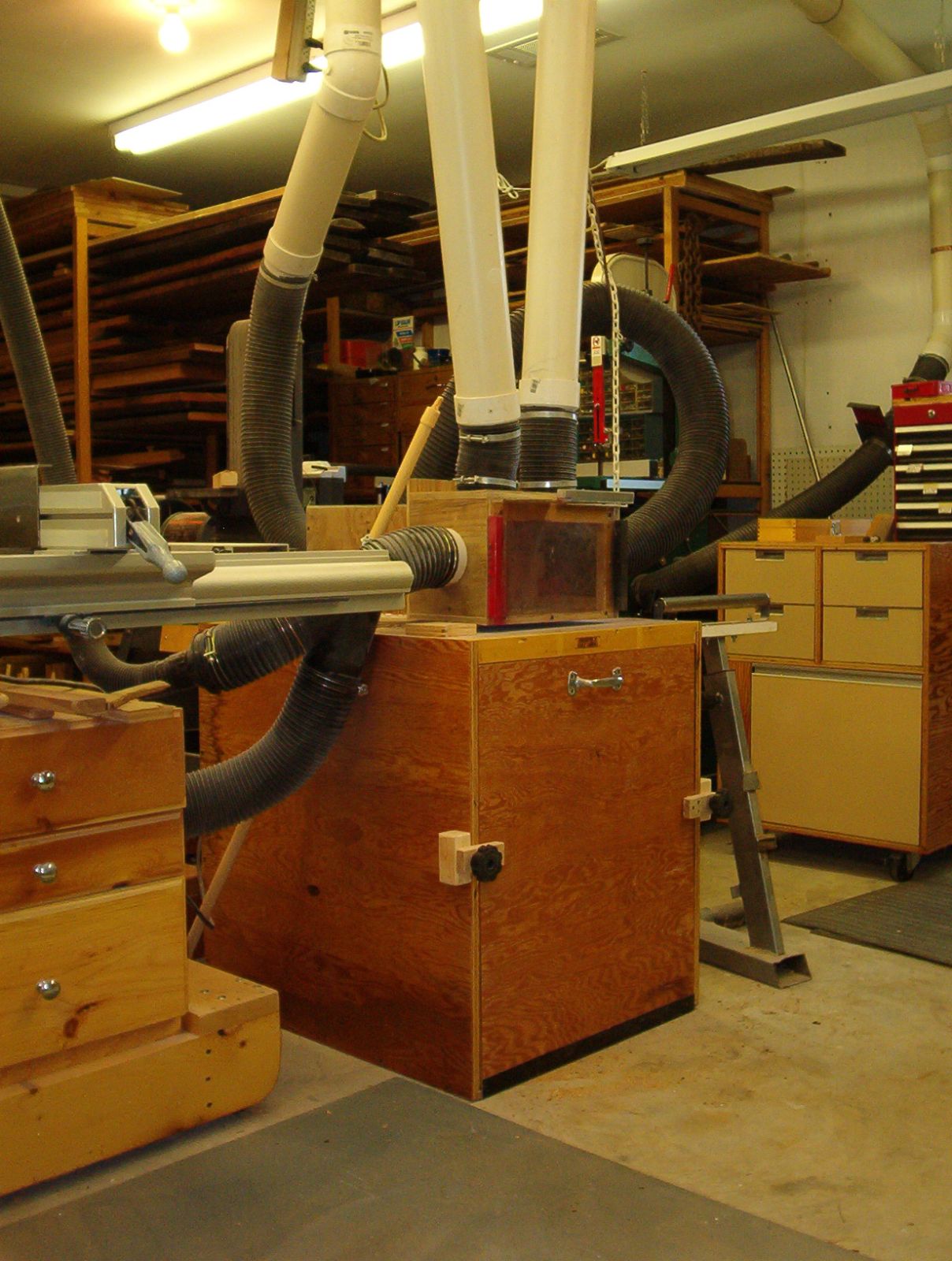

November 24, 20224 yr comment_302863 I built a box from Shop Notes plans And recently added a 5 inch Dust Deputy Report
