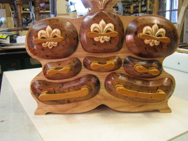

November 1, 20224 yr Popular Post comment_301450 I sold this box the morning we put it on display at a show and don't remember if I posted it here. I took about 12 panels all ready glue up and was ready for the patterns as I don't like to install patterns until I get ready to saw the pattern out. A lesson learned there! I used 12 panels all 3/4" thick for the body and only sawed out the interiors of 10 panels and the other 2 was for the clamps for each end.. This was on a vacation and I screwed up one pattern gluing it on so we went in to South Fork to the library and I printed another pattern ...I never use any of my original patterns for I put them up in case someone wants one like I've already made. This is where I found out one printer doesn't always make the exact same size as the original from another printer and after I sawed out that last piece for the body I found it was about 1/16" shorter both directions of the others I had already sawed out... From the very first band saw box I built I realized the blade was making more gap between boards that by the time I had sanded every thing smooth, I ended up with way bigger gaps than I wanted. So I only built one band saw box. So the way I glued each panel to each other I used 4, 1/8" dowels between each panel. This meant I could only glue one panel at a time then wait till the was dry before I could drill four new holes to make that panel match up with the last one glued. The fronts and the backs of each drawer was the last things after I made sure all the sanding was completed. I used ash for the body and mesquite for the drawer fronts. To get the two toned ash wood on the outside I taped off areas and used the air brush to make it look like the wood was stained before I glued them up. The drawer pulls are glued up bamboo for flooring. Report
November 1, 20224 yr comment_301485 Love the contrasts of the woods and grain. Your imagination and creativity is amazing Patch. Report
