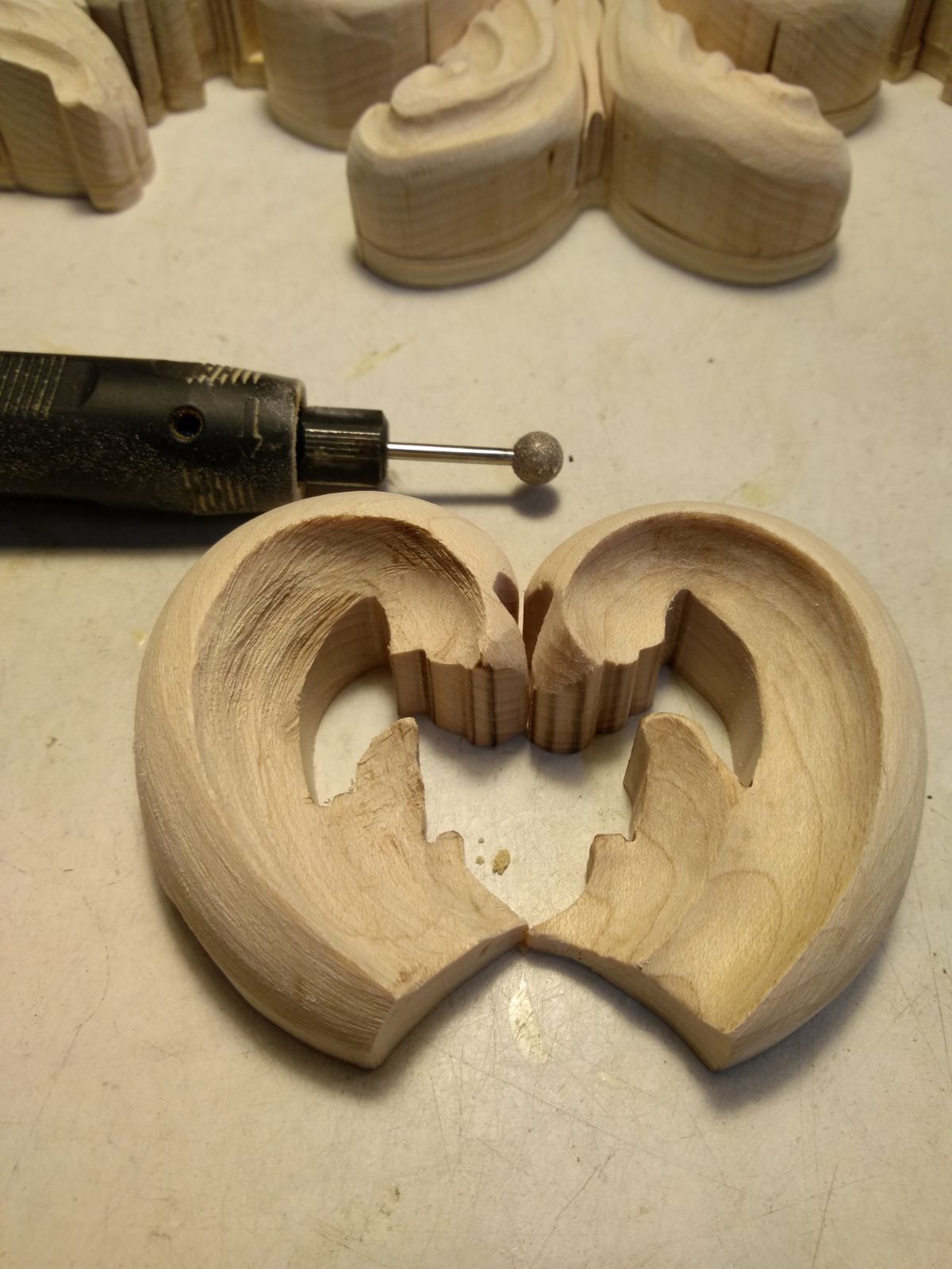

September 17, 20224 yr Author comment_298791 Cal most all the smoothing of the inside valleys are done with three or four bits. The ones with round bottoms. I cut the Dremel back to about #3 and use small circular motions. So its mostly ruby and sapphires and I do use the 217203 which is diamond but with 3/32" bits and the Dremel comes with different size mandrels If you have a Wood Carvers Supply catalog the only set I bought in 2016 was 881004 , 150 grit and maybe should have bought the 881005 which is 100 grit and the diamond bits. Strange for the diamond bits I could use don't come one at a time except that last number Page 8 shows the ruby and sapphire bits so I use #'s 217304,217308, 217310 and 217312 which are 3/32 size bits. These four bits with the one diamond bit is all I ever use. Amazing how the 1 x 42" belt sander with me applying pressure to the inside of the belt can get more done quicker than all the3 other machines. The Saburr bits are for grinding all the inside valleys. 259401,259202,259462, 259363, 259393, 259395. These numbers are the green colors which are course and then switch over to the diamond, ruby and sapphires. I did buy a couple of sets at first but there are still some of them that hasn't been used. Yes , when I first started playing around with carving attempts I thought I needed the very course 1/8" bits but they will get you hurt real quick like on the bottom of page 10 of their catalog, like # 629529 The things I carve I have no need for those very very high speed carving machines that cost an arm and a leg. They might be to carve eggs but they would catch my maple on fire and I done smelled enough smoke way back yonder! Report
September 17, 20224 yr Author comment_298794 I just wonder how long it would take to make these two curly ques if a person only had carving knives These still have to be smoothed with the diamond or ruby or sapphire bits. Report
September 21, 20224 yr Author comment_299066 This is the bit I use to smooth the inside curves of all my carving stuff. The bits are either 3/32 or 1/8" diameter shafts and the diamond, ruby and sapphires bits all look the same to me and over the years they get mixed up so I just use what ever I reach in and get and if it don't do the job like I want , replace it for another. The outside curves I use the triangled shaped pad on the Dremel multi max sander #6300 which probably been replaced by another number by now. It was bought when I was doing lots of remolding and is a life saver for that type of work with the little flat blades with the saw teeth on one end. Then one day I said to myself hey, I got another sander that might take a lot of the labor of hand sanding and shorten the time I spend on sanding. The triangle shaped pad lets me get into smaller places that the da's or random orbits and the larger flat electric sanders can get into.. I saved all the flat saw blades that were worn out and now I grind off the saw teeth and use stickit sand paper for those little flat areas fingers can't get to. This picture shows me I need to do more sanding along the edges to take out more sanding marks and to straighten the edge lines which will make a world of difference of peoples acceptance to ones work. Report
