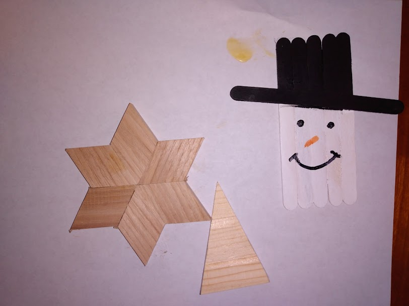

September 2, 20224 yr Author comment_297829 Well SWMBO came home and liked the snowman prototype the best. I was looking at doing a 5 pointed star but unsure if I had a safe way to cut the parts Report
September 2, 20224 yr comment_297855 Thanks for the follow up and pic Keith. That snowman looks simple enough that I can do this with the nephews - ages 5 & 6. Report
September 2, 20224 yr Author comment_297871 2 hours ago, Cal said: Thanks for the follow up and pic Keith. That snowman looks simple enough that I can do this with the nephews - ages 5 & 6. the only problem I had was there was some curvature in some of the craft sticks. I needed to joint them to get a gap-free glue joint. And, no, I didn't use my power jointer, I clamped a hand plane in a vise and skimmed off the edge. Report

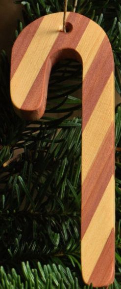

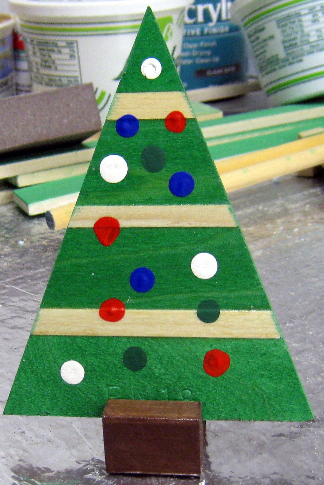

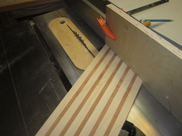

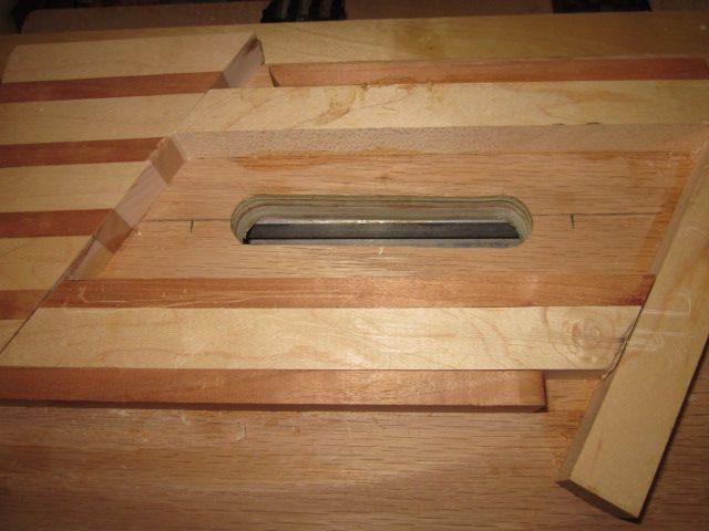

September 2, 20224 yr Popular Post comment_297899 bloodwood and maple pine hobbyboard (1/4"). hole in top for hanging, and little brown block for table setting. I used dilute water based paint as the green dye; layup the stripes in long boards, then cut at angle. Report

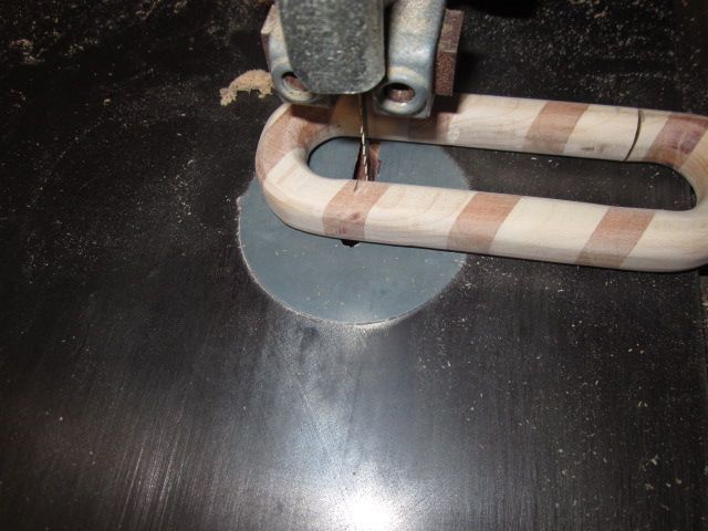

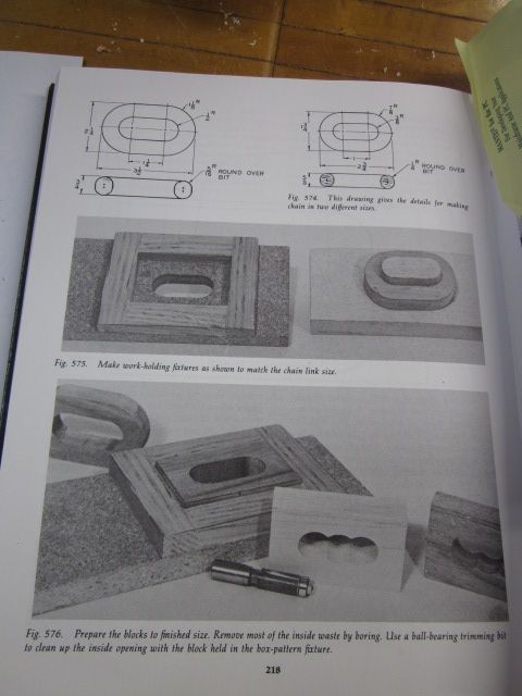

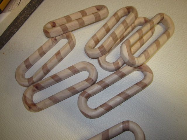

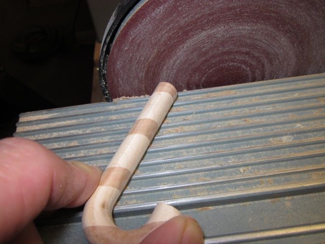

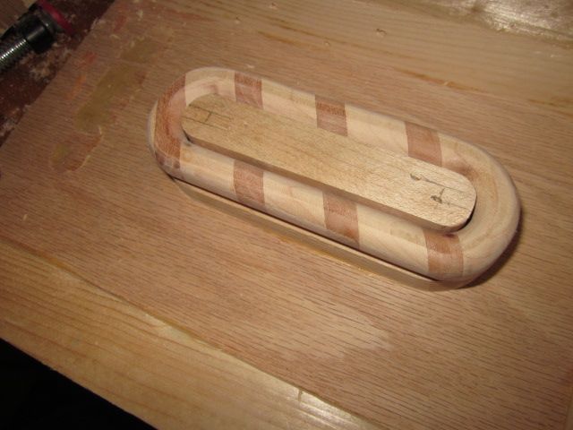

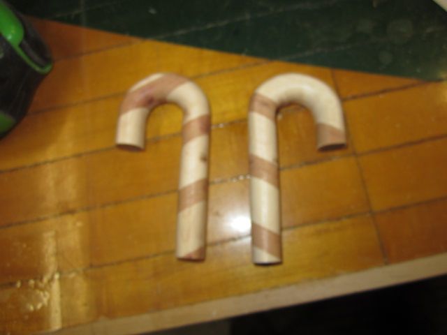

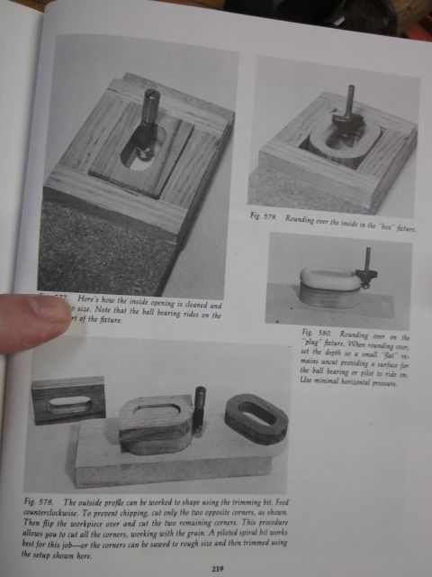

September 6, 20224 yr Author Popular Post comment_298220 On 9/2/2022 at 10:53 AM, PeteM said: bloodwood and maple pine hobbyboard (1/4"). hole in top for hanging, and little brown block for table setting. I used dilute water based paint as the green dye; layup the stripes in long boards, then cut at angle. Thanks for the ideas. I did some candy canes a few years ago, cherry and maple. I used a jig described in a router book to make links for chains and just elongated it. Then I cut the "link" into two canes. Report
