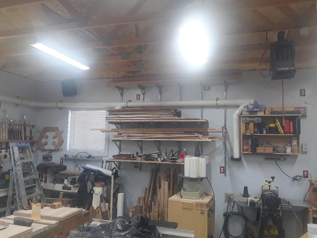

July 17, 20224 yr Author Popular Post comment_294743 I'm a gonna get some pipe up today, and will get some pictures, think i can get most of main run up, and do drops later, gotta fab some temp hangers, and ab the stand offs, want main run an 1.5'' off wall, to pass over heavy duty shelving brackets and accommodate the angles so not absolute 90 degrees. and of course the required run to the big box store to get ''mo parts'', happy sunday, glad to be here Rj in az Report

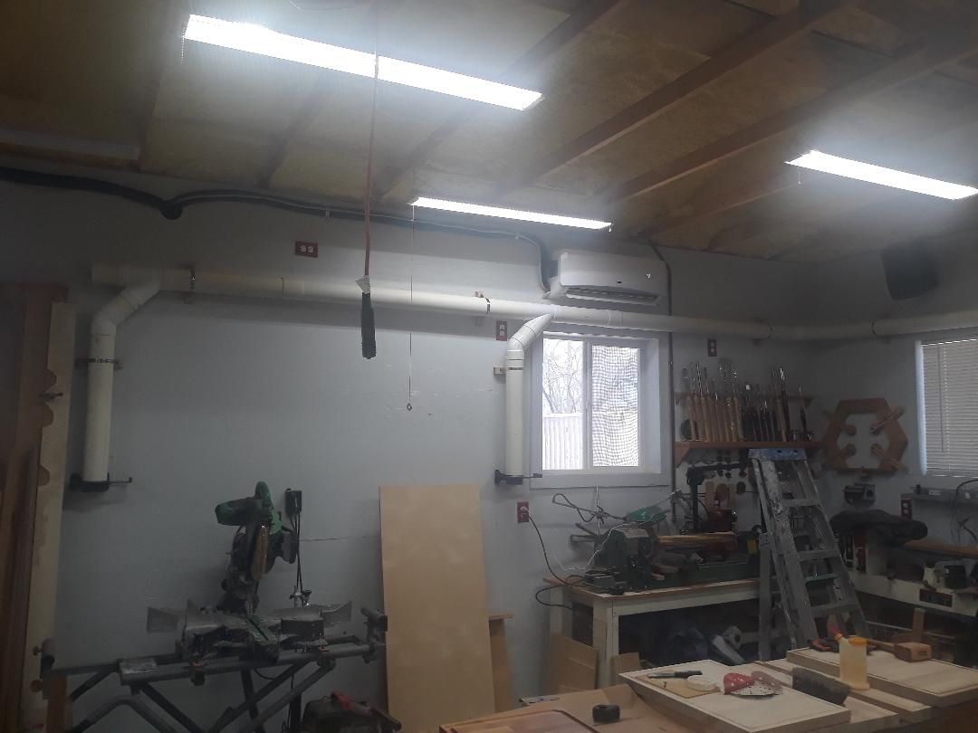

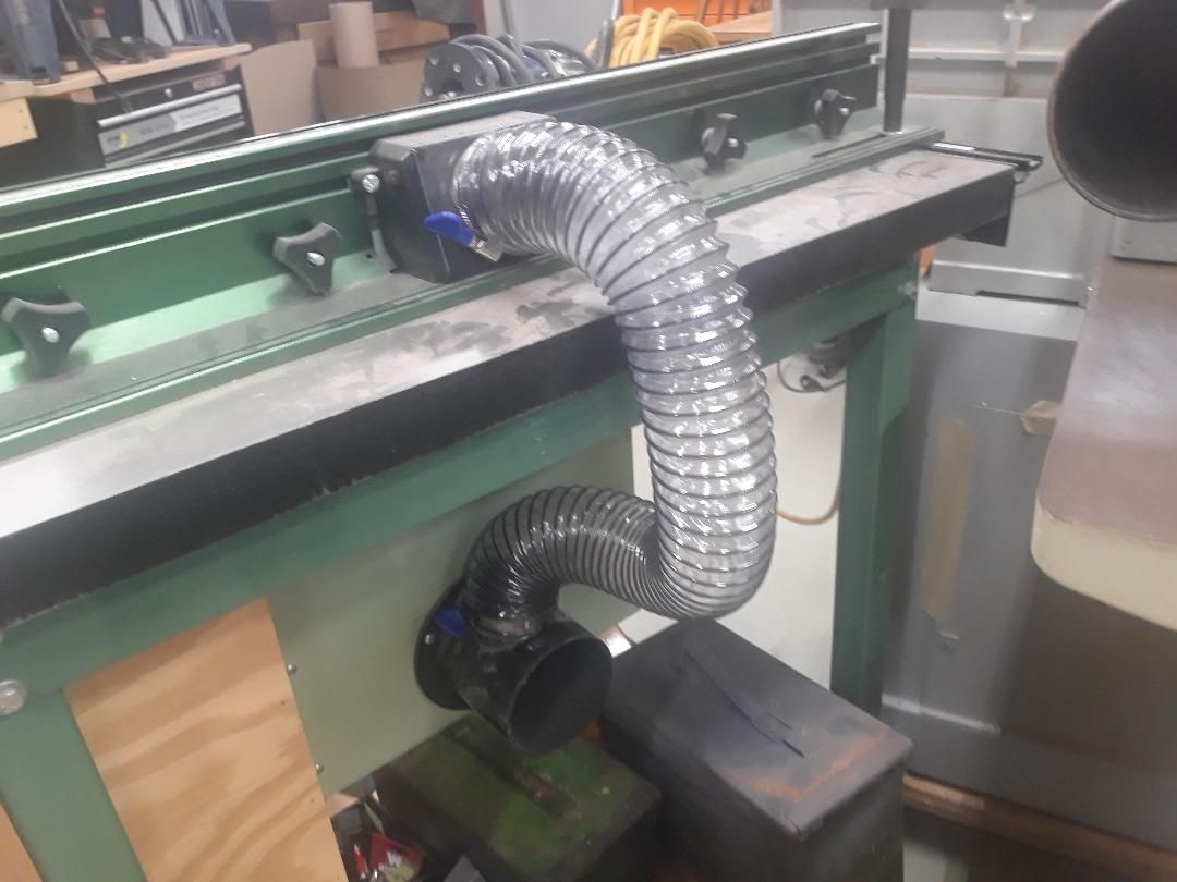

July 17, 20224 yr Author Popular Post comment_294767 well, finally got the 2.5 inch flex to fix up the new to me router table for dust collection then got up the main trunk like to just past the lathes to chop saw location, and round almost to where it will go thru the wall above the cabt in picture into the mech room, gonna run one line up and into trusses and bring out to the planer, and jointer, and table saw. have one more that i haven't gotten hung yet, but gonna take another thru the wall, and go to right corner and drop down to band saws, and drill presses, and put a manifold type fitting so i can plug in the ocillating sanders and misc. don't mind hooking them up as needed. as well as the large band saw and the large drill press, i use the smalls biggest part of the time, big saw is for resawing, and awesome at that. Report
July 17, 20224 yr comment_294771 Great progess for a day Rj. Excellent and clean looking install. I would think your suction draw will be Excellent. Appreciate the pictures. Thanks! Report
July 17, 20224 yr Author Popular Post comment_294773 the ole gal, is my assistant, so can't take all the credit, i only do what she says. Report
