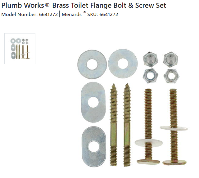

July 14, 20224 yr comment_294590 Toilet in the basement is old, old, same as the house and it's over 110. Tank has a small crack that's leaking water. Going to replace it but it's got 4 hold down bolts into the floor. I don't know if that's because of the size or what. I've never seen a replacement one like it. Edited July 14, 20224 yr by Harry Brink Report

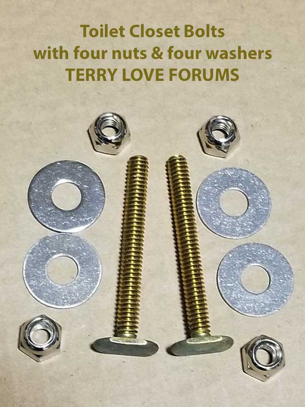

July 15, 20224 yr Popular Post comment_294603 Replaced one like that at MIL's house a few years ago. Used newer two bolt mount toilet. The front screw/bolts can be removed or cut off. The rear bolts are usually centered on the flange. Four bolt mounts are still available in the commercial/institutional (Schools/Hospitals etc.) line at two to three times the price. Report

July 16, 20224 yr comment_294680 20 hours ago, Larry Buskirk said: The rear bolts are usually centered on the flange. If the flange is cracked or decayed, a few careful blows with hammer to cold chisel will crack it and you can wiggle it past the lead. On old pipes with plenty of room, a 4x4 C.I. flange is best - plenty of room for plenty of oakum and lead. If it is okay, the old brass bolts thru the flange should be removable and you can put new ones on. I'll always use nuts and washers to bolt the bolts to the flange before a new wax ring and dropping the hopper back on. If the floor is uneven, the bowl footprint can rest in a hump of stiff cement. Tighten down the bowl but wait a little bit before trimming the cement flush (a great use for a cedar shim, slicing the cement close to the bowl). In lieu of cement, shimming with a coin then forcing grout into the seam is also great. Thinset, if you have it, the ultimate. Report
