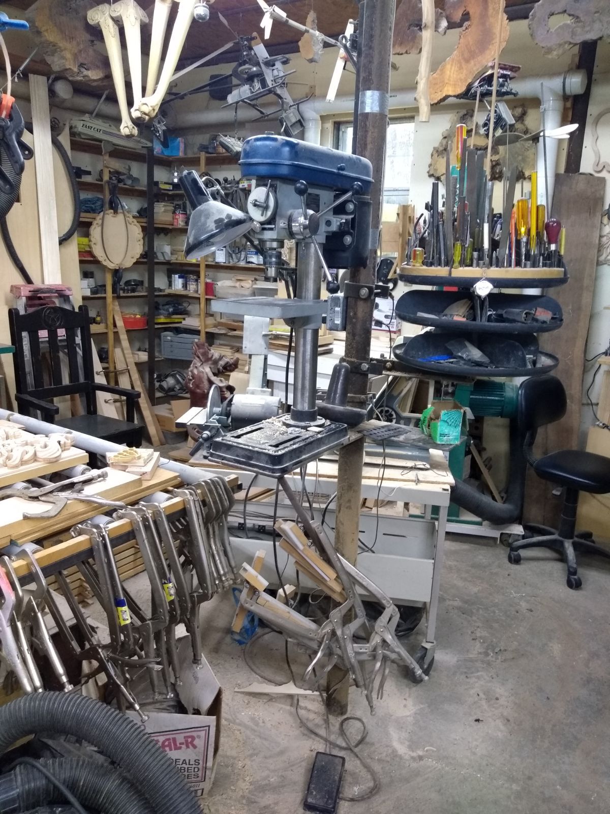

Wich I have a table model drill press that I put higher than normal especially so I could drill the little holes for inside sawing using very small drill bits.1471449203_IMG_20220620_130935916threesizesbitsforscrollsawcutouts.jpg.30dd7921188b4a12dcbb947ea1f9b778.jpg

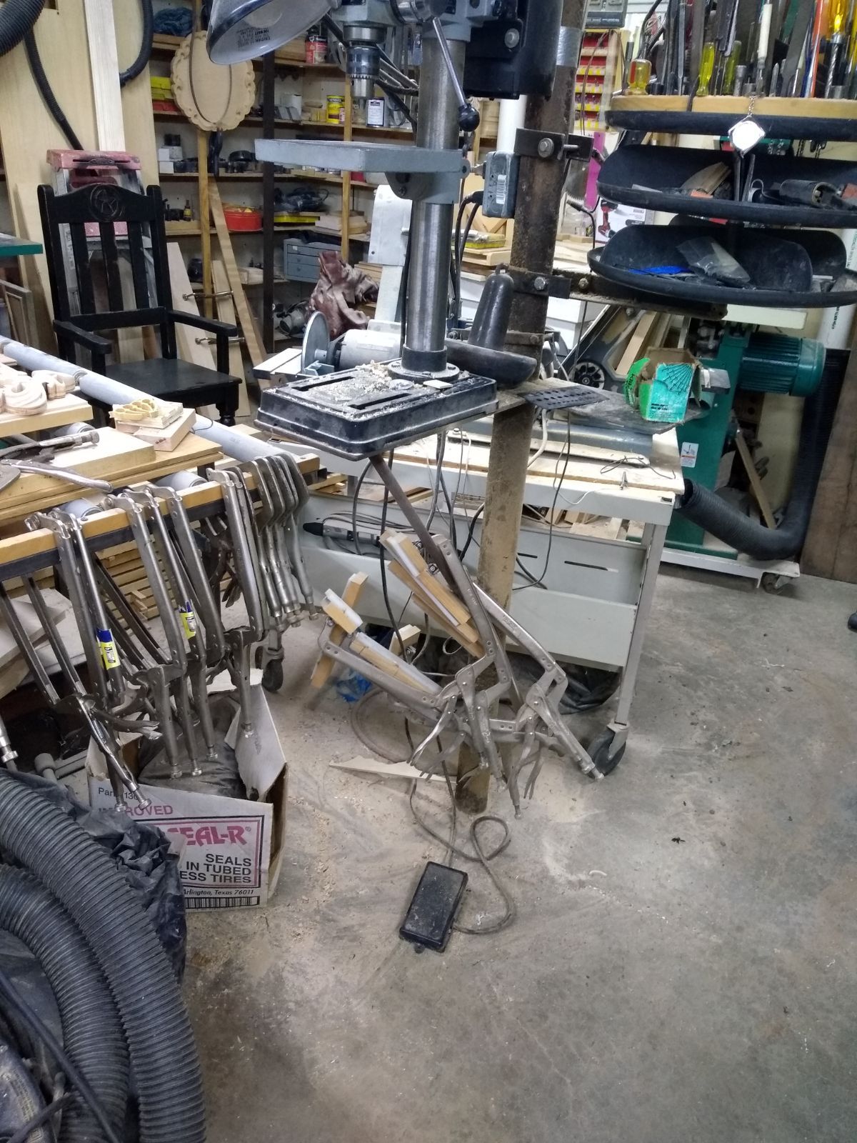

  The first thing I did to make it easier for drilling lots of holes at  time was install a floor switch to turn the drill press on and off with my foot.
  Next I built a higher table than normal to sit the drill press on so my head is just a little higher than where the wood to be drilled is sitting. Putting my eyes closer where they are needed saves time.1032206950_IMG_20220620_130622836drillpresswithworkareahighoffthefloor.jpg.83d8ec8bd90330ef936b34f6a42f8494.jpg
   And in one of the pictures you can see the top of the drilling area is higher that the out feed table for the table saw by a few inches. I have found it takes lots of time just to make sure where the bit is sitting compared to where the hole needs to be drilled especially when a person is dealing with an area that is a hair larger than the holes are to be!
My drilling area is 55 inches off the floor.... but if you are tall the height should be more.
 The drill press in about 4 foot from the scroll saw which I use a roll around office chair  for I built a table 20" high to sit the scroll saw on and it is not bolted to the table. This way I can slide the saw one way or the other if I am sawing wide wood. The saw sits on some cut up car intertubes.  Hard to come by anymore!

This drill press is only for scroll sawing holes so the speed is faster than the drill presses used for steel drilling.
I keep the height between the drill bit tip and the wood to be drilled about 3/8" or so so the handle don't have to be moved too far to engage the bit.

Great idea to set the drill press higher.  I find myself leaning over to get the holes in the right places.
