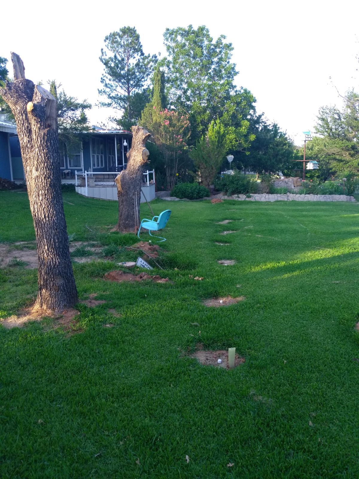

  I installed the two tanks and dug all the ditches for the lines with the backhoe so at least I know the lines were resting safely underground but the problem was how to put the poison inside the lines and no where else was a labor problem for this eighty something person and I sure didn't want wifeee in on the shovel thingy...
   And I got all that work done right before those hundred plus days settled in on this here part of Texas. And I just now looked at the 10 day four cast and the next ten days was calling for 100 up to 111.1111122944_IMG_20220608_193655972asoultionforourrootprobleminthesepticlines..jpg.a5101c5a1718e8fd37b50cfb768b5fdb.jpg
   The bad part of me digging the trenches for the lines using the backhoe I love to sit on that tractor and dig and the tops of the 8 inch pipes are all 27" from the top of the soil...meaning thats a job for a shovel or a two handed post hole digger to dig that much dirt and not cause a mess to have to clean up after all those little 3/4" pvc 40 was installed in to those 8 " pipes... I did manage to stack all that dirt on a flat 4 wheel cart one hole at a time then after installing each pipe to finish that area before I started digging the next hole.
  So now once a week I mix up some poison and using a funnel put all that junk inside the 8" pipes where the roots are living.....

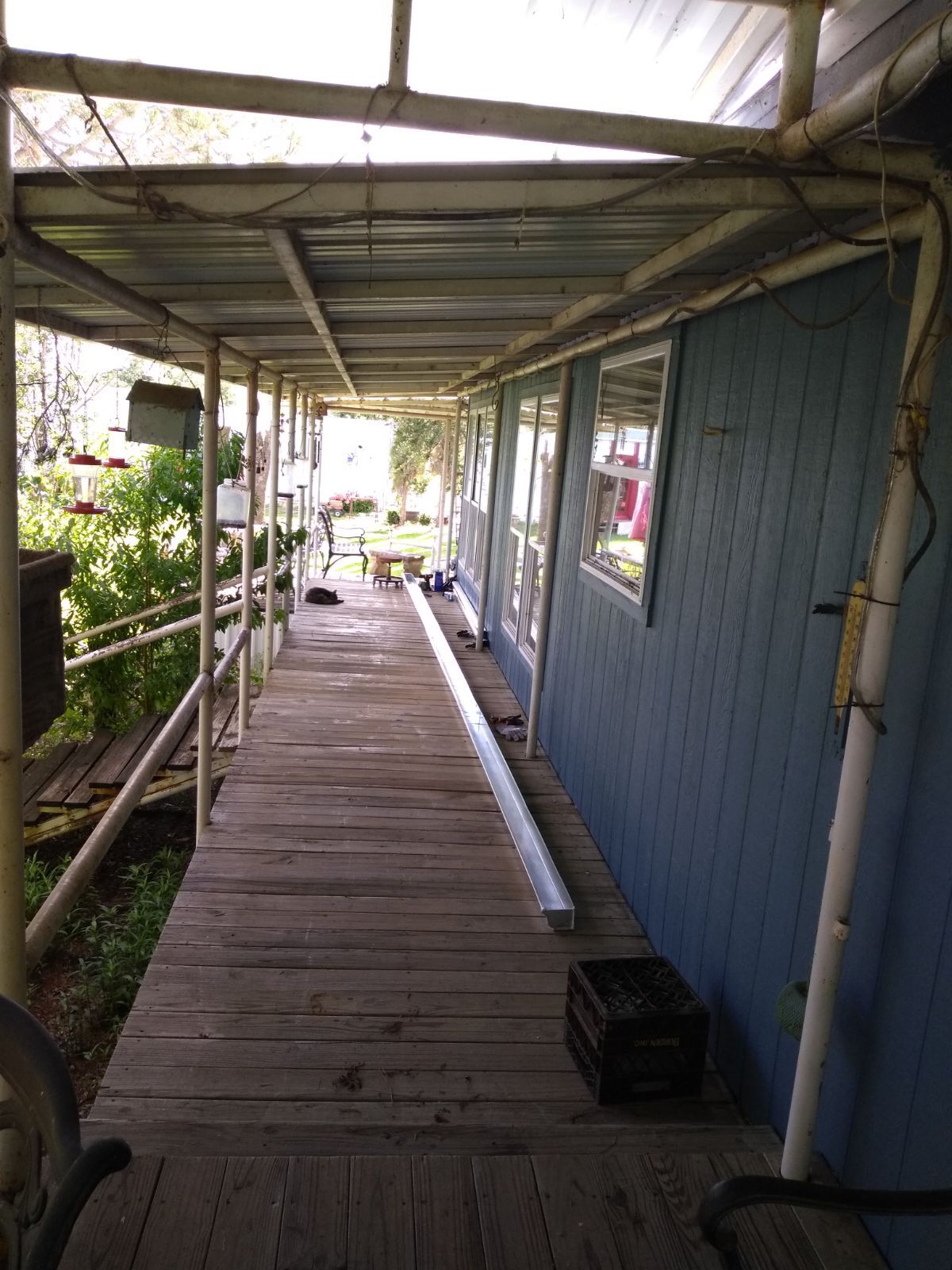

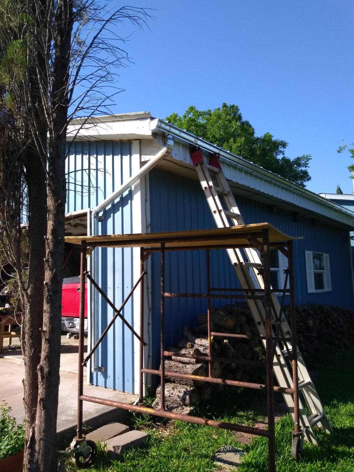

  And then the next thing to help the septic to leach out just the sewer water and not a lot of added rain water was to install a gutter on the side of the long garage and direct the over flow in front of a concrete wall the wife and I laid down in front of her shop to direct the 300 foot  long concrete drive was that is at least 20 foot wide all the way to the street.
   I happen to be the one who put up all the forms for the driveway and even commented that the slope was great for the rain water would clear off the drive way real fast but I never dreamed later on that driveway was putting all that rain water right on top of the septic system...

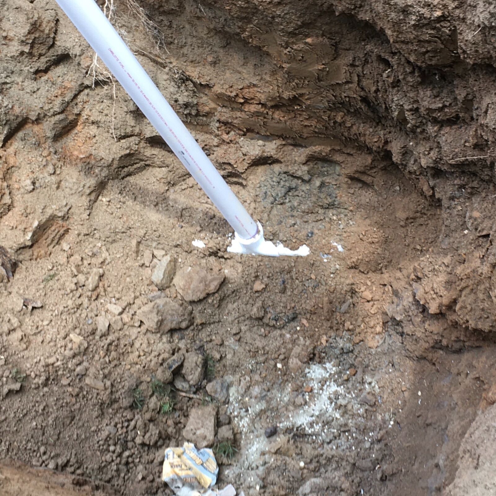

So how did I do a permeant install of those 3/4" pvc pipes into the 8" pipes and by the way the height of the pipes are all under to mover blades so I don't hit any while mowing.
  This was actually too deep for septics to leach water like they should but I did talk to grass people and they said St.Augustine roots would not go that deep so we could have the roots of the grass absorbing lots of the water and every thing would be hunky dory if I had a way to put the lateral lines that deep????

1625330682_IMG_20220603_164052269Longgutterfrom4pieces.jpg.574ca223a1bf15ce58bb3aea7838c09b.jpg
Seamless would have been faster but more money and was the first I ever bought any thing like was in the gutter build.

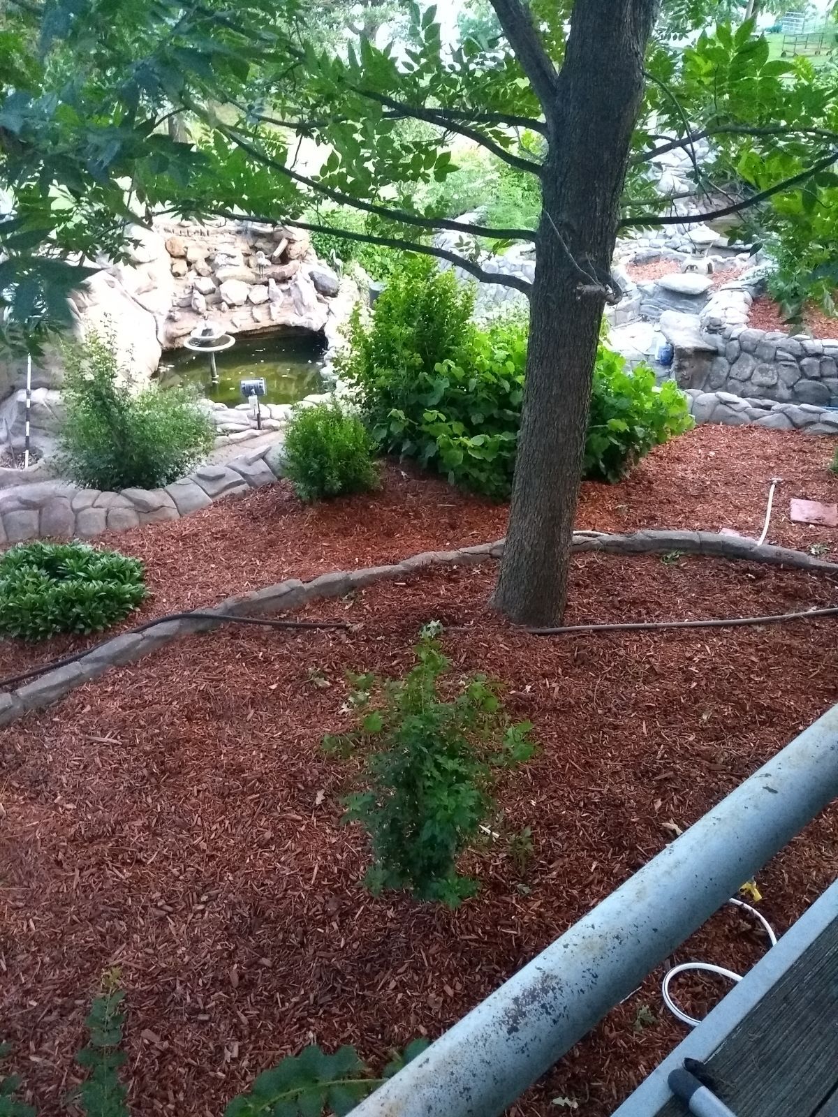

Then we decided the pine bark we laid in the terraces had seen their use for we did that about 17 years ago and this saved lots of removing weeds for a long long time so we tried to buy all Walmart had and did it again.

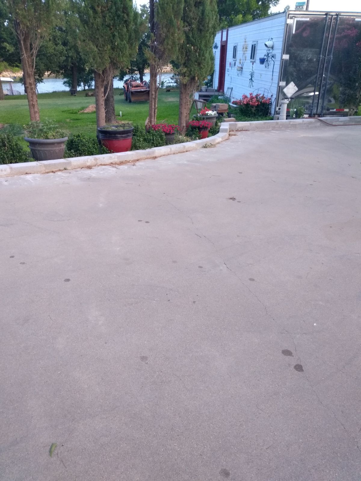

Then finally the short wall at the end of the 300 foot long concrete drive way had to be diverted away from the top of the septic for this large of an area looked like a fast river during any rainy days.
I put the forms up myself for the concrete men to lay me a drive way but never dreamed this would be like a funnel going in on the top of those lateral lines...

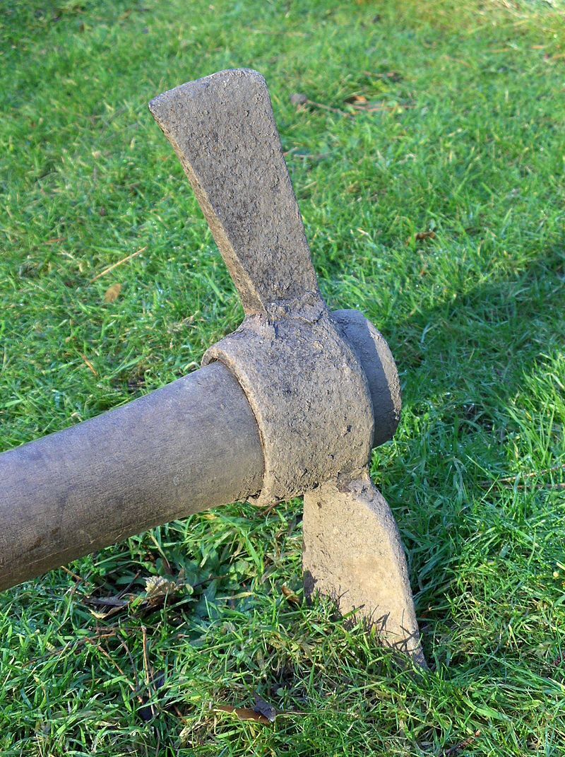

https://en.wikipedia.org/wiki/Mattock
Fun facts: A cutter mattock is similar to a Pulaski used in fighting fires. It is also commonly known in North America as a "grub axe".
It's like a pick but one end is flattened like a hoe. Great for flattening and squaring up a trench but not much good for anything else. Back in the days of endless irrigation trenches being dug throughout the area (California especially) a mattock and a shovel would be the only tools a man needed to make an honest buck.

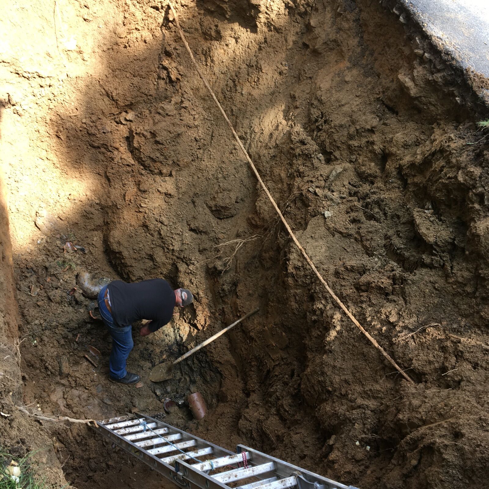

Next week we're removing a crushed curb trap (house trap) 14' down.  Thank the saints it is in the middle of the lawn; the digger will step the entire area. This county went back to No house Traps Permitted so we'll put a double wye on its back and make it a clean-out.

3/4" pvc 40
I'm a little perfused.  What's the deal with 3/4" piping?
Around here there is no such thing as "do it yourself " septic systems anymore. The state requires it to be installed by a licensed installer and designed by a licensed engineer. I spent over $24,000 almost 20 years ago to have my system installed. The septic new systems require a minimum 1000 gal septic tank, and a 500 gal water holding tank which takes top water from the septic, When the water tank is full it is pumped  into a specially designed leaching field. There is also an alarm system to let you know if the water tank is above the regulated level. Now the town is running town sewer on my street and even if I don't tie in to it it will cost me $30,000. No help to me but it sure makes the greedy developers happy. :angry:
Cliff go back to the first picture and you will see a row  of 9 or 10 3/4" pvc caps. This is my way of delivering the goods to the source. Now about every other week I unscrew those caps and insert a funnel and about 5 gallons of root fighter goes in on top of those hopefully shrinking swiveling roots. I know doing this won't remove them out of the 8" pipes but hopefully I can reduce the size of them enough to let some waste flow past them while getting dosages to keep them reducing in size ?
  Never seen this done so I come up with a way so some young'un don't come along and pulls up my pipes since the other end of the pvc pipe is just sticking through a hole in the larger pipe. I could explain how I did it if any one needs to do this to their system.

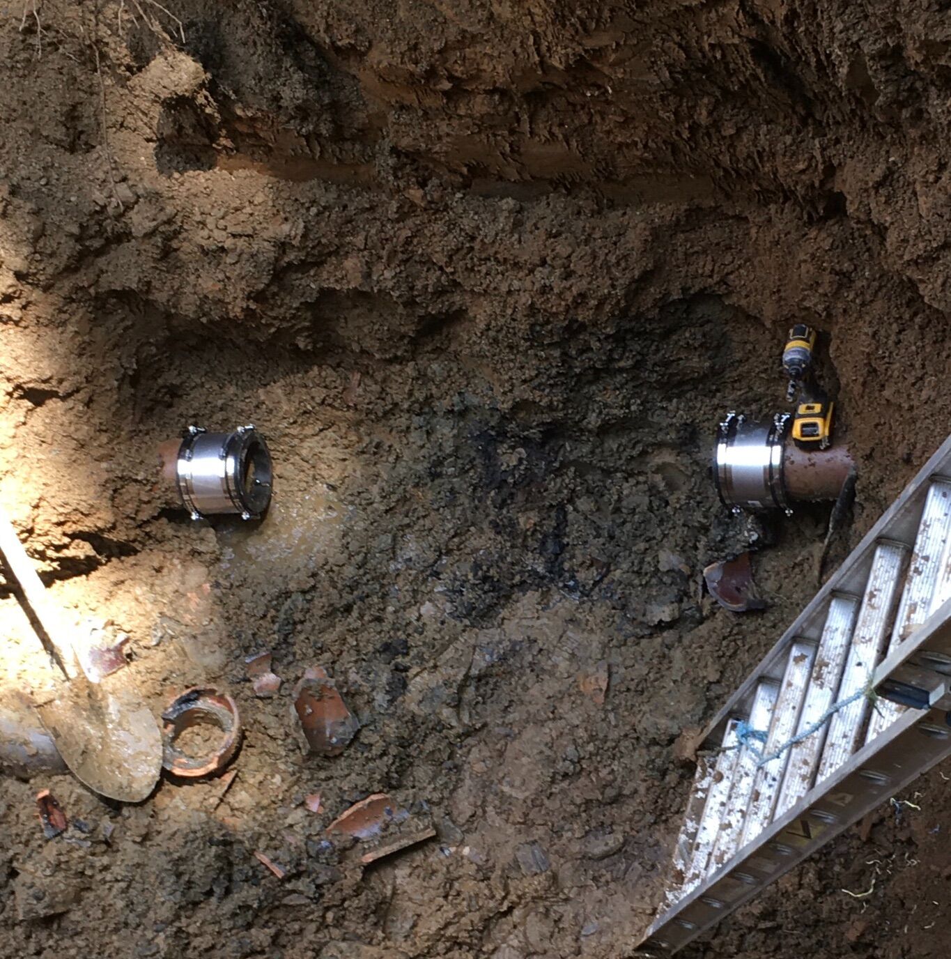

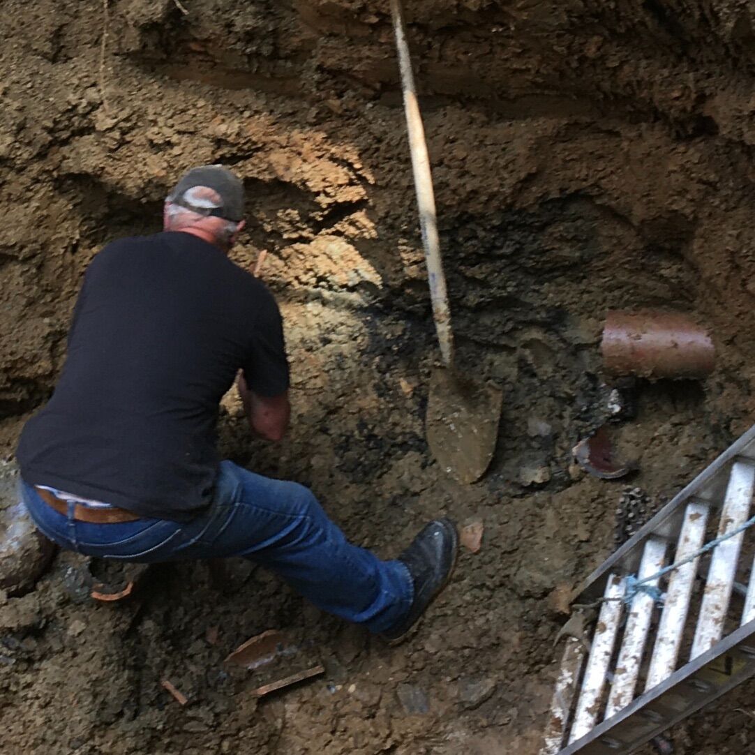

c.1946 5" terra cotta house trap cracked, filled with dirt, sludge, etc. Multiple contractors could not cable it clear. Three hours of digging with a 3' bucket. Start-to-finish 7 hours. For my buddy's kid. And some companies priced this at $18,000 :WonderScratch:
The digger is the only one who got paid yesterday. When the kid gets a check from his sewer warranty company I may get a few bucks.
595146329_removingahousetrap1.JPG.7edcc8cce16bcc197da66de2ab935269.JPG 1833881428_removingahousetrap2.JPG.4162e110c5e97be3b15d72cc00e3d33e.JPG 649688859_removingahousetrap3.JPG.4d95190b22f3780ec6e01eb047f23416.JPG
This one was rather deep because of the topography.  Typically 6' though.
Taphephobia alert! Unedited image!
