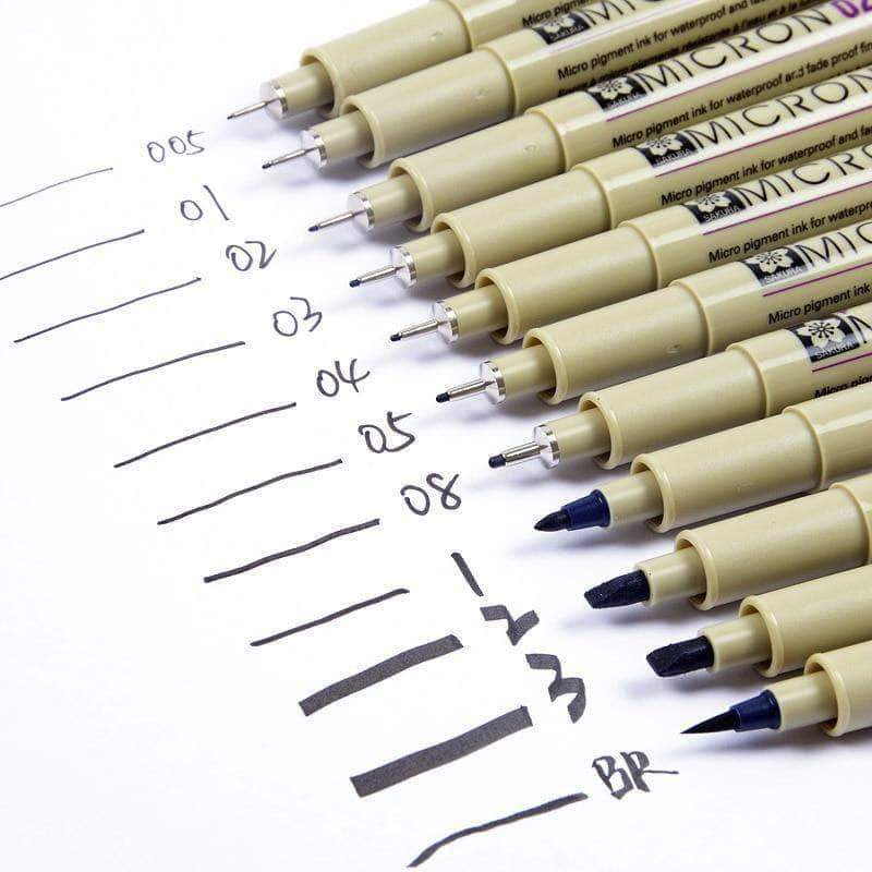

June 10, 20224 yr Popular Post comment_292526 Micron pens are used to write on things in the museums. It is some kind of pigment ink in it I bought one and have yet to have it smear on me no matter what finish I use over it. Report
