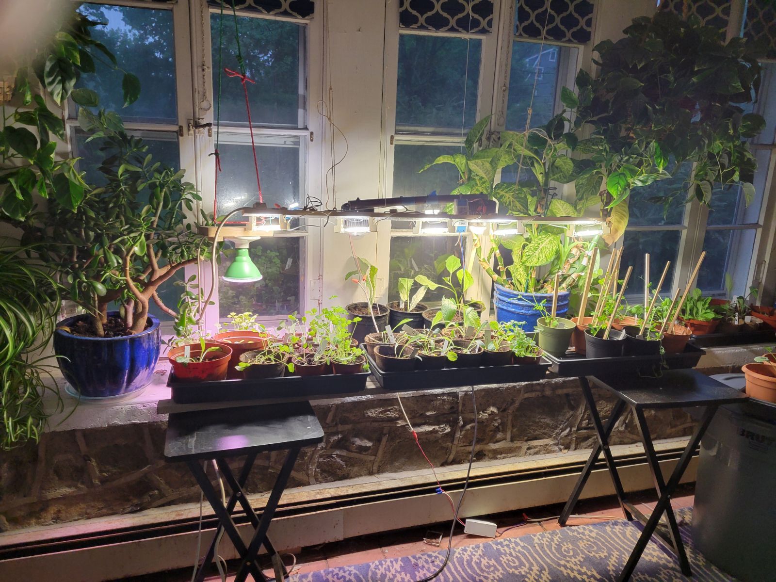

May 14, 20224 yr Popular Post comment_290800 I just bought some cheap LEDs supposedly HIGH CRI. They are built to be replacements for those Halogen 500 Watt tubular lamps I got 5 with the sockets I got these https://www.aliexpress.com/item/1005002970801305.html?spm=a2g0o.order_list.0.0.21ef18027ktqnm $4.33 https://www.aliexpress.com/item/3256802092589161.html?spm=a2g0o.new_account_index.0.0.421825b9j2Drp9 under a buck Now here's the deal: They plug into the wall. No conversion to DC, no fussing with polarity, no building electronics to control voltage. They plug into the 120 VAC wall outlets. the box says 110 to 140 volts This is the Socket the metal mounting bar is not energized at any time, it's insulated by the ceramic socket. This is me plugging on in. I plan on hooking all five up in parallel see if that works. Report

May 14, 20224 yr Author comment_290811 33 minutes ago, Grandpadave52 said: Look forward to your evaluation. They work in parallel great. the light is pretty good really strong.. I made a light bar for our seedlings. Report

May 14, 20224 yr Author Popular Post comment_290825 I screwed 'em to a hunk of wood painted it reflective and hung it over some seedlings wired up in parallel. I've used plain no name LED spotlights and i have done well using them as grow lights. Report
May 14, 20224 yr Author comment_290827 Here's the thing. LEDS have a funny characteristic. The hotter they get the more energy it takes to drive them until they overheat. When they overheat they die. I've been running these for 4 Hours. The bulbs are hotter than any LED I've ever had ever got but the light seems undiminished They are about 105F according to my infrared thermometer but 154 F according to a contact thermometer. Report

May 19, 20224 yr Author comment_291132 So far these lamps are great. I will definitely be buying more. My seedlings LOVE these things. The response is - - well - - dramatic. I want to build grow-racks in my cellar for starting garden veggies. These put out so much light over such a wide area providing enormous coverage. I have 5 of them producing the equivalent of 500 watts each on one 15 Amp line. So that's a 2500 watt equivalent of light output on 15 Amp circuit. Of course the energy from a 500 watt incandescent lamp is mostly heat energy maybe 90% of it is heat energy lost. That's why I'm aboe to run these LEDS on a small circuit. They peak out at 150 - 160 F and don't get hotter over the course of a whole day. Edited May 19, 20224 yr by Cliff I am certifiable Report
