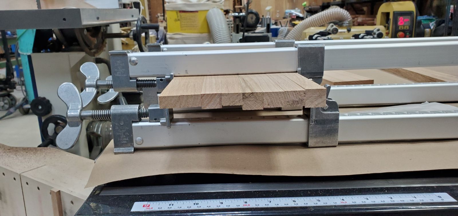

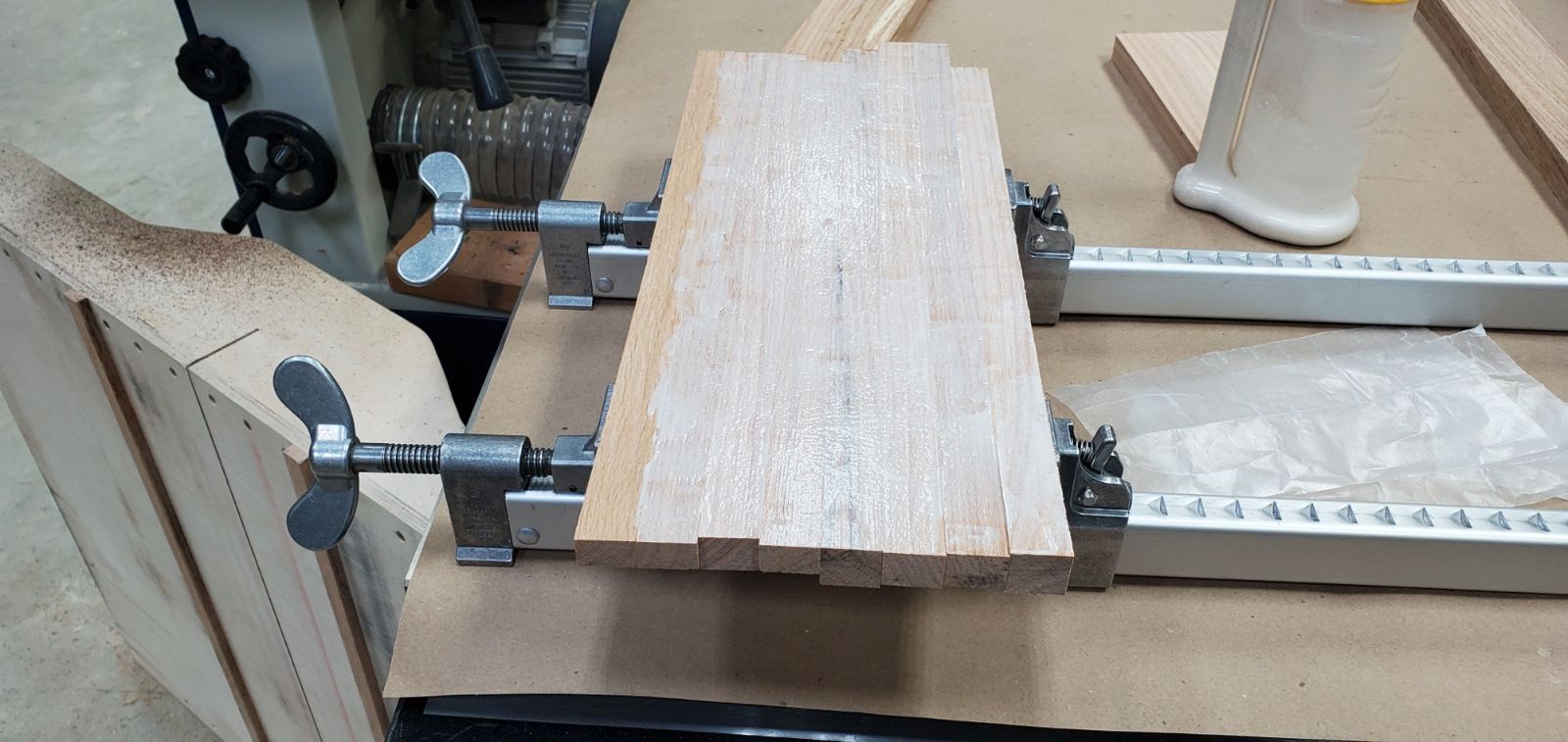

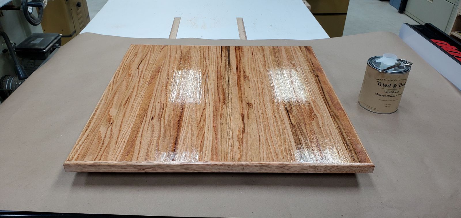

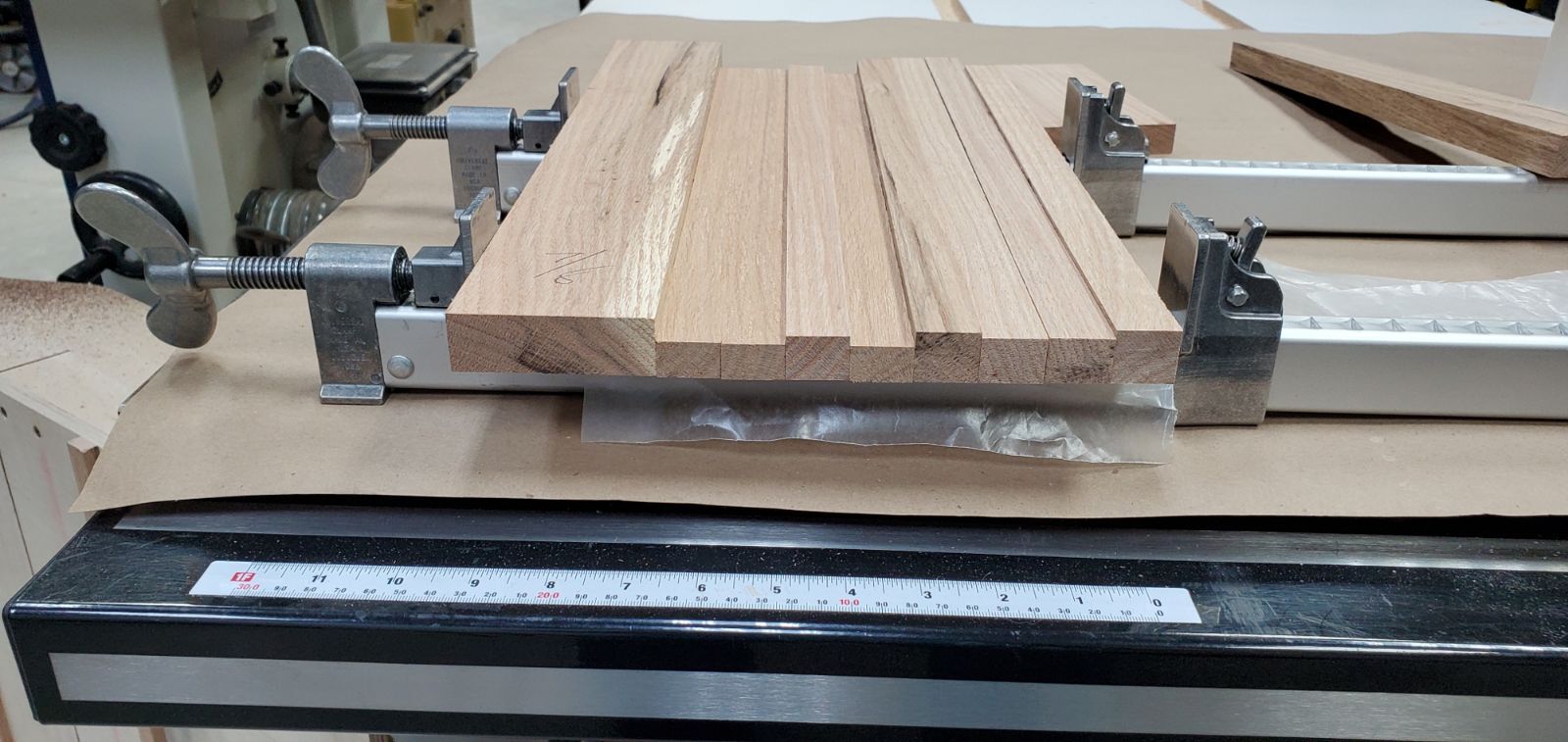

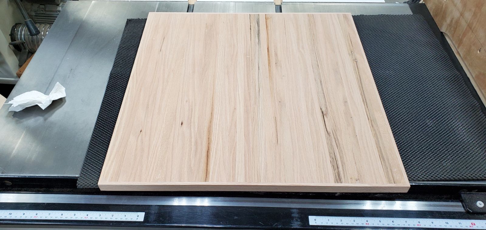

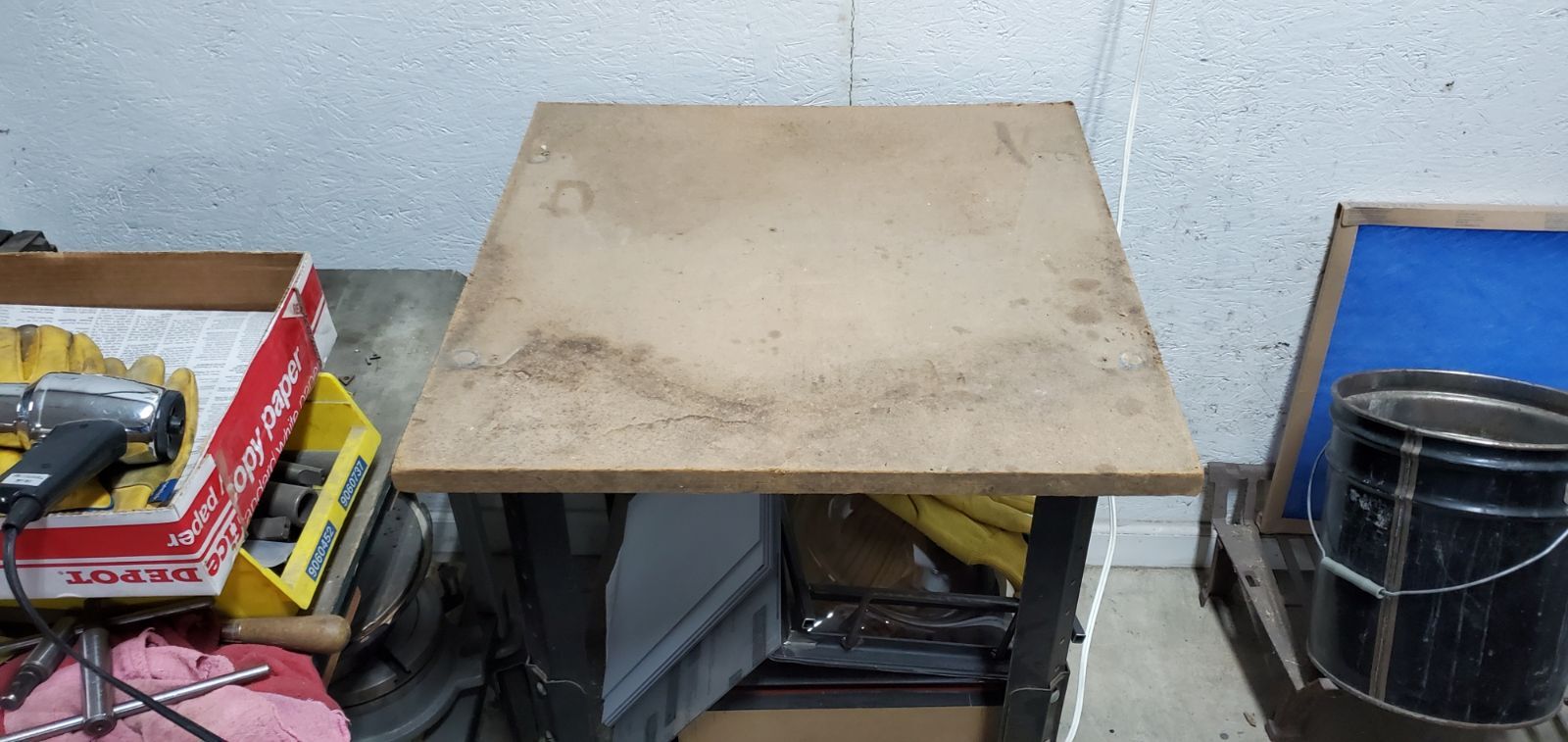

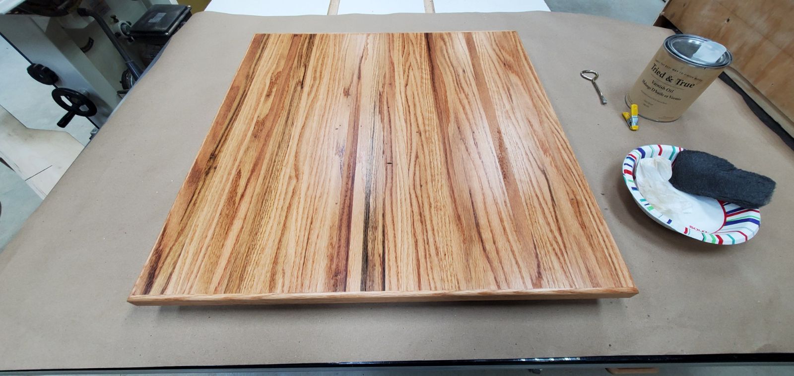

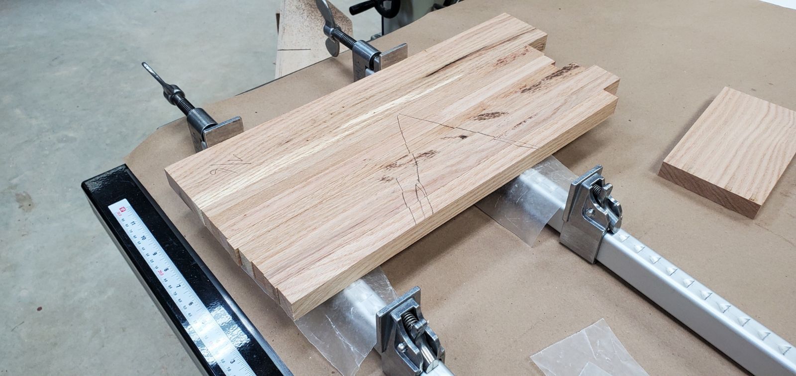

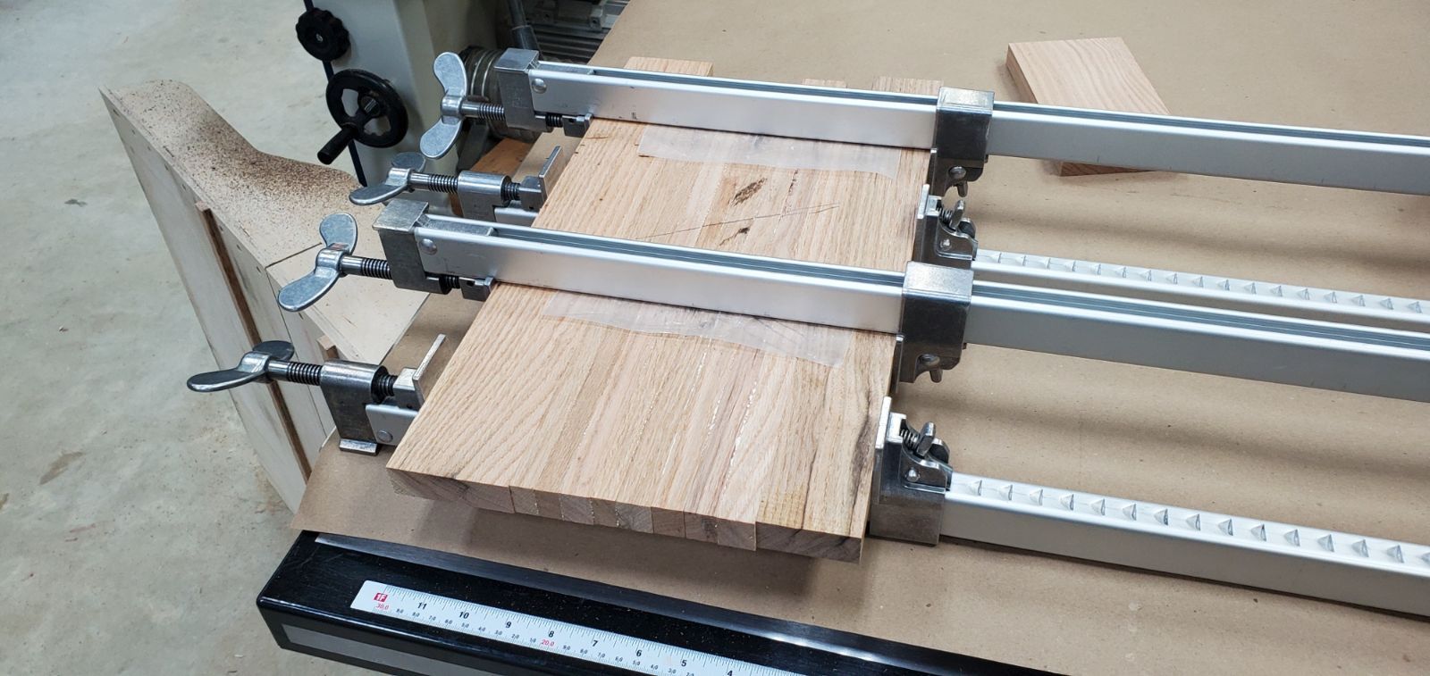

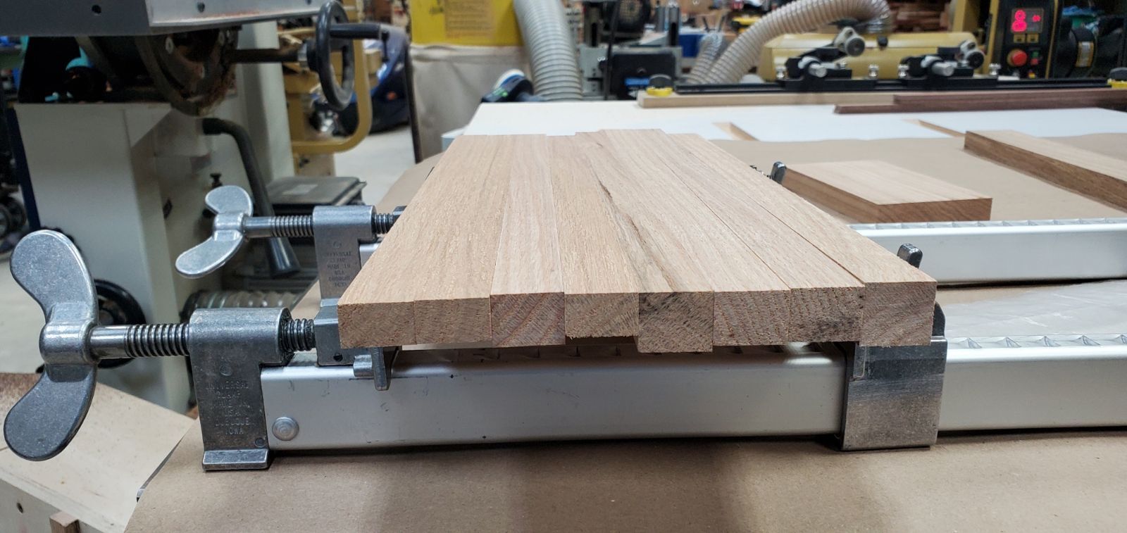

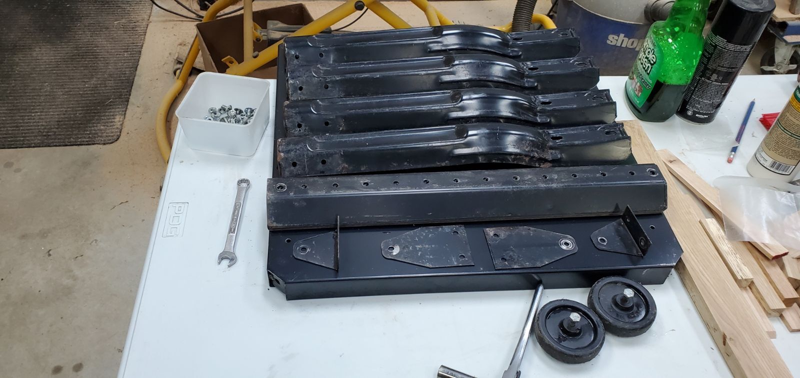

Popular Post jthornton Posted April 12, 2022 Popular Post Report Posted April 12, 2022 I had this 2' x 2' mobile table that was looking pretty bad. The MDF top had been wet a few time in the past so I've been pondering replacing the top with a piece of plywood. So out to the shop to find a piece of 3/4 plywood that was 24" x 24" and I pondered even putting edge banding on it to clean it up and maybe have a radius on the top edges. Well my plywood rack was pretty slim and none fit the bill so I looked around the shop and decided I'd edge glue some random strips of red oak and make a top that way. After flattening enough boards I cut them to 15/16" wide strips and ran them through the drum sander to get a good glue surface. I glued up 4 boards ~6" wide or so. Because the boards were various widths when I flipped them over to glue it was a humpy top so not so easy to glue. I put them in another pair of clamps with the glue surface down. Then transferred the boards to the previous clamps and kept them a bit proud of the jaws. Now when I remove the top clamps I'm ready to roll on some glue. Easy to spread the glue with a roller now. Drop and flip and clamp up and do something else for the rest of the day. I figured I'd clean up the table a bit so I disassembled the table. After looking at the parts and seeing some rust I decided to blast them clean and powder coat the legs and paint the shelves. I was concerned the thin metal of the shelves might warp in the powder coat oven. Blasted clean and flashed off in the powder coat oven. Ready for powder. Powder coated Painted Finally got the top assembled A few coats of Tried & True Varnish Oil. Buffed with 0000 steel wool. The finished table JT Cal, Headhunter, Larry Cutlip and 10 others 13 Quote

Grandpadave52 Posted April 13, 2022 Report Posted April 13, 2022 So are you going to put the MDF back on top to prevent marring the surface? I suppose you could hold off until after you serve the Easter ham meal. Cal, Gunny and Gerald 3 Quote
Fred W. Hargis Jr Posted April 13, 2022 Report Posted April 13, 2022 As a person who doesn't care much for red oak, I have to say that's some of the nicest looking RO I've ever seen. Wow! Cal, Gunny, Grandpadave52 and 1 other 4 Quote
Popular Post jthornton Posted April 13, 2022 Author Popular Post Report Posted April 13, 2022 When a couple of red oak logs "fall" into your collection you make a lot of red oak stuff. Giant red oak was blown over in a storm at my buddies house just missing the house by 20'. Sawed up into rough boards to dry July 2020. JT Gerald, kmealy, Cal and 4 others 7 Quote
jthornton Posted April 13, 2022 Author Report Posted April 13, 2022 6 hours ago, Grandpadave52 said: So are you going to put the MDF back on top to prevent marring the surface? I suppose you could hold off until after you serve the Easter ham meal. It's a work bench... it's going to get dinged up and I accept that. JT Cal, Gunny and Grandpadave52 3 Quote
Cal Posted April 13, 2022 Report Posted April 13, 2022 Pretty doggone nice for a simple "work table" there JT Gunny, Grandpadave52 and jthornton 3 Quote
4DThinker Posted April 13, 2022 Report Posted April 13, 2022 All add a "Nicely done!" to the stack. I've come to like red or white oak done like you did or ripped and flipped before gluing up. Not a fan for the face grain view of wide boards though. The only critique I'll throw in is the edge trim on the end grain. Oak wants to swell and shrink across the grain with seasonal humidity changes. A good finish and stable environment can minimize, but as a shop bench I doubt the humidity is stable. Post again if it ever splits or buckles. I speak from personal experience. 4D Cal, Gunny and Grandpadave52 3 Quote
jthornton Posted April 13, 2022 Author Report Posted April 13, 2022 1 hour ago, 4DThinker said: The only critique I'll throw in is the edge trim on the end grain. Oak wants to swell and shrink across the grain with seasonal humidity changes. A good finish and stable environment can minimize, but as a shop bench I doubt the humidity is stable. Post again if it ever splits or buckles. I speak from personal experience. Thanks for the heads up on end grain moving. I keep my shops closed up and keep the humidity at 50% or a bit lower year round. JT 4DThinker, Grandpadave52, Gunny and 1 other 4 Quote
