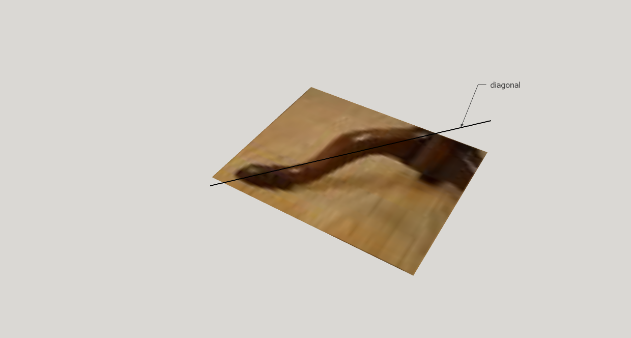

If you have the material, I would set the alignment to diagonal. The is parallel to the leg length.

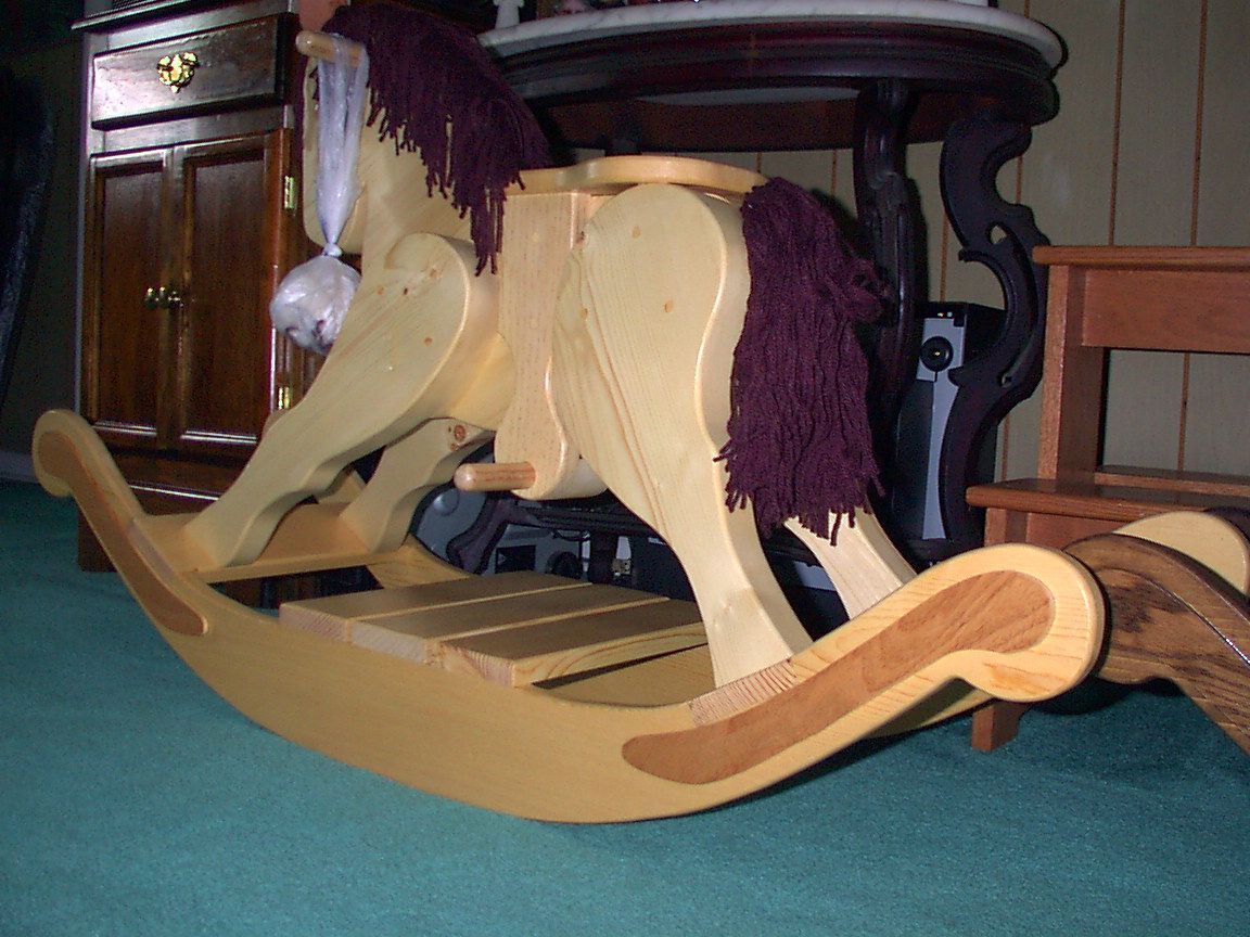

Another idea, similar to Pete's is to add gussets. The first rocking horse I made from this patterns had a problem with the rocker ends snapping off. A friend suggested the gussets added to each end. I sorta stylized the outline to mimic the rocker shape.
Yee-haw Lew, LOVE that pony!!

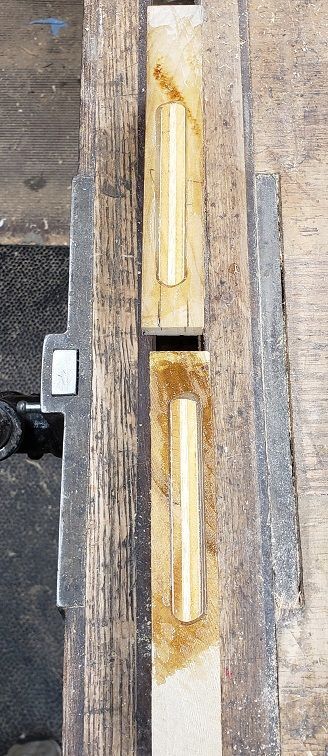

Guys, here's my hopeful solution to the short grain problem. I dadoed in a slot and epoxied in a section of plywood. I'll drill and glue in a thru dowel and cap it with a mushroom button plug.
