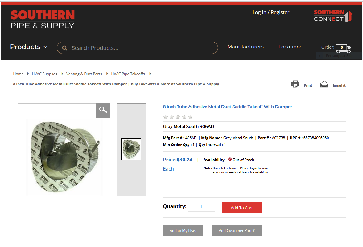

There are things called "saddle tees" where you would just cut a hole, put the tee over it, then you register. The linked one is adhesive, though I might still be inclined to put in some pop-rivets. Just remember it will reduce the air to what ever room(s) that branch feeds.

The saddle tee comes with a damper too.  Once and done.
