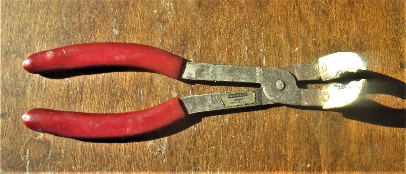

steven newman Posted February 6, 2022 Report Posted February 6, 2022 I might have a more modern version..that Dad used to pull ignition wires with... Apparently, they got tired of cutting the wires.. Just reach down, grab and pull....mainly to get the rubber boot as well as the wire off a spark plug... Twould be my best guess... Grandpadave52, HARO50, Cal and 1 other 4 Quote
steven newman Posted February 7, 2022 Report Posted February 7, 2022 I suppose it could also be used to remove the connections to the battery's post....just a WAG.... Grandpadave52 and Cal 2 Quote
Grandpadave52 Posted February 7, 2022 Report Posted February 7, 2022 I'm gonna make a guess, it's a fixed gauge wire insulation stripper/ cutter. The blades appear to be replaceable. Maybe for early household wiring that used post and tube? Cal and Woodman 2 Quote
HandyDan Posted February 7, 2022 Report Posted February 7, 2022 It looks like a bearing separator. I wonder if it was used to remove motor bearings and such in a sweeper/vacuum cleaner repair shop. Grab the bearing and give the armature a tap-tap with a hammer. Woodman, steven newman and HARO50 3 Quote
HandyDan Posted February 8, 2022 Report Posted February 8, 2022 May have been used by the radiator hose installer at GM or Ford. HARO50, Cal and steven newman 3 Quote
Gerald Posted February 9, 2022 Report Posted February 9, 2022 I was thinking to remove something like the caps on barrels . They made tools for longevity back then and the replacement of the blades means this tool got lots of use to me. Well after thinking a couple minutes the metal barrels had a different configuration so I do not know HARO50, Cal, steven newman and 1 other 4 Quote
Woodman Posted February 10, 2022 Report Posted February 10, 2022 Lineman's wire strippers. Probably a proprietary tool for a certain type of cable that is long gone now. Cal, Grandpadave52 and steven newman 3 Quote
frenchwwr Posted February 22, 2022 Report Posted February 22, 2022 Pin foundry tool, pliers https://commons-wikimedia-org.translate.goog/wiki/File:Gereedschap_voor_tingieterij,_tang,_objectnr_6148.JPG?_x_tr_sl=nl&_x_tr_tl=en&_x_tr_hl=en&_x_tr_pto=sc HARO50, Woodman and Grandpadave52 3 Quote
HARO50 Posted February 22, 2022 Report Posted February 22, 2022 BINGO!!!!! Grandpadave52 and Cal 2 Quote
Woodman Posted February 23, 2022 Report Posted February 23, 2022 Tin foundry tool for cutting sprues. Who’d a thunk! Grandpadave52 and Cal 1 1 Quote

HandyDan Posted March 12, 2022 Report Posted March 12, 2022 (edited) This is from the same page that @frenchwwr showed. I'm unable to read it. https://museumrotterdam.nl/collectie/item/6148 Edited March 12, 2022 by HandyDan Grandpadave52, steven newman and Cal 3 Quote
Grandpadave52 Posted March 12, 2022 Report Posted March 12, 2022 1 minute ago, HandyDan said: This is from the same page that @frenchwwr showed. I'm unable to read it. https://museumrotterdam.nl/collectie/item/6148 Well, after reading it (kinda hurriedly I admit), I fully concur. Cal, steven newman and Gerald 1 2 Quote
