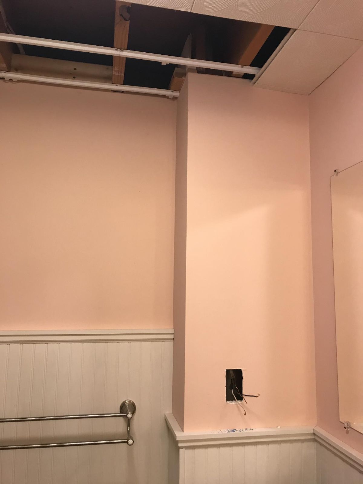

What should have taken one hour to replace a GFI outlet in my basement bathroom took some time yesterday and most of today.  After removing the ceiling tile in the adjoining room, I determined that I had a bad wire in the wall.  Some where in a 4 ft section was the issue.   I remodeled the basement bath in 2008.  I forgot that the 12-2 did not route straight down from the opening in the adjoining room to the outlet, so an easy routing it was not.  I had to cutout the outlet box and remove the ceiling tile in the bathroom to allow access above the ceiling to reroute a new line.  It is all buttoned up now.  Tomorrow I will dive into the hall bath plumbing problem.  Both sinks are backing up.  No access from the basement or the roof.   Danl
