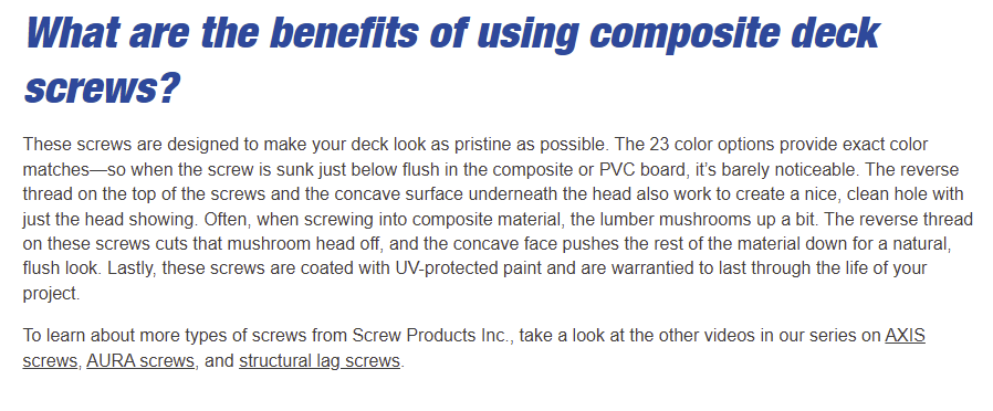

January 4, 20224 yr comment_280287 I found about 50 of these & have no idea of why they were designed this way they are inch & half. Any idea? Report
January 4, 20224 yr Popular Post comment_280290 They are designed to pull the top board down as the screw enters the bottom board. For example, drawing the deck board down tight. They make a similar thing to tighten down floor boards, then shear off the head. Report
January 4, 20224 yr Popular Post comment_280291 they go thru Trex and into PT framing for decking. Report
January 4, 20224 yr Author comment_280294 So when you use it, the bottom threads will pull the board down tight and doing so will strip the wood threads in the top board, and still make a tight fit? Report
January 4, 20224 yr Author Popular Post comment_280296 48 minutes ago, kmealy said: They are designed to pull the top board down as the screw enters the bottom board. For example, drawing the deck board down tight. They make a similar thing to tighten down floor boards, then shear off the head. The heads don't break off this one? Report
January 5, 20224 yr Popular Post comment_280344 The threads under the head make a clean hole for the head to sit in and looks nice. No frayed edges. Report
