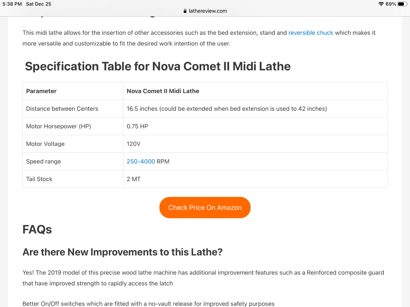

Hmmm. The comet 11 is about $600. Around the range I want to stay...the others cited are quite a bit higher.  One  spec said the comet was 230 another I saw said 110...the manual does not specify which is strange..it says to keep it at a 15 amp breaker
Here is the 120v spec. But I also saw 230
