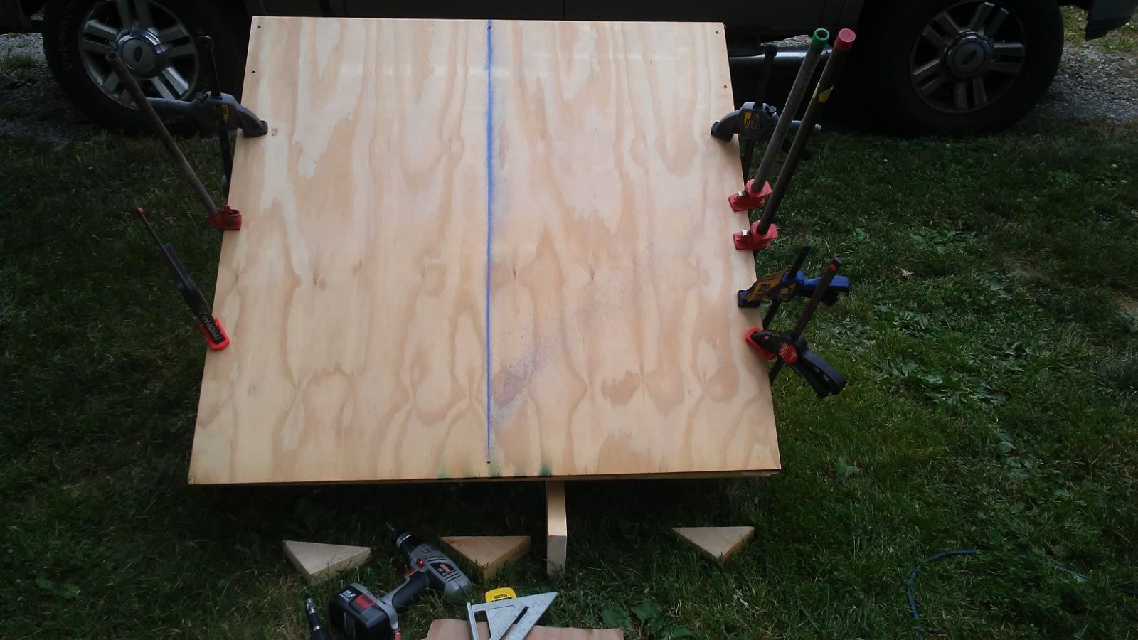

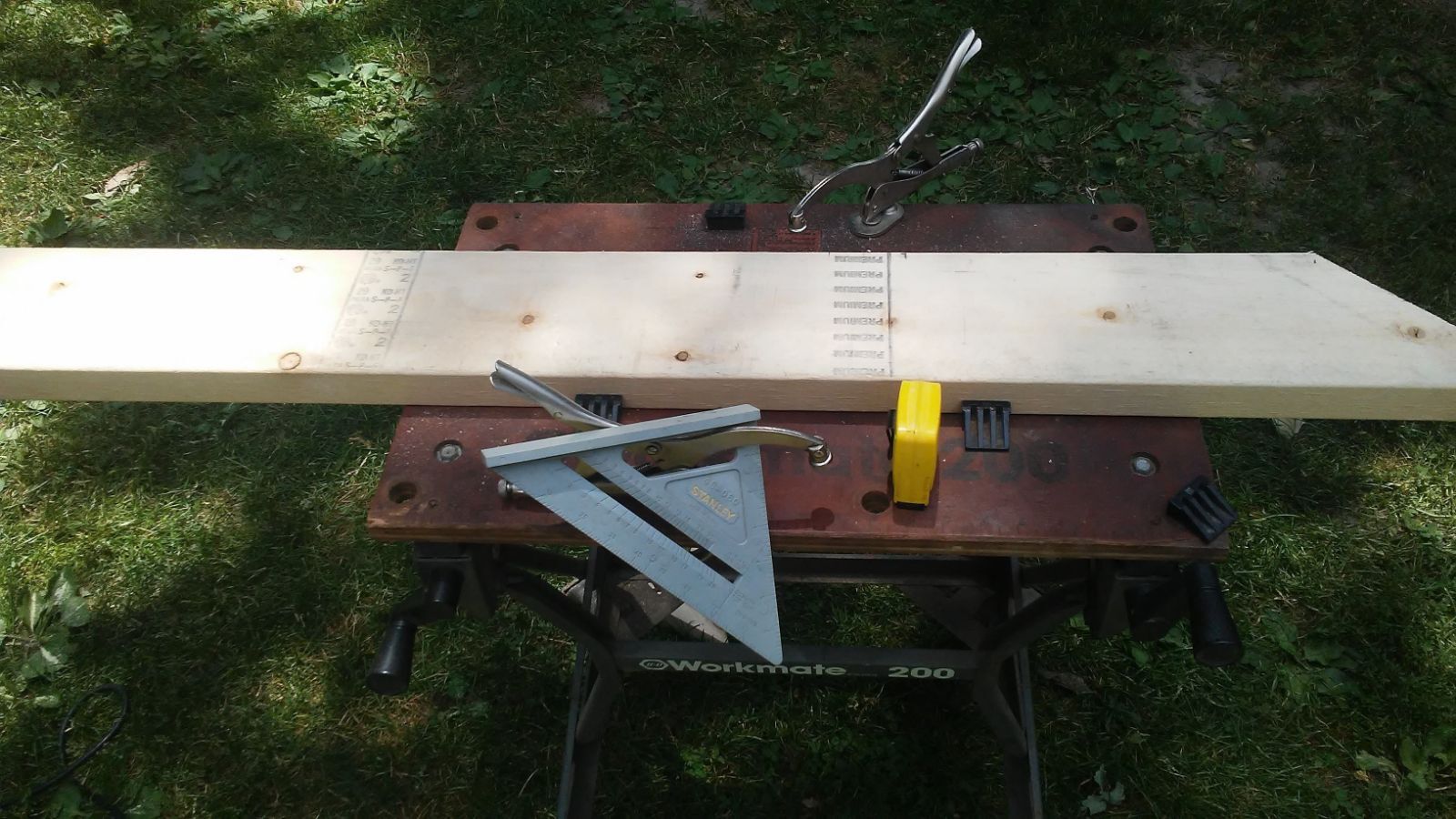

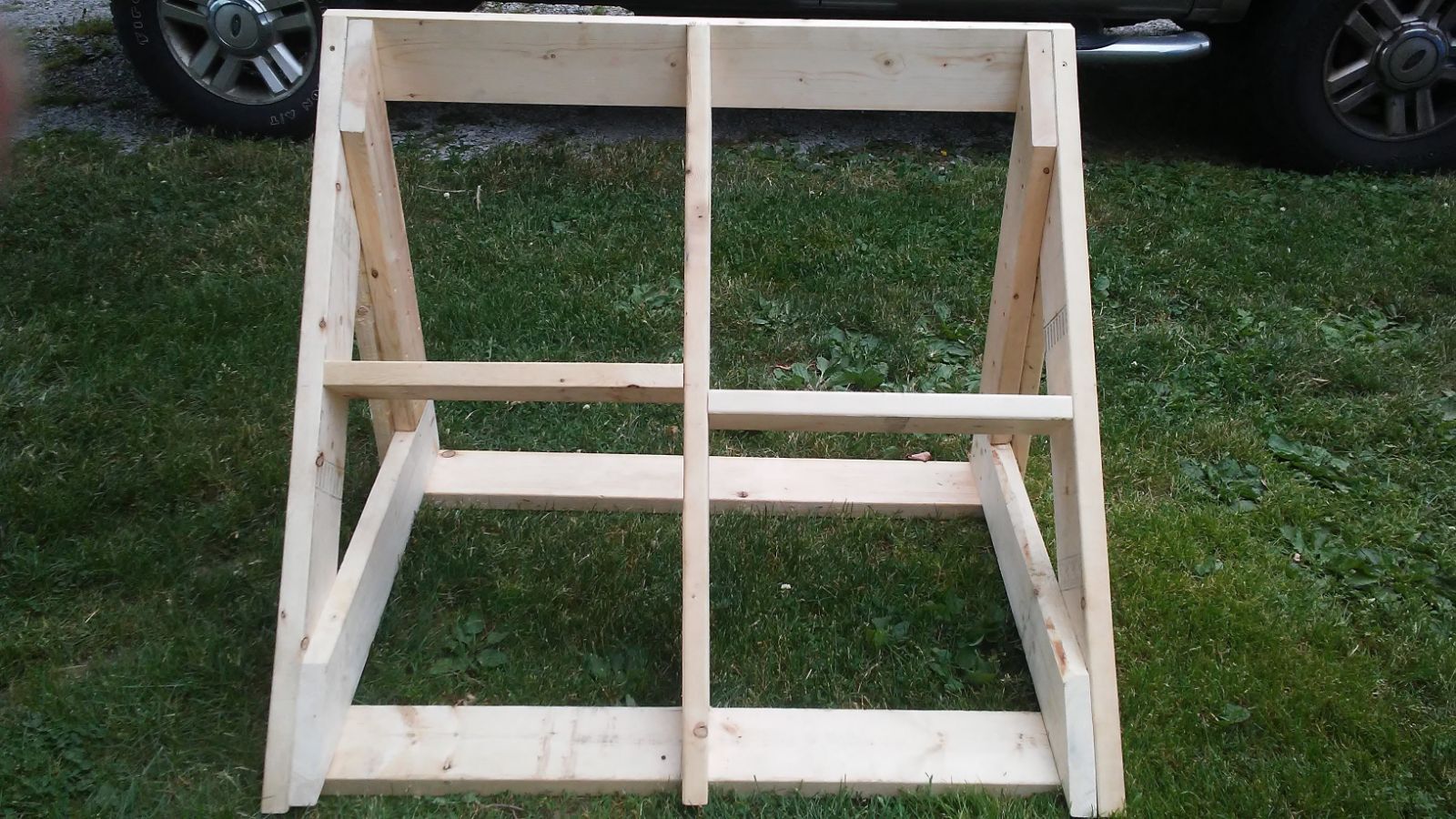

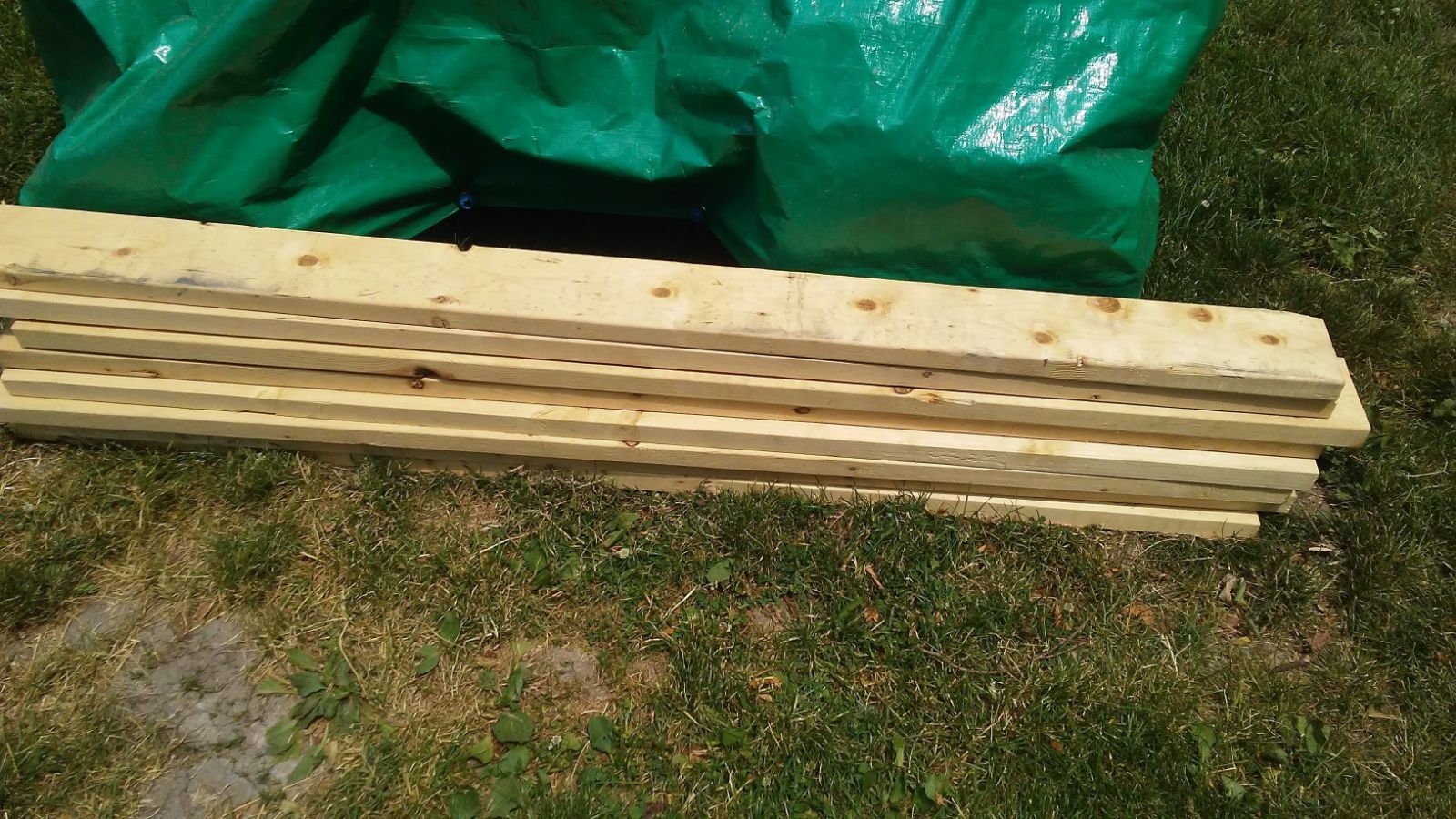

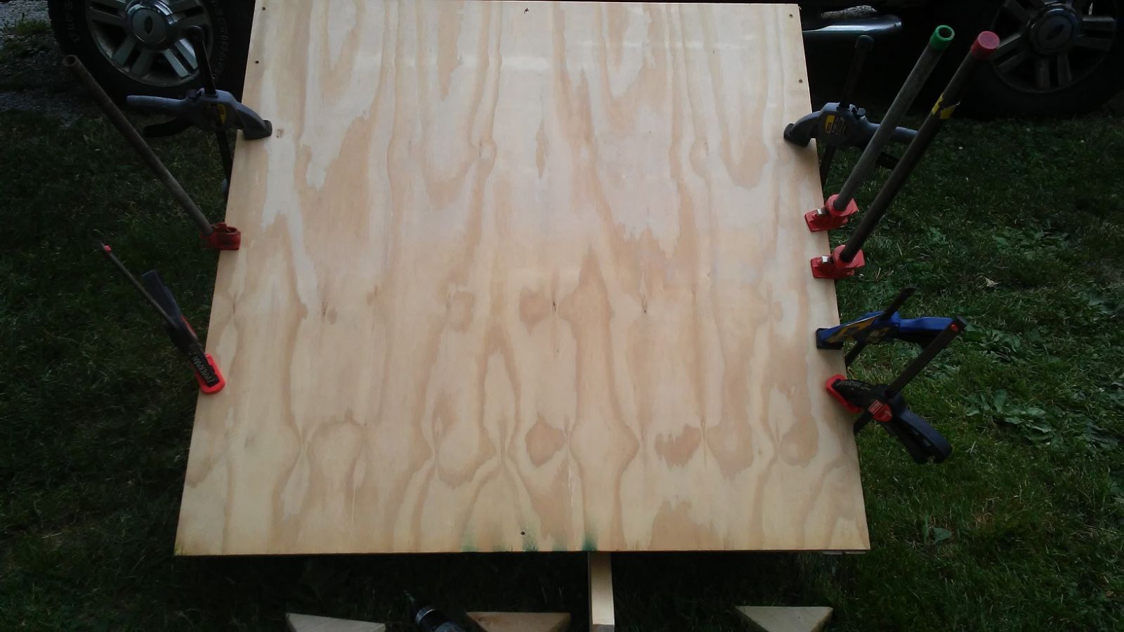

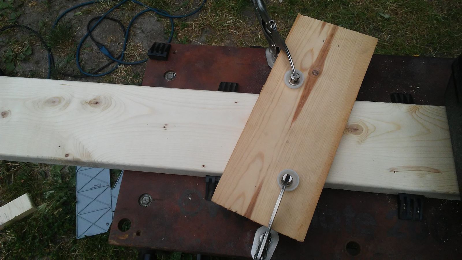

December 11, 20214 yr Popular Post 2020 was well, 2020. Grand-kids attended school/classes from home from late March until late May. After that, almost all normal summer activities were cancelled. The youngest grand-daughter typically would have had both her summer swim season as well as summer league volleyball. All cancelled. Instead, she babysat her two brothers, then in turn, the boys babysat me. Oldest grand-daughter found a pretty good summer job. I think it was to stay away from the chaos. Anyways, about mid June, the new, H.S. Volleyball, 1st year as head coach, contacted the team and recommended they each construct a "re-bounder" to practice various skill-sets. Details would be forth-coming (they never did) She also expected each player to send still pictures as well as videos using said re-bounder. So, between You-tube and Duck-Duck-Go/Google, I located enough information and some sketched plans to build my first (and last) volleyball re-bounder. It was made of wood, it was a project and it was work...ultimately it also did. I took a few pictures. Nothing much to see here. I went a little beefier than most showed using 2x6 vs 2x4. Less bracing needed plus I suspected the grandsons would find their own uses too (they did). I scored a slightly bowed 3/4" x 4x8 sheet of plywood in the discount bin. It was cheaper than a sheet of 1/2' CDX or a "good", pre-cut 3/4" 4x4 piece. I only needed one good 4x4 section anyway. You can see the bow after I split the sheet. Nothing much to see here. My old B&D Workmate (1/3) with my version of hold down clamps. Pretty basic build; 45* on the angles. Hold-downs in use. H-F 8" Drill Press clamps with a 3/4" OD steel bushing to fit the dog holes, couple of 1/2" ID washers with nuts on the underside. Completed carcass. No nails, all exterior screws including the few pocket holes used. After contemplating the use of this plus it would be outside (albeit covered when not in use), I decided if I used enough clamps and some longer screws I could use the bowed plywood section thus saving the good piece for a future project of some sort. Last picture. Had to relocate clamps on each side as I moved down from the top with screws, then finish with a row of screws down the middle. None pulled through nor popped the heads off. I have some pictures (& video) somewhere of her using it we made to "prove"she was working out. It actually worked very well for her needs. Boys ran cars up & down including RC units besides other creative games they came up with. I drew the line though when they attempted to ride their bikes up & over. Thanks for looking. BTW, I disassembled it earlier this fall. I can re-purpose most of it for ???? Plywood sheet flattened out pretty well too.
