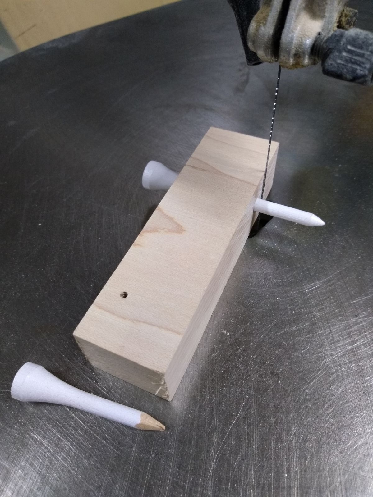

Popular Post Smallpatch Posted December 9, 2021 Popular Post Report Posted December 9, 2021 I've enjoyed puzzles all my life so Am having to shorten the golf tee's for all they had was about a foot long! lew, DuckSoup, Cal and 4 others 7 Quote

Grandpadave52 Posted December 9, 2021 Report Posted December 9, 2021 4 hours ago, Smallpatch said: Am having to shorten the golf tee's for all they had was about a foot long! I ran into the same issue Patch. Bought a bag of the wood ones at Walmart. They had shorter but were plastic. Didn't like those. I've only made the triangle "leave one" Cracker Barrel game. I have a drawing to make the wooden puzzle. It was on the schedule for spring/summer until I got laid up. Maybe next spring. You're going to make some little & big kids pretty happy. DuckSoup, lew, Artie and 1 other 4 Quote
Popular Post Smallpatch Posted December 9, 2021 Author Popular Post Report Posted December 9, 2021 This is my jig to shorten golf tee's so all will be the same length. The sacks of tee's was all they had and there are two different lengths. Also they are easier to sharpen them on the 1 x 42" belt sander. I also used 2 different sizes metric drill bits cause they were different widths.. I was getting too much slop with u.s. standard bits. The block that holds the tee's is 1 1/8" wide. And I forgot to measure the total length after I sharpened them but they can be any length to suit. Terri Littlefield Miller, DuckSoup, lew and 3 others 4 2 Quote

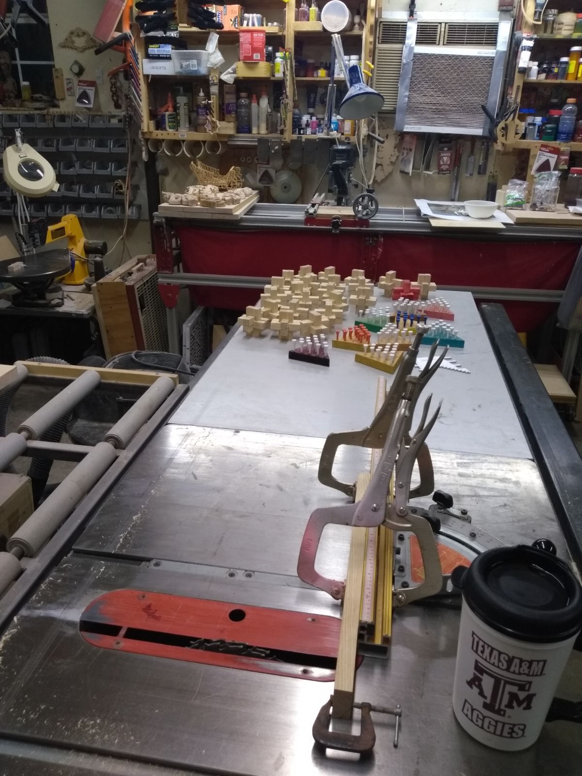

Popular Post Smallpatch Posted December 16, 2021 Author Popular Post Report Posted December 16, 2021 finished puzzles Terri Littlefield Miller, lew, Cal and 3 others 5 1 Quote
Popular Post Grandpadave52 Posted December 16, 2021 Popular Post Report Posted December 16, 2021 Ya did good Santa Patch. Perhaps Mrs. Santa Patch will make you some warm cocoa as a treat. Gerald, lew, Cal and 2 others 3 2 Quote
Popular Post Smallpatch Posted December 16, 2021 Author Popular Post Report Posted December 16, 2021 Thanks Dr. Lew I've always wondered what got caused my blood to boil. So what should I do? I have tried taking my clothes off and running down the road a ways but that just got those folks chasing me! Never could figure out why . That's for both reasons I think. Dave I never thought of cocoa for she is always making me some thing sweet. Last night she made the best peanut brittle I ever did eat. I did get a little sloppy near the end of the the 6 piece woodies. Grandpadave52, Gene Howe, Cal and 2 others 5 Quote
