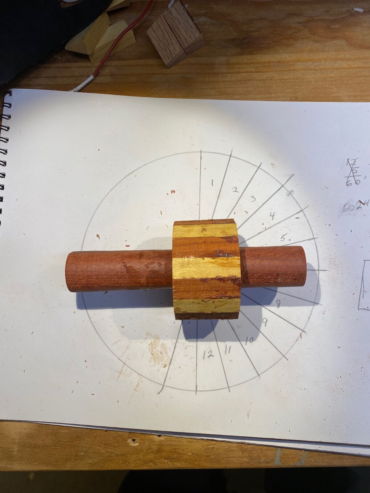

That is very cool Ron. How did you do those angled cuts ?

 I used my DeWalt portable construction saw to cut the angles. I set it up using precision a angle block. That saw has always cut true. I ripped a 15 degree angle on one edge of a board and then cut a 90 to rip it off. Saw  and glue enough of them and WA LA, you get a circle. I used screw clamps to hold it together when I glued and let the lathe true it up.
After glue up
