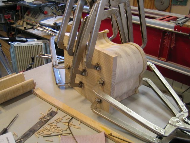

Keeping the boards in line reduces sanding time ending up with more board left to play with.
Plus the pipe clamps gets a lift in the air to help the vise grips work their wonders.

Dave these Vise Grip brand clamps are the V18SP and they are the ones I built these deep drawer scroll saw jewelry boxes with. Each piece had to be glued on one piece at a time and they had to be pulled up tight in all areas for if I left too much glue in one area or a little gap was left I didn't pull together by the time I had finished gluing all the pieces on, that little bulge, would have turned in to a mountain by the time I had finished gluing all the pieces together. I probably use these vise grips clamps more than any other clamps I own. They also sell 22'' models but haven't had a need for them as of yet.228070817_original(1)firastscrollsawbox5bestclampstoglueupthesedeepdraweredjewelryboxesImadesometimeago..jpg.3117012c1878475c01c6fc689da2d562.jpg
Dan they can be bought either way. I grind the head off and replace it with a bolt like in the picture I posted. Originally they were bought mostly by welders. I used the long type without the swivel pad before they started selling them either way.

Gotcha. I thought you had taken standard reach with the movable foot and had extended them with a small thin gauge channel iron.

KevTN  I think I told this long ago but the white material on the inside of the boards that go against the glued boards is from Walmart and its their cutting boards cut up to size. This works better than wax paper I use on lots of glue ups and the dried glue slides off the white stuff.
I use  10x24 nuts and bolts on the vise grip pads.
And if anyone is buying get the 18" with the swivel pads for the holes are already there for some home made long pads.

Dave since you mentioned HF clamps like the Vise Grips, you might better check them out before you leave the store.
  I did check their long clamps to make sure they don't release the pressure after you let the pressure off when you relax your gripe on them and most in the store at that time would not hold at max width
.... All the original Peterson's held pressure at nine inches wide with no problem.
  Most of my Vise Grips are the original Peterson's with that name on them.  One or two of the later vise brand does not hold pressure at max width....
  Most guys do not need to go up to 9 inches wide like I do but I don't build the large scroll saw jewelry boxes so right now I don't worry if they do or don't hold at 9 inch width!!!!
